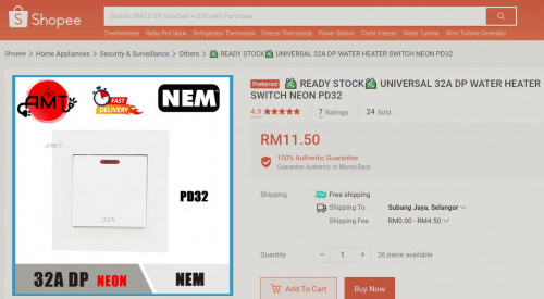

The recommended wiring is 4 mm² or larger. You do know how wire is selected, right? The criteria of voltage drop across the wire, and also the maximum temperature of the wire, at full load?
Oh, by the way.... here's a 32A water heater switch. I guess they are not always 20A after all...
