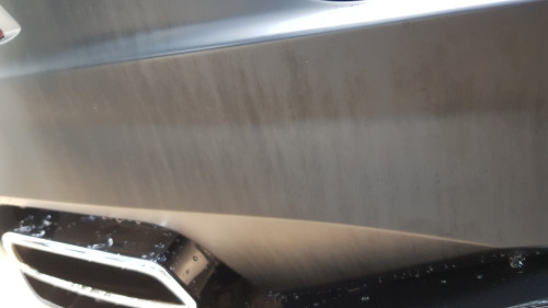

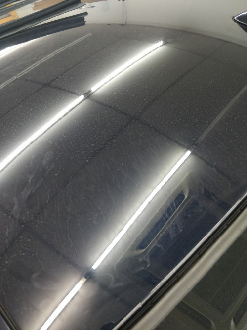

QUOTE(acefreakz @ Mar 8 2016, 11:54 AM)
I have seen car come in nice condition with little swirls and marring. After APC washing a panel, the defects shown up like 'wow wtf', there's some serious masking of defects =P Not sure if this is your case, just sharing hahaha xD
hahaha, not that case. It was not until i drop by osren last week that Henry shine the lights onto the car that i notice it.
I expected some, but that many. drives me crazy.
QUOTE(KrisMas @ Mar 8 2016, 03:23 PM)
Pressure washer works wonders on tyres and wheel wells, but on paint, I don't see much of an advantage unless you do lots of 'off-roading'... biggrin.gif
May I suggest you try using more solution rather than thicker/stronger shampoo mix...soak the panel with some of it before washing and use more soapy water on your wash mitt. And since you've already got the washing part well covered, you might want to look into your drying system/method as well. We all know about 'wash-induced' swirls but don't forget about 'drying-induced' swirls....
Yup, 15 litres is my usual. Will look into the drying part. My current practice is to wet the microfiber tower, mist ONR as drying aid (QD mix) , spread and pull. second wipe down with dry microfiber tower to make sure it's 100% dry. Any dirt or spot will spray more onr and wipe.

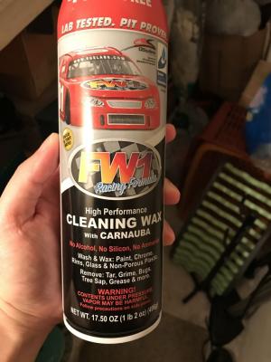

This consider wax or polish?
I can used it to clean my watermark at door handle?

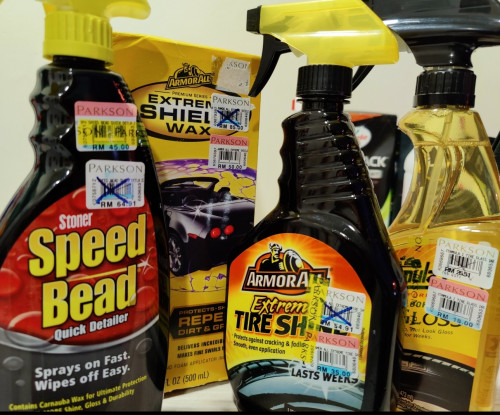

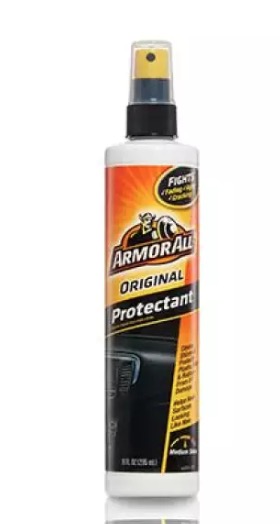

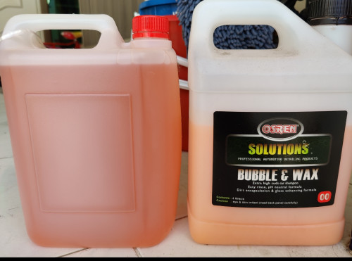

Been using Osren's bubble wash for a week now...washing every two days
Nice smell aside...not sure if it is doing it for me...looks like its leaving behind a thin grey film on my wax...needs a QD follow up...

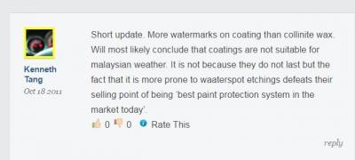

QUOTE(Edlois @ Mar 12 2016, 03:27 PM)
Hi guys I been using turtle was super hard shell for a week the finish was quite good. I have one question does it lasting as their advertise on the label ? Any one has use this ? I know others like meguirs is good but it's too pricy for me
i doubt so. most oversea brands base their test with consideration of their weather, not ours. plus, march is going to be the hottest month this year. hot weather = wax diminishes faster

PG products are quite a steal. Sometimes if you check 11street (rakuten exited Malaysia) they have better deals and discounts than tesco/aeon.
QUOTE(dwRK @ Mar 13 2016, 12:58 PM)
I have a bottle of 4 litres too. Unused yet but looking forward to it.
Any pictures of the thin grey film?

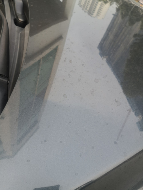

Dear Sifu,

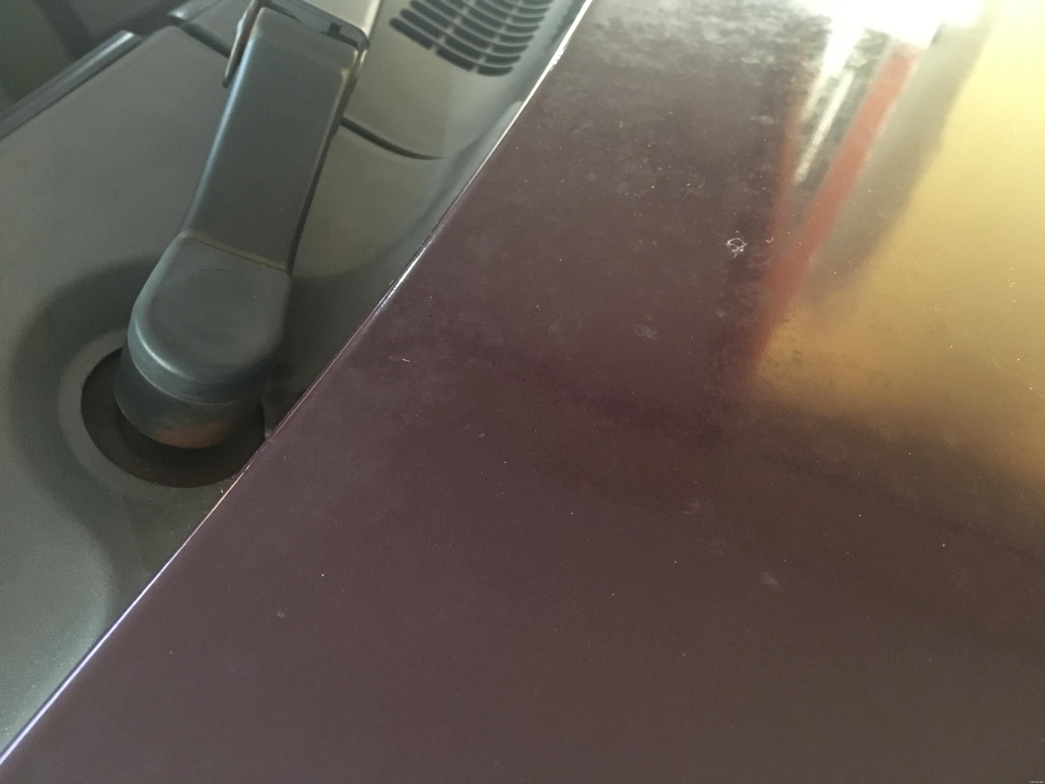

My kelisa black bonnet, left right fender and roof kena simen dropping from nearby condo construction.
Furthermore the stupid worker try to scrap off the dry simen off makin it worse like wiping flour off your black pants..sad.gif
Any advice on the paint job to be done?

sorry to hear that. After trying to remove as much cement as possible by hand, try water stain removal with mf towels. Clay it, de-tar it

try distilled vinegar.

Park at BK5..beside the new condo on progress..so all pls be xtra careful park there.
seems like a million scratch damage with poka dot white on a black paint..

any1 knows whats the estimate cost to repaint back the bonnet, roof, bumper n fender?
2K Super Black 2 color. if possible puchong area pls..

Big panel,ie roof & bonnet usually rm250 to rm350 per panel. Price also identical for bumper. Fender rm 150 to rm 200 for 2k metallic, 2stage paint.
2k means 2 substances mixed (color paint with hardener) to form the paint. 2 stage paint is, base color coat and clear coat. Not sure what you mean by black 2 colors.
In detailing, 2k and 2 stage paints meant different. Almost all automotive paint is 2k . 1k paint will dissolve once solvent such as thinner, mineral spirit is used.This is yr typical can spray, house paint and those automotive touch up paint in small bottles sold in hardware/hypermarket

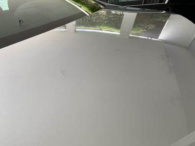

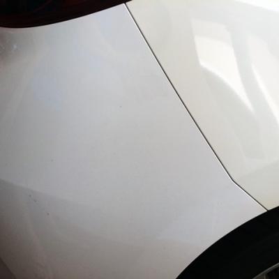

Damn it.. My car just 1 week didn't wash ( White ).. Just now evening washing and notice the front hood the dirt mark / water mark below side mirror was unable to wash away ady.. Shit.. Is it any way to remove the mark other than using polish machine?? Polish by hand is possible?? White car is indeed not easy to maintain huh...

QUOTE(Tech26 @ Mar 19 2016, 11:23 PM)
Polish itself have cleaning capabilities, you don't have to use a machine to have the cleaning effect. Most often polishes in the market are designed to be hand applied instead.
White cars are prone to baked dirt on the clear coat which gives that rather yellow/grey stain (if parked under the sun).
Recommend a Polish n wax method to help prolong that white shine. White cars have to wash regularly.
This post has been edited by linkin182: Mar 20 2016, 12:56 PM

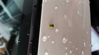

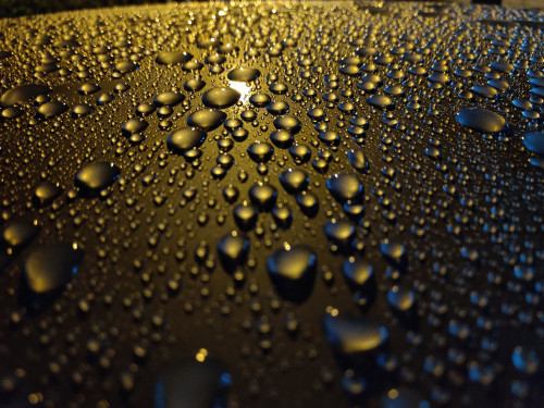

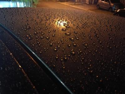

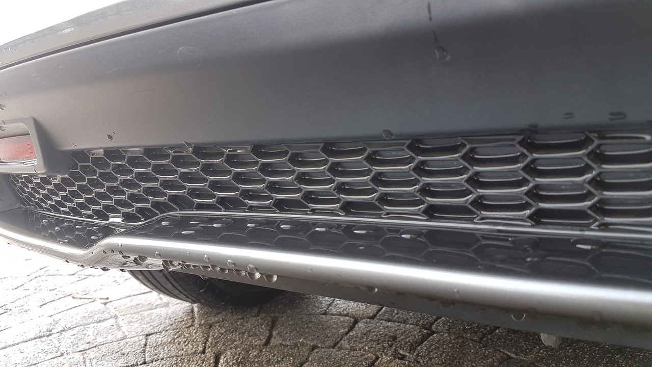

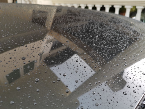

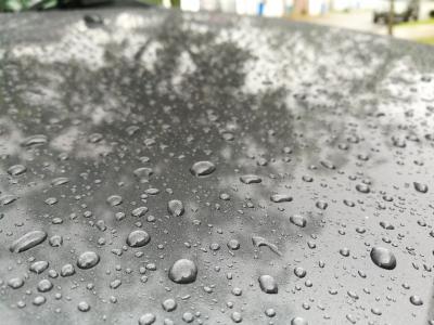

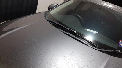

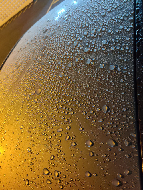

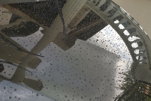

Last week couldn't resist and bought this...Attached Image
Strangest LSP I've ever used...looks and smells like hand cream...as it bonds with the paint...the emulsion breaks down and water is released...eventually soaking the pad...need to periodically squeeze the pad dry!!!
When fresh... beads like wax...sheets like most polymer...adds some gloss...very grippy not slick or smooth at all...will see how long it will last and how easy it is to clean...so far is looking good...could be a sleeper...alternative to PNS?
This post has been edited by dwRK: Mar 21 2016, 04:34 PM

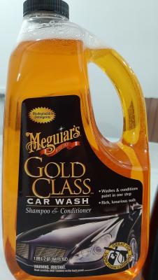

get this

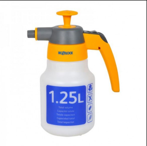

Dear Bryan,
You could actually skip the rinse phase and use an APC (All Purpose Cleaner) as a pre-wash and deliver onto the car using a pump sprayer. So your wash methodology could go something like:
1 - APC pre-soak/wash with pump sprayer
2 - Power wash dirt and pre-soak off the car
3 - Foam cannon attachment on power washer for a nice layer of foam shampoo on the car
4 - Wash mitt wipe down panel by panel, taking care to use a soak bucket for cleaning your wash mitt in between panels
5 - Dry and Spray wax in one step by using your spray wax as a drying-aid
The dilution rates for Meguiar's APC and Optimum Power Clean are quite economical and these APCs can be used for a multitude of tasks based on your dilution.
Greasy engine? 1:1
Rims? 3 : 1
Body panels? 5 : 1
Interior tasks? 10 : 1
All other tasks? 15 : 1
As for your Spray Wax, you could try Optimum Car Wax or Chemical Guys V07
Happy Detailing
-d

Further thoughts on the armorall extreme shield wax...
It's quite expensive...working out to RM 14.5 per car ...in contrast ag's hd wax say at RM 400 per tub is only about RM 8 per car... I don't know if it is going to last twice as long to make it equitable...

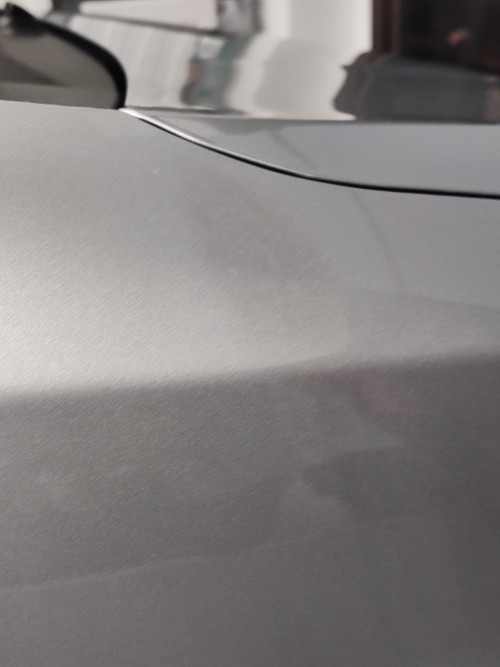

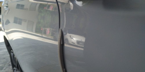

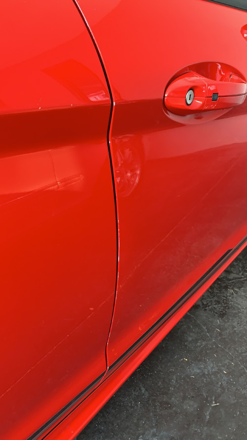

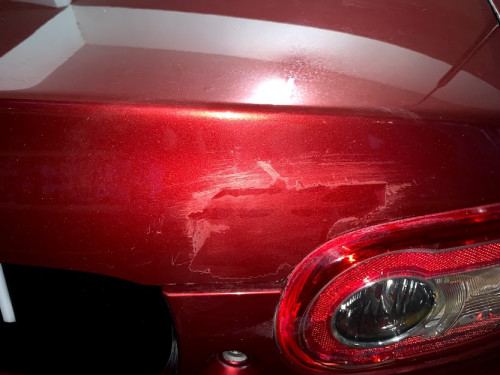

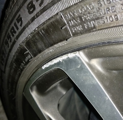

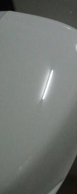

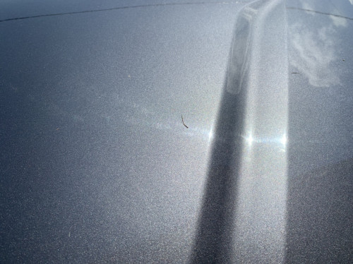

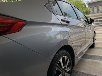

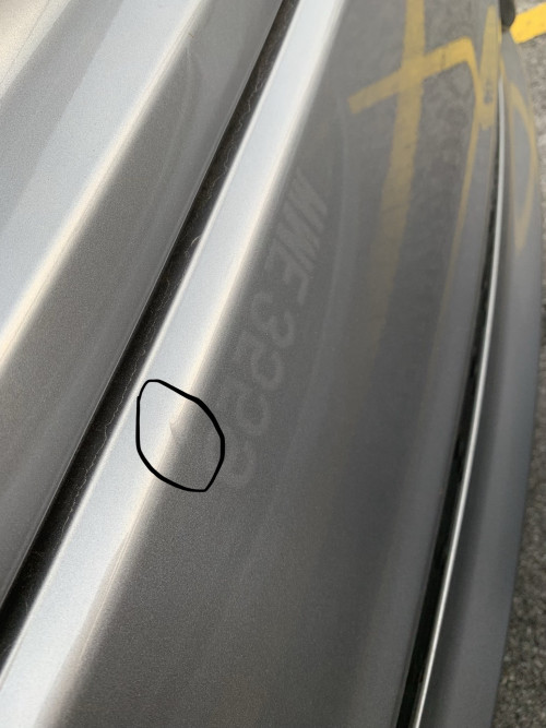

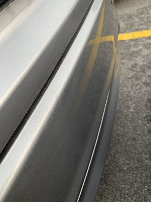

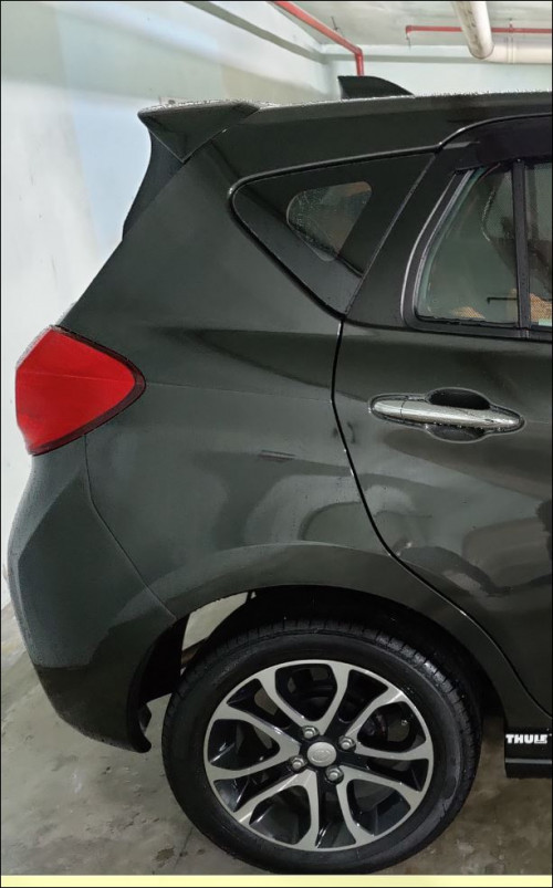

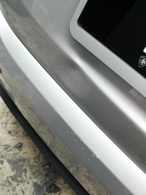

So I have some micro scratches on my side door panel. Its only a month old city sad.gif
So is there anyway to remove this? What are the things I need?
After fixing this i am thinking claying and sealing it with PG sealant.
Also scratches to the rims .....zzz....

QUOTE(alxlimcg @ Mar 24 2016, 11:08 AM)
I also have scratches on my rim..somemore two rims. Can't do anything bout it.
For your door panel, if you dare and know what you are doing, you can do some wetsanding and polish it back . Otherwise bring it to auto detailing shop, they can fix that as I think is only the clearcoat is affected.
This post has been edited by chuckiee: Mar 24 2016, 11:56 AM

Hmm...I was thinking polish would do the job, just not sure which type to use.
Wet Sanding...need to use sandpaper?
I feel you bro.
I saw Youtube, For rim scratches you can fix...if you have the time....sand it then putty it then spray paint(primer/paint/sealant). I am bad with DIY...gotta consider will I do more damage or not. Most likely will let it be
but Sim Tia (Heart Pain)...haha

Based on the picture...it's very light scratch on your body panel...a mild polisher would probably get it done..no need wet sanding.
Regarding your rims....it's tough. It is a plastic based or aluminium based rim? i can't tell from the pic. If aluminium...sanding is required.

Alright. Thanks for the info.
As for the rims. Its Alloy.

Polish would suffice for your body panel.
For the rims, nothing much you can do but a refurb.

lookup chrisfix channel on youtube. That requires dremel tools. But I believe can be achieved with several different sand grad papers as well..just more time consuming

Thanks guys for the and information and replies
Will try to polish out the scratches.
For the Rims .....Ive gotta see if i have time to do that or not.(based on the Chrisfix).

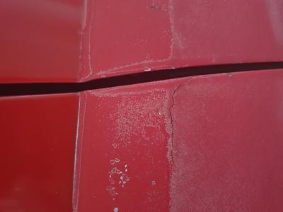

my car is 2013 focus red colour; have been fairly neglected since i have not much time(work shift) only sometime wash her and spray wax a bit. most of time just let some bawah pokok carwash clean the car while im eating at nearby restaurant. so yea, the car is actually full of fine thin swirls.
now i am using meguiar's gold class shampoo and ultimate quik wax, both almost finish now so im looking for replacement; shampoo that perform at economic price and wax that last long biggrin.gif
here is some item that caught my attention so far
1. Shampoo Zymol Natural Concentrate Auto Wash
2. Shampoo 2nd choice Turtle Wax ICE® Car Wash
3. Clay, found this way too good offer on lazada, what sifuu think about this Suspicious Clay Bar
the picture show 3M brand. but would poor clay quality harm the car other than wasting time for not working as intended?
4. degreaser/ paint prepper/ wax stripper; i really wonder if i really need this to prepare the surface. will just claying already strip off all wax or maybe washing using regular dishwashing soap like Sunlight is good enough to start anew?
5. polish/ compounding. i did have a thought of treatment for all swirls, but the idea of using abrasive stuff that actually could actually strip the paint scares me a bit biggrin.gif . is there anything in this category that is newbie safe?
6. sealant; i dont really understand what sealant is or did i correctly put it here in this sequence. is it safe to move on to wax without sealant? teach me sifu tongue.gif
7. wax; feel want to try Turtle Wax ICE® Paste Wax after watching this video
8. claying lube; could i use a fresh diluted mixture of car shampoo i list above as clay lube?
9. what do you guys think of Turtle Wax Rinse Free Wash & Wax? could it also be safe to use as clay lube? i do wonder if it safe to use to remove bird dropping on hot car surface if i keep a diluted solution of it in spray bottle?

Hello fellow detailer, definitely should wash your focus a lot more often yourself safely to reduce all those swirl marks cause by car washes with improper technique!
When it comes to shampoo, you'll really have to consider what sort of qualities you like in a shampoo, foaminess? detergency? lubricity? hand feel? scent? free rinsing? etc etc. The Meguiar's Gold Class is a fantastic shampoo with a great handfeel. Have you tried Meguiar's Hyper Wash? It has fantastic lubricity and handfeel, good detergency against road grime and rinses off easily to boot.
Another great shampoo is Optimum Car Wash. Regardless of which shampoo you decide to pick up, always remember to check the dilution ratios, the higher the dilution - the more economical your wash will be. Dilution ratios are also dependent on the quality of your water, the harder your water - the more you have to use. Also factor in your wash tools such as foam guns or foam cannons (foam guns 100ml shampoo concentrate, foam cannons 50ml)
Clay bars, you should try and pick these up from a reputable seller, but keep in mind that claying your car could potentially cause marring on your paint. It may be a good idea to follow up your claying with a one step polish. Claying your car will also strip off your wax coating but you can always use pour a shot of APC into your foam cannon or foam gun or wash bucket, that will give some degreasing ability to your wash. In this way you can wash and strip off the wax at the same time.
Another and probably more effective way to ensure that wax is stripped off, pour some APC (usually at a dilution of 3 : 1) in a pressure pump sprayer and pre-soak your vehicle and follow up with a thorough wash. Make sure you rinse your car down well as some APCs do not rinse free.
Polishing and compounding all boils down the proper technique. As long as you stick to a DA type tool and also polish and compound products geared towards newcomers, you should A-O-K
Waxes and sealants. In the past the best way to actually protect your car is by using a wax, but these usually don't last long and so they've come up with sealants which last a lot longer than waxes. So you either choose a wax or a sealant to protect your car from the elements. As to which you actually use, that really depends on your car care methodology. How often do you wash your car? How much time do you have when washing? Do you like doing it often or prefer to do it only once in a long while?
If you like washing your car often but don't have much time in your session, I would recommend using a spray wax. After every wash, just use your spray wax as a drying aid along with your microfibre towel / waffle weave, this will give your car the protection that it needs until your next wash which isn't too far away.
If on the other hand if you only prefer washing once in a long while, use a sealant which will last a couple of months. You can always use a wax as a topper on your sealant but ensure that you check with the manufacturer of your products, some products aren't meant to be topped or won't play well with other products.
Use a detail spray for your clay lube or if you are a fan of waterless washes, your waterless wash concentrate properly diluted will also make an excellent clay lube. A shampoo is also possible if it has very good lubricity.
Happy detailing,
-d

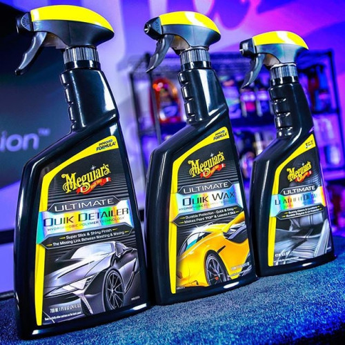

Thanks. smile.gif I'm thinking of getting a bottle of Meguiar's Ultimate Quik Wax. Is it sufficient to protect my car's paint, plastic trim and glass? I understand that spray wax doesn't protect as well as liquid or paste wax. Do I need to apply after every car wash?

It's very important when purchasing products to actually see what your car care methodology is. For example, if you're going to wax once a month, a good spray wax will easily last that duration. However if you're only going to wax once every 6 months, it would be better to look for a good paste wax such as collinite or maybe even a liquid sealant.
Also you have to consider that spray waxes have come a very long way, there are spray type waxes out there that was made to compete directly with paste type waxes. For example, Optimum Car Wax has been claimed to include UV absorbers / protection.
Spray waxes are easily applied and most spray type waxes are very slick which is good - and it stands the reason why detailers the world over love using spray waxes as a type of drying aid. Using a drying aid is also a good idea as it will help prevent the swirl type damage on your car.
So to surmise, methodology and technique is important. Happy detailing!

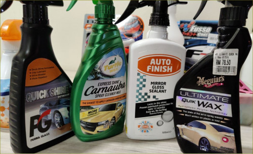

PG sealant is a paste sealant which replaces paste/liquid wax.
Sealants can last longer than wax. This is gotten from information all over the internet.
I don't want to keep waxing my car, thus i plan to use sealant which will last longer with the same benefits of wax.
Most sealants I see cost RM100 at least. PG sealants cost around RM30 and below. The difference in price is quite high.

At a price of RM30 and below, there's no harm trying out the product. Let us know how it works out!

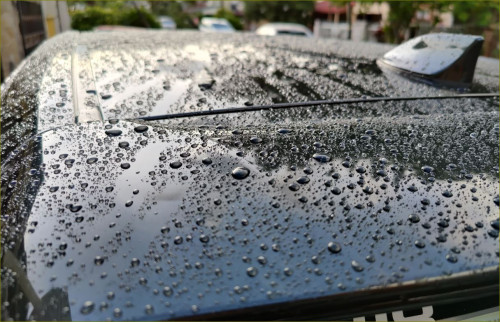

QUOTE(aeiou228 @ Feb 23 2016, 09:01 PM)
Turtle wax ice premium care paste wax (applied on the driver side of the car)
Vs
Sonax xtream brilliant shine detailer spray wax. (Applied on the passenger side of the car)
After 1 month, this is the result.
Water beading on the Turtle wax side is more tighter than the Sonax side.
[attachmentid=6037240][attachmentid=6037241]
After 2 months

QUOTE(aeiou228 @ Mar 30 2016, 05:47 PM)
After 2 months
both look good. Did you do any BSD over ICE? that would be interesting.
When you're done with the test. Can you do a QD or IPA wipe to see which side attracted/embedded more dirt... Thanks.
aeiou228
post Mar 30 2016, 08:40 PM
5,867 posts
Joined: Feb 2006
QUOTE(dwRK @ Mar 30 2016, 08:13 PM)
No I didn't, both ICE and BSD applied directly to the bare paint surface.
I have another car coated with the Sonax Polymer Netshield for the past 2 months. I will share the water beading picture next week for the forum to judge its durability.
This post has been edited by aeiou228: Mar 30 2016, 08:41 PM
dwRK
post Mar 31 2016, 07:51 AM
the consummate chartist
6,230 posts
Joined: Jun 2006
QUOTE(aeiou228 @ Mar 30 2016, 08:40 PM)
Well...these 3 are modern synthetics so should last quite a bit...they have great reputation for beading/durability anyway...
I tested an old wax rain hop vs extreme shield...durability and beading aside the wax attracted more dirt and is less easy to clean...so that was defining
The extreme shield is also tacky/grippy like BSD/PNS...I'm guessing it has comparable formulation and it's my plan to extend it with BSD
if you wish I can give you some extreme shield to test with PNS...
aeiou228
post Mar 31 2016, 07:00 PM
5,867 posts
Joined: Feb 2006
QUOTE(dwRK @ Mar 31 2016, 07:51 AM)
Sonax BSD and TW ICE Paste wax is super sleek and smooth. Can't even place my phone (with TPU back cover) on the hood. Easy to dust off and wipe dry.
Sonax Polymer Netshield on the other hand is tacky/grippy. I don't really like it. I will try to top up a layer of BSD or ICE on my next test and see how it feels.

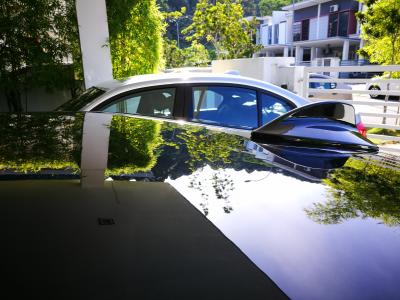

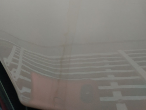

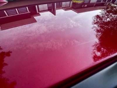

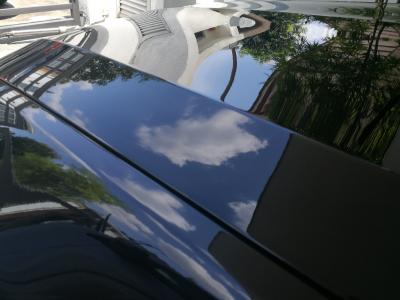

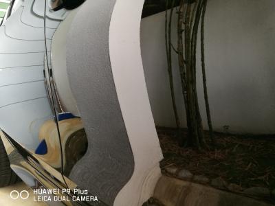

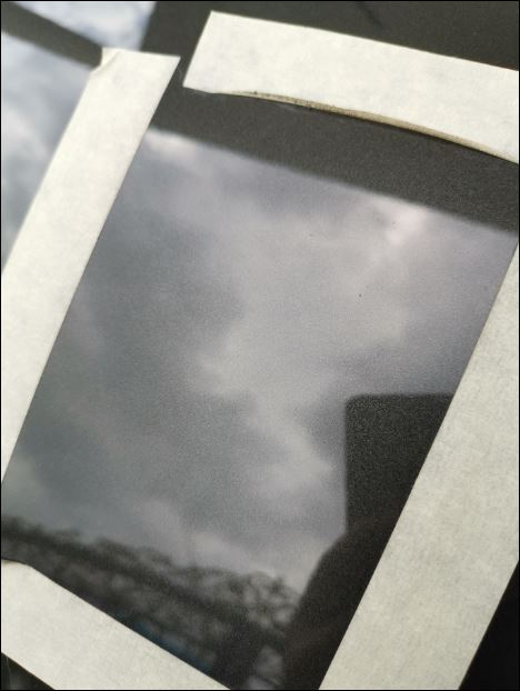

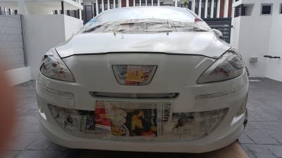

finally manage to get my hands on a rotary buffer.
Below is my attempt at reducing orange peel on a repainted hood with a rotary buffer. Took me 1 hour just for half the hood. Can't continue as its almost 12 am. Better stop before the neighbor starts calling the police biggrin.gif
reflection of a lamp on the hood. Blurry
better reflection after paint correction
50/50, some light smearing which needs to be remove later on
under car park fluorescent light
attempting to shoot inside the car park with outdoor light
another attempt
final attempt before i went for lunch
