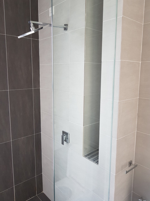

TSkelvintt
post Feb 23 2016, 07:14 PM
174 posts
Joined: Jul 2011
QUOTE(shelby_yong @ Feb 23 2016, 01:10 PM)
if u are hardworking, u can install the fan yourself and water heater..
this 2 is very easy only..
I plan to install ceiling fans myself. My toilets all have wall tiles, not sure I'll break the tiles or not if install myself.
