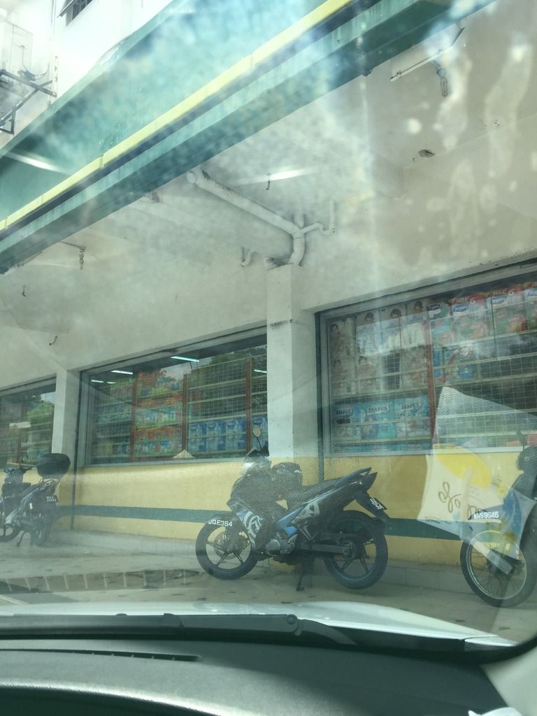

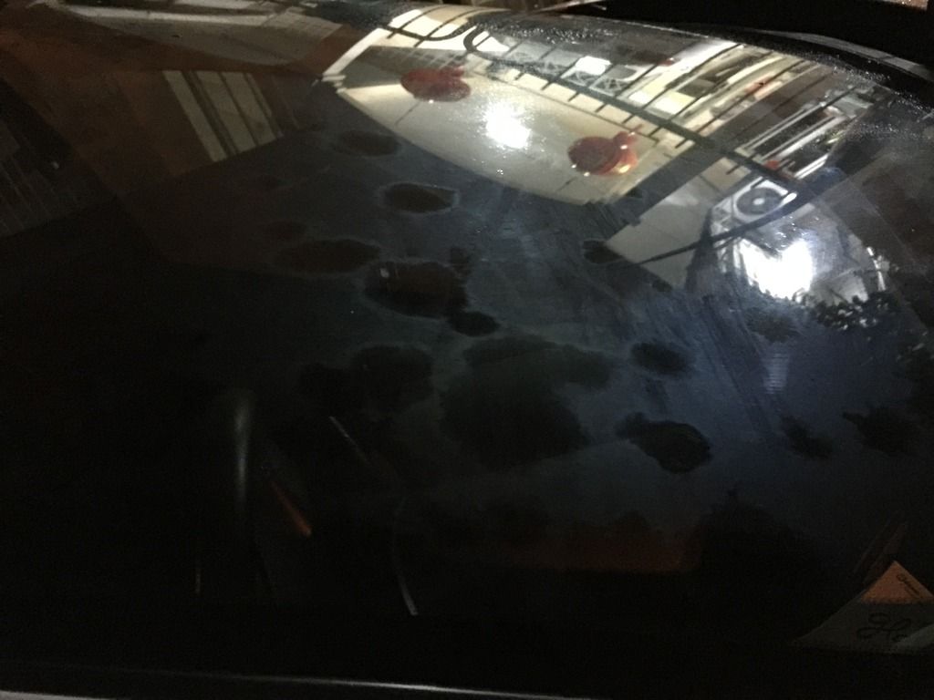

Hello Sifus,
I have purchased a watermark removal from shopping centre last week and DIY to remove the watermarks on windscreeen. I have also applied Rain X after the cleaning.
The windscreen looks fine from outside. But, it is blur (wavy look, e.g. defect film) from inside and affecting my vision.
May I know what caused this? And, how to solve this??
The photo with timestamp at 2100 is taken from inside, the 2059 is taken from outside. The quality is not that good, I will upload the day time photos tomorrow.
This post has been edited by leeweixian88: Feb 9 2016, 09:55 PM

to check if ur windscreen is caused by outside or inside, use a damp cloth to wipe inside, if it is still blurry, that means it is from outside.
outside wise, either ur watermark removal liquid or the rain x u didnt buff off properly. use a clean dry cloth after its been washed n rebuff again.

It works fine with the side mirrors and side windows, except the front windscreen. As far, I have not applied on the rear windscreen. I will upload the photos tomorrow as the photo quality is not good at night.
@lifeless_creature, it is definitely not from internal. It has not issue before using the WM removal. I washed the glass again with car shampoo, and cleaned with WM removal. Unfortunately, it doesn't work.
Let me be the first to cast the stone to gather the ideas that might caused the problem. Would it possible that the windscreen coming with a coating, and the WM removal has damaged it?
P/S: My car is the latest model of Toyota Vios.

No, not because of light refraction. It looks wavy. Horizontal lines across the windscreen. It irritates regardless day time or night time.

I have re-washed the windscreen with car shampoo and WM removal. Not using Rain X this time round. No improvement at all sad.gif

Since it was fine before your watermark removal + rain-X application.
Definitely one or the other is causing the problem.
Improper buffing of Rain-X can cause a hazy appearance, and just washing will not get the excess off.
But I mostly suspect the watermark remover... maybe it has also etched the windscreen glass (don't know how much you applied and how long it was left on)
If that's the case (glass etched) only solution is to change the windscreen to a new one.

I am also highly suspect the WM removal causing the blur. sad.gif That is the worst scenario and I am afraid of - etching windscreen

assuming what you mention is true, then it is not caused by rain x.
if that is the case, your watermark removal product marred your windscreen. good luck polishing it back, it could be even worse.

The acid watermark removal is never meant to be used on the wiper area of the front windscreen as there are scratches and stone chip. The acid will fill into the holes of the scratches and make it blurry. This is not the 1st time happened.
The remedy is to polish put the acid at the scratches by using heavy paint correction compound.
The pro will be using Meguair's m105 or Glass Compound such as Osren or CeriGlass
For Consumer - use the glass compound such as Soft 99 Glass Compound Z which is available at Brother's Kelana Jaya for about RM 30+. If that's too far, you may use Autosol Metal Polisher in toothpaste that is available in any hardware shop or hypermarket. It may cause micro (tiny) scratch, not naked eyes visible but against sun light as it is not meant for glass.
Be prepared to rub and rub (many rounds) to see improvement.
If left uncorrected, the blurriness will disappear after 1/2 year to 1 year time depending on the taken to dilute acid from the scratch. If you cant's wait and want a quick solution and willing to pay, is to sent to the pro detailing shop and the normal charges are between RM 150-RM 250.
Normally, the acid is only used when the glass is heavy stained . Acid is the fastest but not the safest way to clear watermark on windows.
The above are based on actual experience when used a similar acidic product brought at hypermarket.

Went to car saloon for windscreen treatment, tried WM removal and compound, the windscreen still the same. No improvement. The supervisor suspect the Rain X residues had etched the windscreen. Worst case scenario, change a new windscreen. sad.gif

Can you snap a photo from the outside? As in the windscreen condition from the outside.

The dust stain and water stain are off from the windscreen. But, at a closer view, u will notice that the surface is not that even - like the surface of Moon. Suspect that the chemical had marred the windscreen.
The car saloon suspect the Rain X causing the problem as it is a strong chemical. I have a doubt on this as I have been using Rain X for years. The possibility might be the WM removal does not compatible with rain repellant.

Looks fine from the outside though.

Sorry for bring back such a old topic.
But this just happened to me when I applied WM removal just a few days ago.
Dear Sifus,
really need all your expertise, and help.
recently i brought a watermark cleaner online,
so once it arrive, i pun apply la,
spray wipe, repeat.
but when it dried.... (sorry image abit big)
any way to restore it?
anything i can do?
the seller promise to refund, but that small amount aint gonna help much, i just want my windscreen back!
help

I am facing same issue dan problem after I used Watermark Remover.
Previously, some used Meguairs M105 and machine polish off the blurring due to acid. Can also try to use commercial alkaline based cleaner (such as EP Eco- Kleen sold at HomePro at tiles section) to neutralise the acid. The blurness will disappear after months, usually 6 to 12 months if nothing is done.

Guys, here is my advice. I had this issue as well after stupidly applied VAL watermark removal on front windscreen. I could see that terrible white marks/haze under direct sunlight, and during night it was too much of glare against any upcoming lights....
i tried Amway Polish, Meguiar Wax, Dish drops liquids, and so on..
Nothing worked.
The only method which worked for me was... To polish the windscreen using Cerium Oxide powder (you can google or there are some youtube videos).. it is a chemical powder (orange in color) and it is used to remove minor scratches on any glass surface. It is safe, not acid. I did this at a car wash shop in Shah Alam Sek 20. Just need a polisher machine and buff the surface (screen) using cerium oxide powder + water. Must be done in wet condition. Dont let it dry while buffing, add water from time to time.
There is one local company selling this powder (cerium oxide glass polishing powder) online Shopee/FB. Factory is located in Puchong.
Kleenson Glass Powder.
If you buy from China via online, it is much cheaper + more quantity. But you have to wait for shipment.
I did this and my screen is 80 - 90% better now.
