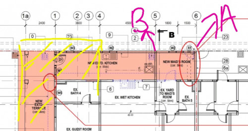

My house extension is as below. The areas I marked with yellow will be double storey extension, the others are not, but will support RC slab. Contractor plan for piling at point A, B and some other points further away. Problem is, neighbour has kitchen extension that is next to point A( he didn't do piling). I am worried piling will cause cracks in my neighbour's wall. Contractor says he will do cantilever from neighbour's footing pad. But I am still worried. Can I get away with not doing piling for point A, only wide footing?

'B' also no guarantee your house or neighbour's house wall wont crack.

Doesnt matter neighbor have kitchen extension or do piling or not ... when you whack that pile in ... KLF your neighbor wall will have crack.
Since its just an extension with rc slab, footing it self is enough, A + B. Number 4 how ? Pile ?
From B to number 4 is around 14'+ which is quite a distance.

Between B and 4, there is another piling point. There is soil settling in the region, as the car porch area also had some tiles issue. So contractor gonna go ahead with piling (with cantilever at point A). I am just praying the damage, if it does occur, will not be major.

Cantilever @ A souldnt be a problem since just a rc slab on top provided not going to be future 2nd floor there.
Piling between B and 4 will effect your neighbor ? depends on pile size, depth and luck.
Have you inform neighbor you gonna do piling ? Cakap dulu (baik baik) inform if there is crack please let you know and you will get contractor to repair and repaint.

Thanks for feedback. Have already discussed with neighbour. Explained that we will fix if any damage occur. Pictures also taken of inside and outside his house before piling.

most probably your contractor using bakau pile and an A frame rig. Else use traditional method with 2 workers jumping on it. I would be more concerned with 1a - 4 as that has double storey. my usual concern is if using bakau and water table is low, it rots easily without water. Expect to have cracks on walls as secondary settlement occurs. Best you take picture of your neighbour's walls (their side) before commencing work to avoid future dispute since you promised to fix damage. FF to 6 is cantilever so most piling would occur at FF.
Edit: if using bakau make sure at least min 3" uniform throughout length. nowadays hard to find 4"

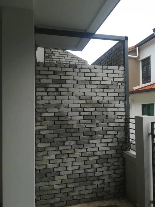

At the back of my house already has a brick wall. My contractor recommend that he can just up the steel frame (similar to this photo) and fill with bricks before top the roof with roof tiles. My size of extension is 22x5ft. Is this advisable over concrete pillar?
utellme
post Oct 15 2021, 03:14 PM
919 posts
Joined: May 2005
5 feet depth length Roof tile is not really heavy. if wall crack is your concerns just ask your contractor install a row of ground beam just below the new wall.
