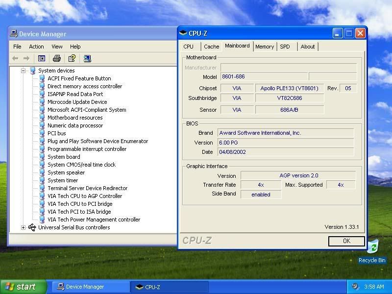

cos now we have some sort of programs to detect the mobo devices
such as cpuz or device identifier
not all motherboards can be identified, those lower grades ones dont have such info. eg
http://img.photobucket.com/albums/v502/beg...28/8601-686.jpg
http://img.photobucket.com/albums/v502/beg...P4M266-8235.jpg

yes it can. depending on versions and brands of the bios, there are certain characters that identifies the manufacturer of the motherboard. hence u can check the manufacturers website for chipset and also specifications of the motherboard that matches that written on the bios ID.
EG.
http://www.abit.com.cn/drivers/mbtype_pic/20060109005.jpg
from the image above
8363-686B-6A6LMA19C-YH
A1 represents abit, so you know the motherboard above is from abit.
8363-686B represents the chipset used by the motherboard
this is a branded motherboard hence making the search easier, if its a jetway or pc partner or soyo, then its a totally different story.
