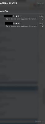

After upgrading Window 10 from 8.1, My WD MyBook Essential USB3.0 2TB seems to constantly connect and disconnect when it is in use, sometime it will even freeze with light on and no longer recognized. I try to update bios and turn off all sort of power saving (USB Power Saving, HDD power saving) but nothing helps, anyone facing similar problems? Google it and realise WD and Seagate both have similar problem with Window 10 and many solution does not solve the issue entirely.
