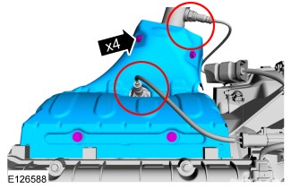

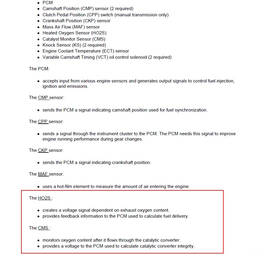

Excerpts from the Ford Fiesta Service Manual
HO2S and CMS, colloquially known as O2 sensors because both monitor O2 levels in the exhaust stream.
Top down view of the our engine exhaust heatshield. The circled one at the manifold is the H02S, the other circled one is the CMS. The catcon is under the heatshield, in between the two sensors
Many cars since the advent of electronic engine management already have two O2 sensors, even the 1st gen vios at my house also have two O2 sensors  laugh.gif  It would be difficult for Fiesta attain Euro 4 emmisions rating with just one O2 sensor at the manifold.
Usually the one at the manifold is called the upstream O2 sensor, where as the one after the catcon is called downstream O2 sensor.
