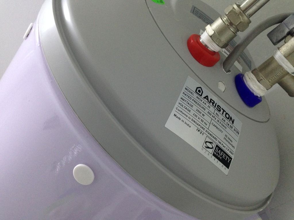

QUOTE(kimsim @ Jul 8 2015, 09:47 PM) Did you never turn off the switch after taken bath? just because a device is switched on, doesnt mean its consuming the max. wattage its rated for. that's a foolish assumption. esp. a storage heater will only work if the temperature has fallen below a certain level. even if you leave the switch on 24/7 you only pay for keeping the water warm which will be way way lower than the above. even if on for 5 hrs, its not 5.8kW * 5 but way way less than that.Even on day time? Water storage tank from 35L & 50L the input watt is around 2800w + 3000L is = 4 units 1.5Hp Aircon runs on day time. 5.8kw x 5 hrs daily good enough to cover your 1hp Aircon for switch on 24hrs usage. 5.8kw x 5 hrs = 29kwh x 30 days just water storage only = 870kwh, please take note just the water storage tank some time never turn off only. |

QUOTE(kimsim @ Jul 9 2015, 11:46 AM) I had forgotted to turn off my water storage tank 25L from 7am to 8pm the extra charge from just turn on power on is around 5 - 8kwh extra sorry but this is not correct and i am sure this was only your assumption not a meassurement. your boiler does not run full force when on until you off. its just not the case. no need to argue about it. install a meter for just the heater and come back.If don't believe just try to leave it from morning till after work and see how many kW from the meter to compare as normally |

QUOTE(kimsim @ Jul 9 2015, 12:28 PM) I guess the different brand should be different work. dont be silly. all storage heaters work the same. they only differ in the quality of insulation and wattage (i.e. how long it takes to get the hot water from zero).Can be keep 30mins to 1hr boiler a once, even keep warm can be cost more, like my friend never turn of sometime and burned the whole storage tank. The power socket are burned ![]() |

QUOTE(kimsim @ Jul 9 2015, 03:01 PM) Anyway I can monitor from morning before I leave home and turn on the water storage tank and after 8pm go back home and clock extra 6-8 kWh, then you just help me to pay my bill other consumer or the worlds least efficient water heater. one more time: water heaters dont continously heat water. pls try to understand how they work. there is no way a normal (i.e. not 1000l) water heater will use 6-8 kWh over say 8 hrs to keep water at 55° or whatever your setting is. especially not in the tropics where the storage has an ambient of approx. 30°. thats just bs.Talk is too simple, cause it one I had monitor b4. Even Aircon 1hp forgot to turn off still clock less than 3kwh only from 7am to 8pm |

QUOTE(kimsim @ Jul 9 2015, 10:49 PM) Water instant heater won't drink the energy lah, just you press the button then heat up only wow you really dont want to understand this it? first of even your calculation is completely useless. 3 boils for 1 hour? come on? who believes that? where got? if you boil like that after one hour the water is gone to steam. pls think first.But water storage tank is different story. Once you power on may cook & boiling the water and keep it warm until temp are drop to be heat up again. Again 2500w = 2.5hp + 1hp Aircon power input watt ![]() Very simple work.. A day from 7am to 8pm in between has 3 time of boiling, on each boiling to be 2.5kwh x 3 times = 7.5kwh.. Maybe you wanna try to understand the work out so this calculation bears absolutely no relevance. others told you already how the heater works. if you refuse to accept this reality i cant help you. believe what you want. some believe in unicorns, some believe their waterheater has 3 boilings a day and each boil uses 2.5kwh. heck some even believe in the flying spaghetti monster. so if it calms you down, believe it. it has however no relation to reality in any way. |
