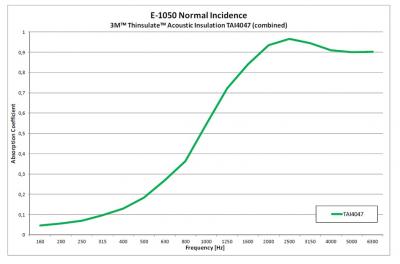

Attached Image Attached Image
Sound absorption performance of the commonly used black colour material (Insuxxx)

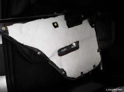

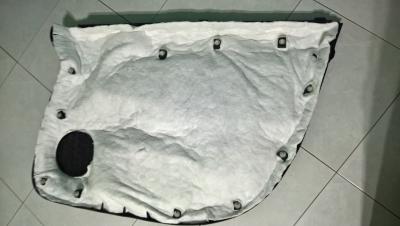

Picture: DIY on my own car (Persona)
Attached ImageAttached Image
Installation on my friend's Car (Myvi)

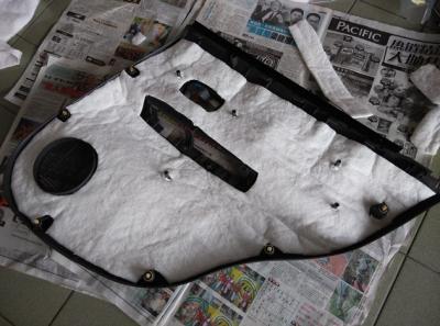

here's a sample pic of my diy door panel. audio sounded better due to less noise from outside.
using thinsulate is a good way to block sound without adding too much weight to the car
