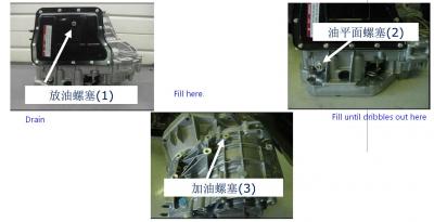

CVT Transmission Service Instruction
https://forum.lowyat.net/index.php?act=Atta...post&id=3808088
credits to: Maxwell6635
CVT Transmission Service ESTIMATED price at Proton Edar Service Center
CVT Fluid [1Liter x 4bottles] = RM40x4 = RM160
CVT filter = RM 235.25
CVT labour charge = RM 60.00
Total: RM 455.25

tysmiracle
post Mar 8 2015, 10:49 PM
1 posts
Joined: Dec 2014
Hai, would Wanna ask if I want to do major service and do CVT fluid change, is it necessary to go bak to proton? (Coz I read on Google, some people say only proton have some special tools to change that) if I don't want go proton, is it okay to go DTOX?
Attached Image Attached Image

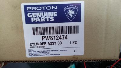

is it difficult to do? at first leaking go change gasket.. now this.. or i may ask the shop to do it for free??
Maxwell6635
post Mar 8 2015, 10:54 PM
952 posts
Joined: Mar 2012
QUOTE(Vincent_A8fm @ Mar 8 2015, 10:49 PM)
U can reset your ecu by yourself. smile.gif Remove ECU Fuse or unplug the battery terminal head.
Vincent_A8fm
post Mar 8 2015, 11:08 PM
179 posts
Joined: Aug 2008
QUOTE(Maxwell6635 @ Mar 8 2015, 10:54 PM)
i have pull out the fuse 15A, plug it back and pull it out again.. then i put it back and start the car.. still same.. rev itself.. so disappointed after today car service - gasket changing..
i told the mechanic, he told me not to worry, it because the oil need to go back to it position.. but morning until now still like this.. shit..
Maxwell6635
post Mar 8 2015, 11:14 PM
952 posts
Joined: Mar 2012
QUOTE(Vincent_A8fm @ Mar 8 2015, 11:08 PM)
Probably not, need to wipe certain data pulling fuse wouldn't do that. But no harm trying. Usually I've seen SC hard connect certain wire to do the reset. Otherwise, also tried use OBD2 to reset. I haven't came to see a shop to do it for free. If you found 1, pls share. Thanks

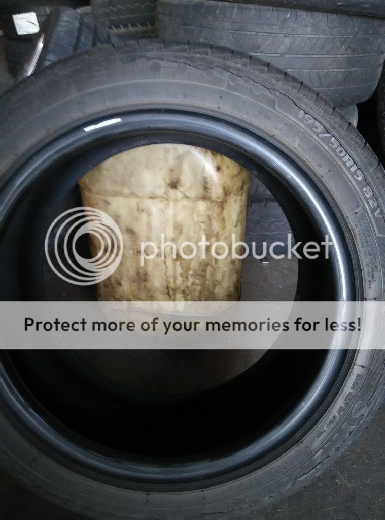

bcbc2308
post Mar 9 2015, 09:45 AM
Joined: Dec 2011
Hi all, i was planing to change my saga flx se tyre from 195/50/15 to 195/55/15,Use back the ori rim, ori absorber and ori spring.
Base on the feedback from the member who changed the tyre the problem is the 55 profile will scrub the mudguard in full turn.
So how about when we doing u-turn on the road? Will it scrub the mudguard as well?
My purpose is reduce the bumpy feel and tyre noise when 4 or 5 ppl in the car. Or just upgrade the suspension and stick back the the 50 profile tyre?
Hope all sifu can gv me some advise, thks...
i told the mechanic, he told me not to worry, it because the oil need to go back to it position[SIZE=7].. but morning until now still like this.. shit..
shocking.gif wad a statement from the mechanic... i think u wont need to visit him again in the future...mechanic from proton SC or other workshop?

QUOTE(TitanRev @ Mar 9 2015, 03:46 PM)
the open the gold colour cover to change the gasket..

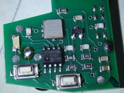

Hi all. My Saga BLM is having alarm issue.
When alarm is set, the alarm will trigger itself.
I checked, no sign of door opening at the dashboard.
And the alarm will just triggered itself after few minutes I locked the car.
And at first I thought is the door sensor, maybe never change before, spoilt and I changed at SC. But then, the situation still remained the same.

QUOTE(justhao @ Mar 9 2015, 11:30 PM)
I have same problem, if u have read Ive also ask in the past few post, I've tried out methods but still keep trigger itself -.- idk what to do also
davidke20
post Mar 10 2015, 08:07 AM
3 posts
Joined: Mar 2012
QUOTE(tysmiracle @ Mar 10 2015, 06:31 AM)
Open the boot, pull the carpet off from the passenger side rear left brake lamp assy area. You'll see 2 computer boxes over there with wiring harness strapped on. Do remember at this point to double check if your car key is in your pocket, do not leave car key in the car. Unplug the boxes(immobilizer and alarm module). Give it a few minute rest and put them back on. By the time you plug in the wiring harness, your alarm should automatically trigger. Use your key to unlock.
Give it a shot. This is your last resolution. If this doesn't solve, good chance is your alarm module short circuit.

QUOTE(bcbc2308 @ Mar 9 2015, 10:45 AM)
doing full turn steering will scrub the mudguard.
u doing full turn when u-turn? then it will.
either :
1) change tyre to yokohama cdrive2 195/50/r15 as drfeelgood rekomen
2) change to 55 profile and avoid doing full turn.
3) add spring bush or change to proride taxi spring then change to 55 profiles and doing full turn without hassle.
This post has been edited by iskazulka: Mar 10 2015, 08:48 AM
tysmiracle
post Mar 10 2015, 11:20 AM
1 posts
Joined: Dec 2014
QUOTE(davidke20 @ Mar 10 2015, 08:07 AM)
Thanks again!! If one of the car key in the car, and then I lock the door will this trigger the alarm too?
davidke20
post Mar 10 2015, 01:08 PM
3 posts
Joined: Mar 2012
QUOTE(tysmiracle @ Mar 10 2015, 11:20 AM)
Everytime you remove/plugback the battery terminal, your alarm module will auto trigger and lock all doors. This is a safety measure as prevent thief from reset your alarm by disconnecting battery. Hence, by default alarm module is programmed to trigger and lock all doors when power supplied.
Taking off the wiring harness is good as disconnecting battery to the alarm module. Remove wiring = no current. Connect wiring = power supplied. Then auto trigger and lock all doors.

QUOTE(iskazulka @ Mar 10 2015, 08:28 AM)
either :
Thks bro~
I'm nt sure for the full turn when u-turn, need to try again. hmm.gif Maybe use in some small road and parking.
Proride spring not only standard and sport? Which one is taxi spring?
The back of the tyre scrub the mudguard is bcoz the body too low not bcoz of tyre too big?
Sorry for the silly question, but I jz want to make sure the solution, bcoz I need to change 4 tyre.icon_question.gif

Taxi spring is another type of spring they talking about which is on blm taxi.
Rear tire run mudguard is because tire is wider or the rim offset to outside. +30 rims at rear will definitely rub the body already one even u n 50 series. I've tried this setup +35 also will rub if you full load at rear and when go over high speed wavy part. What I did was I DIy rolled out my rear fender. Problem solved and with adjustables it was not rubbing. I think with rolled fender maximum the rear u can go is +33 only front 40-35 is good already

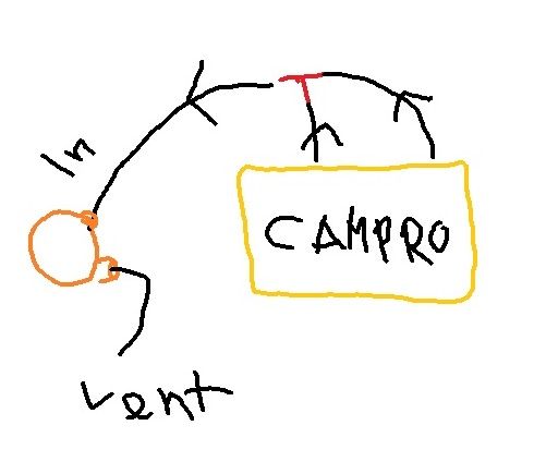

QUOTE(TitanRev @ Mar 11 2015, 01:04 AM)

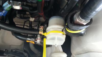

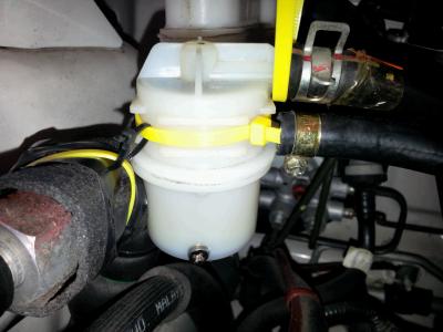

Hi bro, saw ur siggy hence wanted to ask u this; for gaga wanna install oct memang will pasang the 2 hose at the 2 outlets of the rocker cover?
iinm left side is vacuum, right side is connect to totobody right?

QUOTE(Bazinga! @ Mar 11 2015, 12:15 PM)
wat u gonna use? i also looking material to diy oct as well... haha...
Bazinga!
post Mar 11 2015, 12:40 PM
18 posts
Joined: Dec 2013
From: Tempat Havoc Havoc
[quote=r3apers,Mar 11 2015, 12:37 PM]
[/quote]
[/quote]
something like this, test first haha

[quote=Bazinga!,Mar 11 2015, 12:40 PM]
[/quote]
[/quote]
haha... i thinking diy the tank as well...lolx

[quote=r3apers,Mar 11 2015, 12:46 PM]
[/quote]
[/quote]
easy and cheap mah..
just not sure the hose connection only haha.

QUOTE(Bazinga! @ Mar 11 2015, 01:38 PM)
you know?
u wan connect breather or PCV?
QUOTE(r3apers @ Mar 11 2015, 12:37 PM)
Pardon my kindergarten like drawing because I use finger to try on my screen.
1. the 2 outlet from rocker cover I use a T joint and a brass reducer to make this. The right side rocker cover breather hole is bigger than the 1 on left so you will need to different sizes of hose then you will know how to joint them up with the T joint and the reducer. Then I pull a single hose from the 2 joined ones into the OCT and the OCT outlet I just let it vent into atmosphere.
2. How about the hole at the intake pipe and at the intake manifold? I just plug them off with an silicone end cap where you can find in performance shops or spare part shop. cheap stuff only.
Wahla you are done. 1 more thing, make sure you mount your OCT away from the hot engine as far as possible or a place away from heat where the oil an cold down and pleace the OCT lower than your rocker cover so the condensed oil will flow into the tank..my when clean has a lot of oil inside
For your OCT you can use tupperware to make also. drill 2 holes into the side and put 2 male nipper into the tupperware and connect with hose. good tupperware..that can stand oven mia
This post has been edited by TitanRev: Mar 11 2015, 05:31 PM

QUOTE(TitanRev @ Mar 11 2015, 05:24 PM)
how big for the silicon end cap?
TitanRev
post Mar 11 2015, 05:43 PM
9 posts
Joined: Nov 2012
QUOTE(r3apers @ Mar 11 2015, 05:38 PM)
air intake piep side iinm 10-11mm
Intake manifold side very small i cant measure just sumbat the stock hose with a besi
yes, i noticed the different sizes in the 2 outlet when i open and clean tb just now. the right side is slightly oily; dont need loosen clip also hose easily slide out, while left side looks completely dry.
i was thinking if i just connect the oct between right side outlet and intake pipe will it work as well? left side outlet to intake manifold not touched.

Hi I can't seems to find an exact answer on how many liter should I pour atf into my auto saga BLM? Diff mechanic has diff answer .. Some said 4L is sufficient some said 4.xL ... Which should i refer to? Thanks
davidke20
post Mar 15 2015, 10:24 AM
3 posts
Joined: Mar 2012
QUOTE(cheehoong91 @ Mar 15 2015, 09:43 AM)
Nevermind, I get that alot whistling.gif It's on the thread, 2nd post. Don't know where is 2nd post? Here's the link nod.gif

I would like to know if we want to change CVT oil, let bawah pokok mechanic or get back to proton SC fix will better?
I just not sure what procedure will involve during CVT oil changing cause my mechanic dont have pc or relative technology stuff to fix if needed.

Preferably go back sc lor. Cvt cannot suke suke use any oil wan.

As long as the CVT Fluid stated that they are compatible with EZL799A, then can use.
Miller's Oil Millermatic ATF CVT is one of them. Or else, just buy Proton's own fluid. It is Petronas Tutela CVT-NG. Both are fully synthetic.

wankel
post Mar 16 2015, 02:41 AM
Joined: Sep 2014
From: Ingham NQ Australia
My take on the fluid change, translated in Jimmy style by guessing.

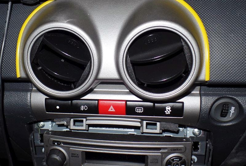

last night i dropped my car key suddenly the alarm still working but no sound.
i tot it just the alarm but this morning i cannot start my car. no crank at all but fuel pump is ok. anyone can help me pleaseee??

QUOTE(sharkz07 @ Mar 16 2015, 09:42 AM)
try use another key first.

post Mar 16 2015, 09:19 AM
45 posts
Joined: Mar 2006
QUOTE(iskazulka @ Mar 16 2015, 08:45 AM)
did you mean no crank = no 'wueekeke' sound?
tak sempat liao nak try another alarm cuz rushing to work lucky can borrow friends car.
is it because of the alarm? yup no cranking sound just sound of fuel pump running

QUOTE(sharkz07 @ Mar 16 2015, 09:19 AM)
Did you try pushing the alarm reset button? The one beside hazard light button

QUOTE(wanfauzan @ Mar 16 2015, 09:37 AM)
yeah i try cranking while pushing the alarm reset button.

QUOTE(sharkz07 @ Mar 16 2015, 10:19 AM)
how to identify which is the problem if not checked the key first. obviously you said earlier you dropped the key. logically that's the culprit. test the other spare key first if it's worked.
iinm my logic is the immo missing when key dropped leading to cannot crank start car. <--- don;t brain me because too much watching air crash investigations.

QUOTE(iskazulka @ Mar 16 2015, 09:43 AM)
will update later when i get back to work this evening. one more thing ar how to unmute back the alarm sound?

sharkz07
post Mar 16 2015, 09:59 AM
45 posts
Joined: Mar 2006
QUOTE(iskazulka @ Mar 16 2015, 09:55 AM)
check the first key if got this chip.
whats that immobilizer ar?
but only last night i drive my car with the same alarm key how come this morning cannot?? vmad.gif
wankel
post Mar 16 2015, 11:07 AM
Joined: Sep 2014
If the chip in the key has moved at all the engine won't crank, it has to be very close to the bottom of the plastic section.

QUOTE(wankel @ Mar 16 2015, 11:07 AM)
what do you mean has moved? means it not stick in the car alarm anymore ke?

QUOTE(sharkz07 @ Mar 16 2015, 11:20 AM)
means whn u drop tht time, the chip might be move around in the key casing, not in original place... u need to slowly open the key casing and check its the immo chop is misaligned or missing..

QUOTE(r3apers @ Mar 16 2015, 11:23 AM)
oh i see. how to open ar just remove the small crew on the cover is it?
ruby1288
post Mar 16 2015, 11:29 AM
10 posts
Joined: Aug 2010
don't u guys know ur key can use both side ?
if alignment is an issue, then when ur immo chip is at top (when u use the other side of yr key), then the car mai cannot start ?
it doesn't matter where or how u put ur chip inside ur key case...
not to mention if u change ur ori keycase to other design, then how ?

QUOTE(sharkz07 @ Mar 16 2015, 11:26 AM)
yes... but slowly open the casing...
QUOTE(ruby1288 @ Mar 16 2015, 11:29 AM)
yes, it will, my car is the sample... my car is not easy to start if u dont know how to tattic start, becoz unable to detect the immo chip... can ask kenjilew he sumtimes also cannot start my car....

QUOTE(sharkz07 @ Mar 16 2015, 12:26 PM)
please read about the effect of losing the immo chip.
http://xes.cx/tag/proton/
QUOTE
They found the source of the problem within minutes. It was my car keys! Apparently, a chip in my transponder fell off. The chip is supposed to deactivate the immobilizer of my car.
Fortunately, I found the chip in the back seat of my car. Phew. I thanked the EON guys profusely. They were a great help.

QUOTE(sharkz07 @ Mar 16 2015, 08:42 AM)
I think ur key chip dah kaput...happened to my friends car before...no crank at all...change the car battery oso same... call proton hotline, & they told my friend to use spare key...and its working fine..

QUOTE(As^Beauty @ Mar 16 2015, 05:51 PM)
Very unlikely, they're pretty rugged.
I had this problem in my first week after I'd opened mine to check what chip type it had, the key is very fussy about the position of the chip.
I've used a bit of double sided tape to hold mine in place as it can slip a bit upstream in the holder, which despite the small movement causes the angst described.

problem solved!
turned out its the alarm that cause the problem.
pheww i thought its the battery lucky me
iskazulka
post Mar 17 2015, 12:01 PM
62 posts
Joined: May 2012
QUOTE(sharkz07 @ Mar 17 2015, 12:44 PM)
problem solved!
which one? the key? immo chip? what happen to it?
u say alarm is subjective.
please explain in details.
This post has been edited by iskazulka: Mar 17 2015, 12:01 PM
sharkz07
post Mar 17 2015, 12:07 PM
45 posts
Joined: Mar 2006
QUOTE(iskazulka @ Mar 17 2015, 12:01 PM)
i think its the immo in the key.
cuz last night i try to start with my spare key and tadaaa no problem at all.
this night i want to open the main alarm key to see whats the prob icon_rolleyes.gif

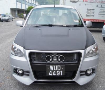

But I can't find any bodykit shop that has this style. That's why I am asking around if anyone knows about this bodykit. sad.gif

Just got back my Flx yesterday. Did the repairs at Proton SC.
Well it was the pump that gave way. Luckily clutch all okay. Damnit... the pump made in China...  mad.gif  vmad.gif
Surely lah the quality like sheet....
Total cost Rm750 +..
Glad you're back. Still, 750 for a clutch pump, we're looking at Inspaliah pricing ady doh.gif Quazacolt?

Yar loh... very unhappy... especially when i saw the box... made in china...
Like wtf...
GETRAG gearbox using china crap.... nabeh...

A sad day for Daisy yesterday, she had a breakage of her dash vent.
I've done a repair that I hope may hold, those curious can read my tale of woe at My Weblog

QUOTE(davidke20 @ Mar 18 2015, 07:24 AM)
I wouldn't worry too much if the factory OEM are endorsed.
I wouldn't worry in the slightest, China can make any quality from the top shelf to junk, depending on how much the trader wants to pay.
China has a space program that actively sends humans into the void too, not many countries do that.

QUOTE(davidke20 @ Mar 18 2015, 10:03 AM)
I saw new addition of bling bling at the vents brows.gif Will it glow in the dark? wub.gif
I named her Daisy so a bit of yellow to go with her pale white body seemed right. It doesn't glow in the dark, but as nice as it sounds it isn't really something you want.
I like pretty things, as I age I like pretty things more and more, I think I may be becoming homosexual in the same way as actor James Franco, up to the point of sexuality, then I'm straight!
