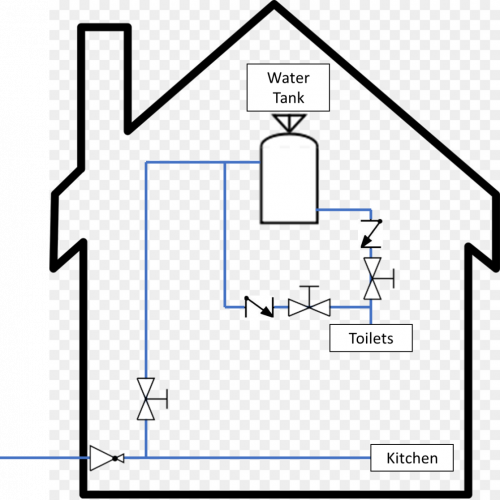

ill put up a diagram for u in a while

ghuzzy
post Feb 10 2015, 09:14 PM
miaw miaw miaw^^
658 posts
Joined: Jan 2009
From: around malaysia^^
here a better outlined diagram
but only one source of supply can be open at a time
if both open, u'll flood ur house

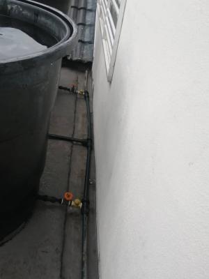

Here is the water tank bypass that my neighbor have done earlier.

QUOTE(dannychen @ May 13 2021, 11:50 PM)
My other place have the same .... done by the previous owner. The downside is during water disruption, the water pressure from the reserve tank takes a long time to to build up.

QUOTE(mini orchard @ May 14 2021, 09:07 AM)
I think it is still safer to do bypass since the main water source are strong enough. My house developer use tank water for the whole house except wet kitchen and dry kitchen which made us suffer for the low water pressure.
