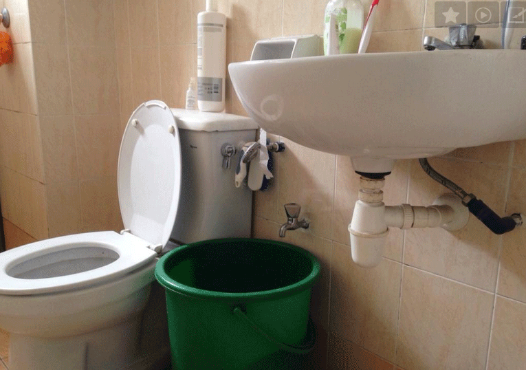

ozak You have any tips of drilling bathroom walls? I just don't wish to accidentally drill on the water pipes..

QUOTE(tzuen @ Jan 20 2015, 03:27 PM)
You got to see the basin, toilet bow inlet the pipe height to know where the pipe run. It is hard to explain for me.
Take a picture of your bathroom and post here. I try to check it out.

tzuen
post Jan 20 2015, 03:53 PM
430 posts
Joined: Nov 2006
From: Peekaboo
QUOTE(ozak @ Jan 20 2015, 03:39 PM)
Here's the photo of my bathroom.

ozak
post Jan 20 2015, 04:01 PM
10k Club
17,021 posts
Joined: Jan 2005
QUOTE(tzuen @ Jan 20 2015, 03:53 PM)
Most probably your pipe will run in this way.

tzuen
post Jan 20 2015, 04:11 PM
430 posts
Joined: Nov 2006
From: Peekaboo
QUOTE(ozak @ Jan 20 2015, 04:01 PM)
Appreciate that!
I assume the sound of the drill will be sound different, when the drill start contacting the metal blush.gif
This post has been edited by tzuen: Jan 20 2015, 04:13 PM
ozak
post Jan 20 2015, 04:15 PM
10k Club
17,021 posts
Joined: Jan 2005
QUOTE(tzuen @ Jan 20 2015, 04:11 PM)
Appreciate that!
You mean your pipe?

tzuen
post Jan 20 2015, 04:19 PM
430 posts
Joined: Nov 2006
From: Peekaboo
QUOTE(ozak @ Jan 20 2015, 04:15 PM)
You mean your pipe?
Yeah.. There's another toilet next to the corridor. Not sure where's the main pipe distributing the water.

ozak
post Jan 20 2015, 04:24 PM
10k Club
17,021 posts
Joined: Jan 2005
QUOTE(tzuen @ Jan 20 2015, 04:19 PM)
Your toilet piping is using PVC pipe. So you can't hear anything beside your drill sound.
TSavanray
post Jan 20 2015, 04:26 PM
124 posts
Joined: May 2009
QUOTE(ozak @ Jan 20 2015, 04:24 PM)
where usually they put the main pipe from the tank? at the shower head?
tzuen
post Jan 20 2015, 04:28 PM
430 posts
Joined: Nov 2006
From: Peekaboo
You are right. Most of the new development housing/ condos are no longer using metal pipes. Will hear nothing till the water start gushing out blush.gif
ozak
post Jan 20 2015, 04:30 PM
10k Club
17,021 posts
Joined: Jan 2005
QUOTE(avanray @ Jan 20 2015, 04:26 PM)
If you see the stopcock on top, that is the main pipe from the tank.

QUOTE(ozak @ Jan 20 2015, 04:30 PM)
lol..meaning i have to peak through from the ceiling..tq2..alot of good infos from sifus. how bout electrical wiring?any general tips/rule of thumb to avoid it?

QUOTE(avanray @ Jan 20 2015, 04:33 PM)
No need peak thru the ceiling la. Mostly can see inside your bathroom already.
