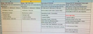

I made a comparison spreadsheet based on the links that you have provided me. I must admit I am not sure what are the factors I should take into account when choosing the hood. Appreciate experts advice here on this.
Thanks so much.

first you need to decide if you can install a vented hood. this would be more efficient than recirculating types
recirculating types needs to change charcoal filter.
try to fit in a 900mm hood as this size is more common to find. a 900mm hood matches a 600mm hob better. its only 150mm more on each side.

I would suggest you "B" because of ventilation type and more powerful suction power.

Thanks, I was considering the same but looks like Electrolux comes with more feature as well.

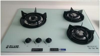

Hi all,
What about gas hobs? Factors that determines my choices will be:
1. Price
2. Aesthetics
3. Quality
4. Size : 70 cm - 75 cm
5. After sales-service
Appreciate your tips and guidance.

If you aren't doing asian style cooking as in wok hei, you may consider either induction or vitroceramic as both types have 60cm models.
For gas hobs, the spacing between the hobs will largely depend on the size of wok & other utensils for cooking as some people prefer to fry food and make soup at the same time. If you prefer gas hob and doing light cooking, go for the smallest 2 hob type.
Since you are going for a rinnai hood then you might as well get their hob as well.
http://www.xammax.my/cooking/hobs/gas-hobs?brands=19

Bro, the smallest gas hob by electrolux is 76cm and it's also 2 burners.
http://m.electrolux.com.my/Products/Kitche...s_Hobs/EHG7322X
Like idoblu mention just now, domino hobs are also small and can buy 2 of them to place side by side. About 30cm per domino hob.
Elelctrolux domino hob is also 30cm.
http://m.electrolux.com.my/Products/Kitche...Hobs/EGG3322NOX
Can try checking out ariston malaysia to see if they have 2 burner gas hob in the size you need?
Nowadays 600 size gas hobs are almost non existence. If TS insist on a 600 hood, then a domino hob might fit nicely but the higher cost... tongue.gif
The hood should be slightly bigger than the hob or at least the same size. I haven't seen one installed the opposite way...yet

Yes, hood is also Teka but I bought separately at Teka warehouse sale. 1200m3/hr for only RM700. I don't have any idea what the retail price was. I really didn't have much choice for the hob then, saw something that I like in a KC showroom. The staff helped me to order something similar after choosing from a catalogue. Interested also on the 60cm hood that can be nicely hidden in the cabinet but suction was too low.
My hob looks almost like this.
My Webpage

Hi all,
I sort of done shortlisting for my hood. Almost at the final stage of shortlisting for hobs - After an exhaustive search, I finally found that Fisher & Paykel has 2 models of 60 cm gas hobs which I really liked (saw them in their main website ; https://www.fisherpaykel.com/nz/kitchen/coo...ps/CG603DNGGB1/ and https://www.fisherpaykel.com/nz/kitchen/coo...s/CG603DNGGB1/) .... One with 4 burners and the other one has 3.
However these models are not listed in their Asia site. F & P Asia site only carries this model: https://www.fisherpaykel.com/asia/kitchen/c...ps/CG604DWFCX1/
Do you think I can request the model that I like?
Would love to hear from anyone here who have used F & P - quality, price, where to purchase, etc.
Thanks.

More update... Teka Malaysia replied me on the hood few minutes ago. Please click on the link to view the model and the only have this under the 60 cm category:
http://teka.com.my/my/products/view/13039-hoods-tl1_62 and they quoted the price as RM 750.
I have Rinnai, Electrolux and now Teka in my hood shortlist. What do you guys think in terms of price and features? Appreciate your input. Thanks.

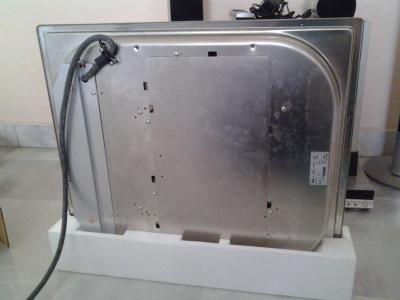

See attached picture.
Model is TEKA VTCM. It is a vitroceramic hob. Got it from www.xammax.com.my
Prices is lower than the fair prices & selling prices. Last year I saw the exact model at homedec fair selling for 2k+

Check this stove out.
This gas on glass hob is 68cm. I think is smallest already?
But it is from singapore, so not sure if Ellane brand is available in malaysia though.
How is your search for that 60cm stove?

QUOTE(S'aimer @ Nov 9 2014, 04:09 PM)
--->Thanks for the follow up note and the suggestion for Ellane brand. I did come across this few weeks ago but it is not available in Malaysia. My attention has now diverted a bit towards induction hob (stretching my budget a little bit and will probably compromise a little bit in other areas). With space being a constraint in my apartment, I feel induction will be a better choice as I could save up the whole space I would need to allocate for gas cylinder if I buy one). My long thought process includes the budget, my usage frequency, the type of cooking, pros and cons of induction hobs etc before I decided to consider an electric hob. Above all, forumers inputs have been extremely helpful to have a focused search and informed decision making process. Gas hob is there in the back of my mind as a plan B if my budget balloons up (just incase)!

TSCareer26
post Nov 9 2014, 06:14 PM
281 posts
Joined: Dec 2010
Shortlisted 60 cm hoods and 60 cm induction hobs and you may click on each to view the models:
HOOD (Brands and Model Nos.)
1. Rinnai - RH-T306-SSV
2. Rinnai - RH-T316-SSV
3. Electrolux - EFT6510X
4. Teka - TL 162
INDUCTION HOB (Brands and Model Nos.)
1. Teka - IR 641
2. Rinnai - RB 6004H-CB
3. Electrolux - 3 Models comparison (EHEC65BS, EHET66CS, EHED63CS)
S'aimer

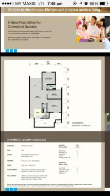

ozak
post Nov 12 2014, 11:06 AM
10k Club
17,018 posts
Joined: Jan 2005
QUOTE(Career26 @ Nov 12 2014, 07:52 AM)
Hi there,
Thanks again. Got your message while having my breakfast. Thought I will post part of the brochure snapshot which I had it in my phone. Please refer to the Electrical installation details mentioned.
Base on your plan, it missing some heater and aircon point. You only have 5 socket point which hall, dining and 3 room each. So it look like normal apartment with 32A DB for main.
If you plan to have aircon, heater, cooker, hood, washing machine etc, somehow you need to hack and add. No choice for you.
So plan ahead how you want your wiring done.
TSCareer26
post Nov 12 2014, 11:46 AM
281 posts
Joined: Dec 2010
QUOTE(ozak @ Nov 12 2014, 11:06 AM)
---> I am not sure why they are not mentioned in the brochure - but during my inspection at the unit after collecting the key, I saw they do have water heater and aircond points.
Aircond points ( living and 3 bedrooms)
Water heater (2 bathrooms)
Washing machine is to be placed at the yard. Nevertheless, I will get my electrician to do a sanity check as pointed out by another forum friend here. Thanks smile.gif
This post has been edited by Career26: Nov 12 2014, 11:47 AM

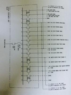

TSCareer26
post Nov 12 2014, 09:48 PM
281 posts
Joined: Dec 2010
Friends,
I managed to get a snapshot of Electrical installation layouts from my home owner's manual. For all those poured their inputs based on various assumption, I hope the shots are clear enough for you to study the layout and advise me accordingly. Thanks guys smile.gif
S'aimer
post Nov 12 2014, 11:23 PM
637 posts
Joined: Jul 2010
From: West Malaysia
Looks like you have 63A for your DB (can the others confirm this too?)
Based on your electrical layout, you do have electrical points for aircons, heater (20A gang switch, but no 15A switch socket faceplate because the aircons and heaters have their plugs for 15A switch sockets while the 20A gang switch is like a relay to turn on the aircon or heater)

halcyon27
post Nov 13 2014, 04:03 PM
2,140 posts
Joined: Nov 2010
Looks like it too. That's good. Career26, it looks like last two slots are spare 20A. If you can, take a photo of your DB box with the fuse clearly shown and post it here so we can see and compare that with the DB box layout plan.
ozak
post Nov 13 2014, 05:33 PM
10k Club
17,018 posts
Joined: Jan 2005
From the plan, you still have to tarik a 4mm wire to the kitchen if you want to install a cooker and hob. And a 32A MB. The easy way less hacking is go through the top if you plan to plaster ceiling. Just hack the DB box wall and the cooker place wall to conceal the wire.
Your B/5 2socket probably need for fridge and others. While the B/4 2socket is probably for WM (yard) and you can't share with cooker anymore. Both wire are 2.5mm size.
S'aimer
post Nov 13 2014, 06:29 PM
637 posts
Joined: Jul 2010
From: West Malaysia
Isn't a 10mm better?
QUOTE(ozak @ Nov 13 2014, 06:33 PM)
ozak
post Nov 13 2014, 06:38 PM
10k Club
17,018 posts
Joined: Jan 2005
QUOTE(S'aimer @ Nov 13 2014, 06:29 PM)
What is the cooker wattage TS using?
S'aimer
post Nov 13 2014, 07:17 PM
637 posts
Joined: Jul 2010
From: West Malaysia
She haven't decided yet. Still considering between a 2 zone and a 3 zone or 4 zone induction hob at the moment.
But I assume that, cooking hob, hood will need dedicated wiring and if not a built in oven, there is a possibility of a table top microwave or microwave with convectional function in future???
QUOTE(ozak @ Nov 13 2014, 07:38 PM)
ozak
post Nov 13 2014, 07:50 PM
10k Club
17,018 posts
Joined: Jan 2005
QUOTE(S'aimer @ Nov 13 2014, 07:17 PM)
You only can have hood and hob on the dedicate wiring. Can't have other appliance and share.
Still got 3 wall socket. Use that 3 for other applicance.
4mm size can use max 4800w.
S'aimer
post Nov 13 2014, 08:28 PM
637 posts
Joined: Jul 2010
From: West Malaysia
That i know on the no sharing part.
Only thing is.. A 2 zone hob is 4800W while a 3 and 4 zone can be anywhere between 6000-800W for nominal rating.
That's why I ask if 10mm is best although 6mm might be good enough?
QUOTE(ozak @ Nov 13 2014, 08:50 PM)
TSCareer26

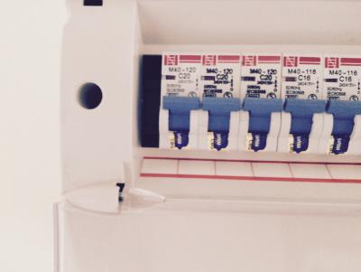

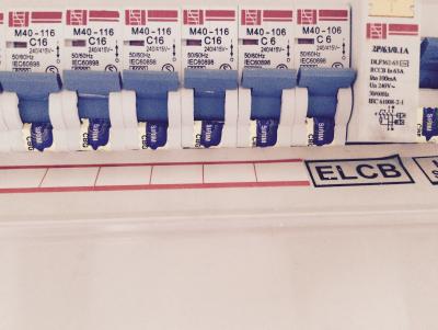

QUOTE(halcyon27 @ Nov 13 2014, 04:03 PM)
Sure halcyon27. Will be visiting the apartment unit to meet with some contractors on this Saturday. I will take a photo of the DB while I am there, and post it here.

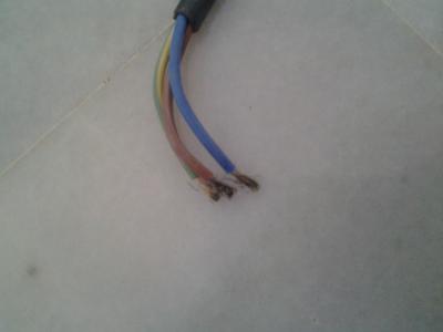

For my old hob, it was vertically installed. Looks nicer?. It seems that the wire behind my old hob is either at the side or the top so it depends on which side is it for the switch location.
I show you a pic of my current hob wire at the back.
You see the wire at the back of my hob? It's on the right side at the back, the front right side is where the knobs are. So the location of the switch and dedicated wiring needs to be on the right for me initially. However because the wire is behind the hob, so when install the hob, the wire will have to be fitted with a 15A plug and then plugged into the socket switch underneath the countertop.
It can be quite troublesome if you have to bend down and turn on the switch everyday.. In my case, it was a cocked up problem by the tiling contractor who did my counter top as his workers covered one of the empty socket outlet with one of the leg support. Had to ask my electrician to work out the socket position and wiring issue due to this.
Which is why I said you need to know the location of your hob's wire before deciding on the switch location.
I think you can get them to reserve if new stock confirm to arrive & you put deposit?
QUOTE(Career26 @ Nov 14 2014, 08:43 PM)
Attached Image Attached Image
This post has been edited by S'aimer: Nov 14 2014, 09:09 PM
ozak
post Nov 14 2014, 09:26 PM
10k Club
17,018 posts
Joined: Jan 2005
QUOTE(S'aimer @ Nov 14 2014, 08:36 PM)
Ask idoblu how to do the switch direct wiring. Place the switch as you like.

I did not manage to get an electrician during my visit to my unit on Saturday. He did not turn up. sad.gif
However I manage to take photos of the DB as some of you requested earlier.
So for discussion sake, let's say I will be getting the following hood and hob:
1. Hob - Electrolux -http://www.electrolux.com.my/Products/Kitchen/Hobs/Induction_Hobs/EEH353C
2. Hood - Teka - http://www.teka.com/id/products/view/12917-hoods-tl1_62
I will be installing the modular hob horizontally as I mentioned in my previous post.
Now that the DB pics are up (hope they are clear enough for you guys to look at the technical information in order to advice me accordingly.
What do I need to ask the electrician if I want these both to be installed bearing in mind there should not be any nuisance trips?
Thanks.

Cool ur MCB all C16?
I guess you after install all the water heater & Aircon would be some turn into red one, even fridge.

Your DB box is not a problem. Can install additional or change the MCB.
What you need to do is decide your fridge, hood and hob or oven model first. Than go to kitchen design to design your kitchen. Once all this is done, you can clearly see where you want to place your switch and light. With the technical data that some forumner here suggest, than you can call the electrician come and quote.

QUOTE(kimsim @ Nov 17 2014, 06:52 AM)
---> Could you please explain that? I have no clue what you are saying and why you are asking if the MCB - all are C16. I am no expert in this electrical stuff and you will know that if you had read the thread from the beginning. rclxub.gif

QUOTE(Career26 @ Nov 17 2014, 10:14 PM)
kimsim is referring to the circuit breaker. It's 16 amperes (16A) which means it will distribute electrical current to the end points up to 16A before breaking the circuit. Overcurrent greater than it's rated Amperage can burn the wires and cause an electrical fire.
Going by traditional 240V, 16A will admit up to 240x16=3840W. At 230V, then 3680W.
Lighting and fans usually 6A but I've seen it go up to 10A in certain properties.
Socket point for appliances normally rated at 13A. Some points that share sometimes allow for 15-16A relying on the fuse at the appliance socket to protect overcurrent.
Kitchen by right should use 15A if sharing between fridge and toaster microwave. Some owners prefer dedicated ones to prevent nuisance trip on the circuit.
1HP AC and oven usually 15A. Water heater and 1.5-2.5hp AC usually 20A. Washing machine with dryer sometimes 20A as well but dryer alone 15A although newer ones uses 10A-13A.
The main distribution circuit coming in to the residential dwelling is either 32A or 63A (1 phase) or 100A (3phase). There are uncommon ones as well esp for larger requirements like offices also.
The overloading is what causes tripping but this is a safety characteristic of the circuit breaker to prevent overcurrent that causes electrical fire.
