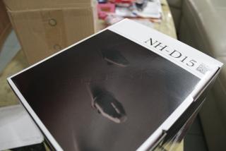

This is the box appeared in my living room table when i got back to home
I couldn't describe how happy am i when i see the "NH-D15".I've asked everywhere, lowyat plaza, goes to singapore and they have no stock for this. I had to use stock cooler for few weeks, almost few month, or they aren't going to carry noctua products.
So this is the packaging of NH-D15

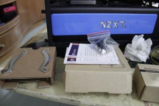

Let's take a look around its components first.
Attached Image Attached Image
These are the components that I'm going to use so the AMD mounting isn't here.
The mounting kit includes a paper box that acts like motherboard and a plastic bag of screws. 4 screws is required and another 4 screw is for LGA2011 mounting.
The backplate is metal now instead of arcylic in NH-D14 and it's much more beautiful wub.gif
The accesseries box contains all kind of wire like low noise adapter, which limits the Max RPM, PWM of fans from 1500RPM to 1200RPM, clips for secondary fan, Noctua famous thermal compound, and a very high quality L shape screw driver. The screw driver is the best screw driver in my house, true stainless steel and extremely durable.

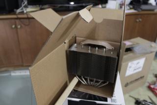

The paper box of NH-D15, as you can see, it is more than one layer.
Have a sneak peak at Noctua's famous ultra flat cooler base.
Unbox the heatsink!
Even the empty spaces inside the paper box are well-filled. The design is to make user to take out the cooler easier without damaging the fins. (Actually those fins could damage your skin). To open the box, open it up from the top from 4 sides, so the top actually have 4 layers.
Every empty spaces is filled, even the space between the radiators.
Remove the box

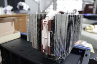

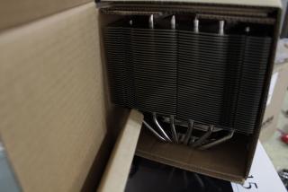

The NH D15's fin now hooks each other for durability and seals the airflow.
The heatpipes is widened to pair with bigger fan.
I personally don't like this design. I prefer maximum cooling perfomance than doing compability with those pointless (don't kill me) tall, high perfomance rams. Without those complains to Noctua, they wouldn't do this design, that should increase the cooling perfomance.
The heatpipe height is adjusted, because the outer heatpipe should be the longest which decreases the efficiency of heatpipe, so they shorten it. Another reason is the fan doesn't cover the outer heatpipes.
The Noctua Logo and the perfect soldering quality between heatpipe and aluminium fins.

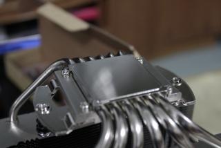

The bottom copper base is covered with a hard plastics, the plastic is solid and thick
The photoes is taken with different focus point so you can see every detail of the bottom copper base. It is very flat and isn't mirror finished. According to the website, the base with this kind of finish is designed to pair with high end thermal compound because they have very high density, would fill into the surface.
The front view of the copper base, its extremely flat

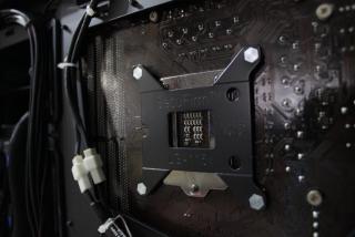

After the removal of intel stock cooler and thermal greese
This is wrong installation method for the backplate, the backplate should be turned 90 degree left for the holes to match the intel backplate. will upload the correct ones when next disassembly of my pc.
The installation of the SecurFirm 2 mounting kit
The installation "legs" are installed and ready to put thermal paste
For the installation it take me some times and I couldnt figure out how to screw the screw from the NH-D15 heatsink to the mounting kit. I aimed accurately the bolt and screw it, but it always don't lock into it, even with a lot of strength. For the second installation, i find that I must screw all mounting kit screws tightly, and don't worry it will damage your motherboard, then it should be easy to secure the heatsink to the mounting kit easily. I was faustrated so i didn't took any photo during the installation.

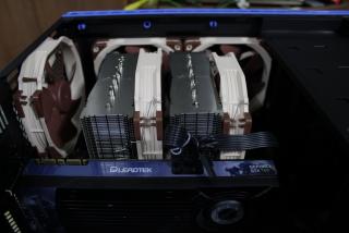

The finished looks. I need to clarify that those noctua fans aren't that ugly, but they do look ugly in photoes due to the color difference doh.gif The color actually same, even better than the colors you see on the noctua website.
I'm a Noctua Fan!!

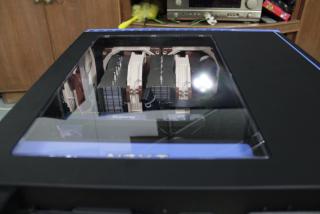

This is how the cooler looks when the pc is running.
