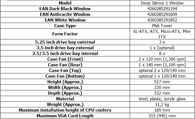

Specs of the DS1 is available on both sides of the box.
I'll just place a screen shot of the specs from Nanoxia's official site, just in case:
