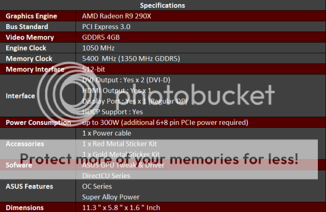

Specifications
Full specifications can be found HERE

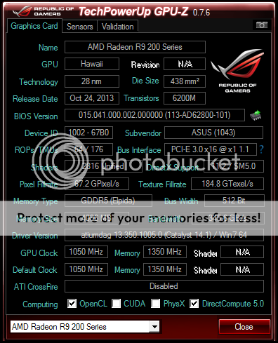

GPU-Z Information
On paper there is no doubt that the 290X DC2OC II is indeed a monster. The graphics card offers 2816 unified shaders, 64 ROPs, 176 TMUs, and 4 GB of GDDR5 memory on a 512-bit memory bus. Besides that, this card is factory overclocked to 1050 MHz for the GPU and 1350 MHz (5400 MHz effective) for the video memory, as compared to reference R9 290 (1000 MHz/ 5000 MHz).

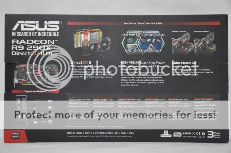

The back of the box shows the features and specifications of the graphics card.

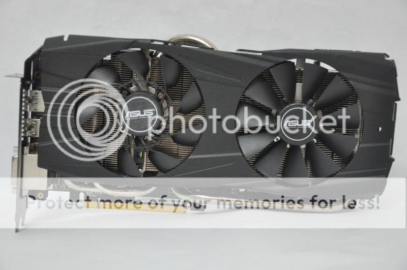

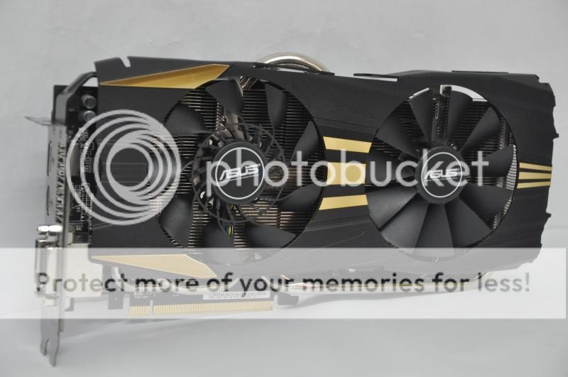

The 290X DC2OC is a dual-slot solution measuring 11.3" x 5.8" x 1.6” and comes with two 95 mm fans. One of the fans has a unique CoolTech design, which carries hybrid blade and bearing. This fan is capable of providing a multi-directional flow, to dissipate the heat effectively. The graphics card’s cooler come in one singular colour, which is black, but you can customize its look by using either the red or golden metal sticker kits that are included in the box.
The 290X DC2OC with red sticker kit.
The 290X DC2OC with gold sticker kit.

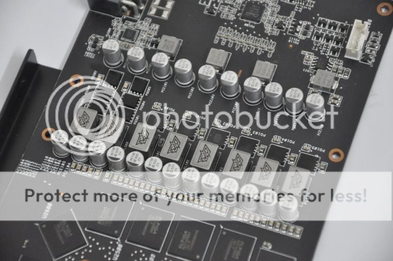

The 290X DC2OC is equipped with the DIGI+ VRM with 8 phase Super Alloy Power to deliver a precise digital power for superior efficiency, reliability, and performance.

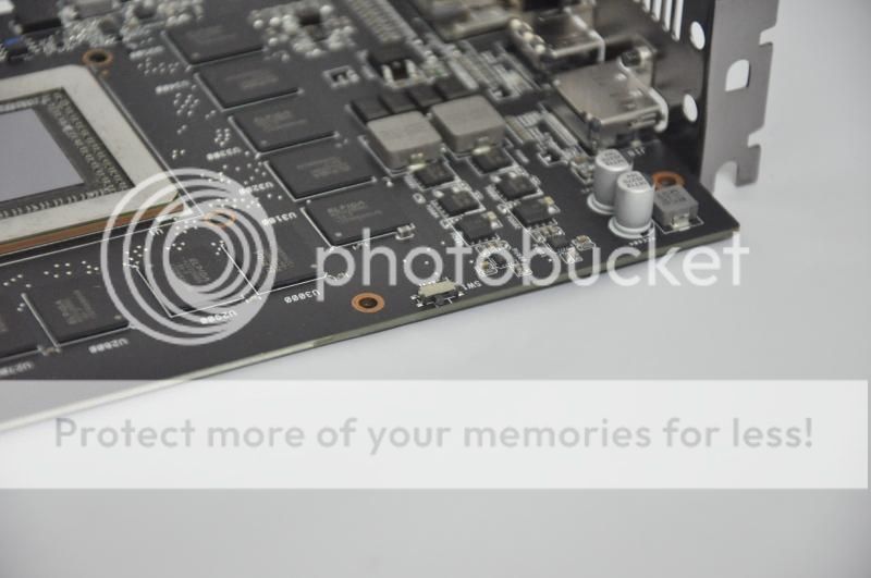

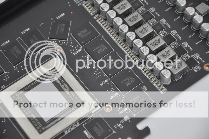

The memory chips are based on Elpida-BBBG GDDR5 that are said to have overclock ability not as good as the Hynix-AFR chip. It is disappointing that ASUS decided to use these memory chips on such a high end graphics card.

Also spotted, there's a tiny BIOS switch that allows you to toggle between two modes: “Silent” mode, which favours lower fan speed and noise, and “Performance” mode, which increases fan speed while maintaining maximum clocks. Our tests showed that there was no performance difference between these BIOSes, which is good. The only difference that we noticed were the temperatures, fan speeds and noise.

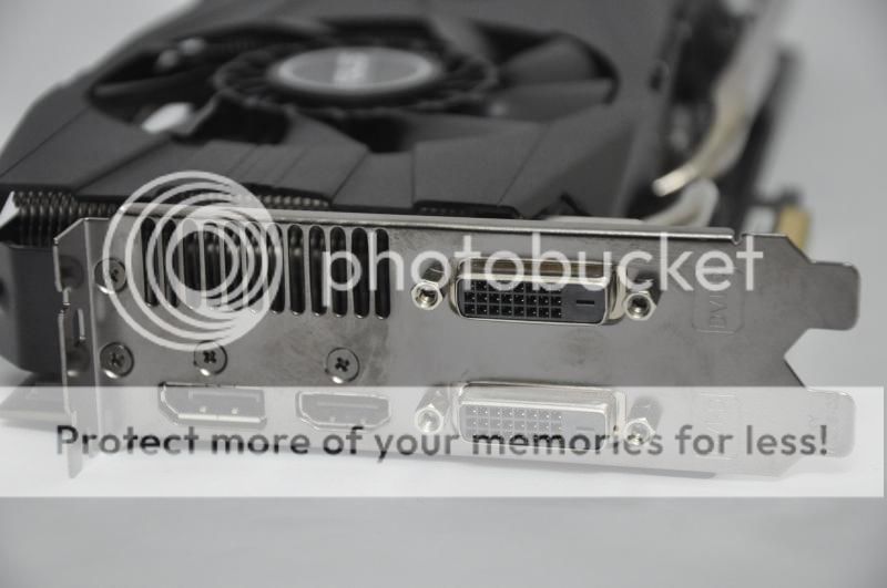

The rear I/O panel includes a pair of DVI-D ports, a HDMI port and a DisplayPort. These interfaces support up to three monitors simultaneously for Eyefinity setup.

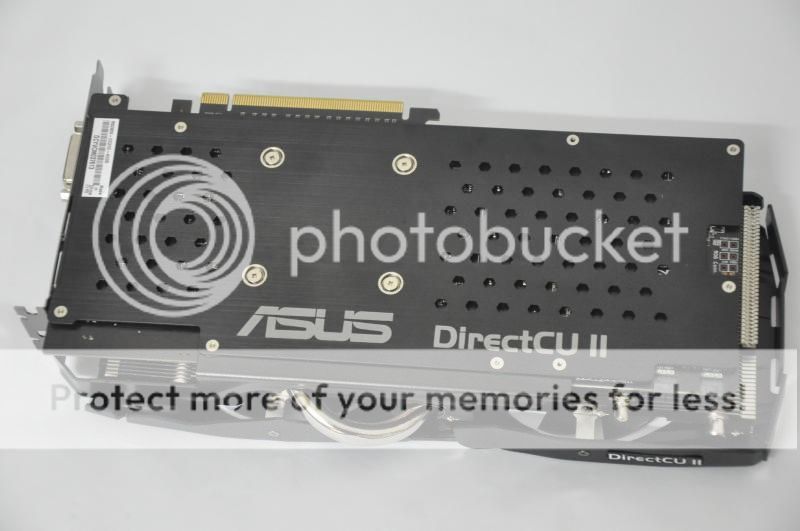

The aluminum backplate’s unique design does add some aesthetic looks to the graphic card as well as provides extra rigidity to the PCB.

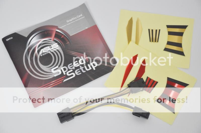

Included in the box is a dual 6-pin PCIe to 8-pin PCie Y-adapter, red and gold metal sticker kits, a quick setup guide and the driver/ utility CD.

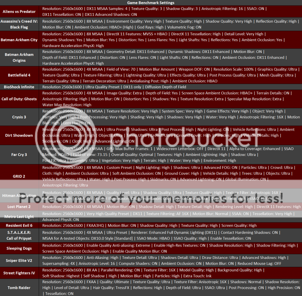

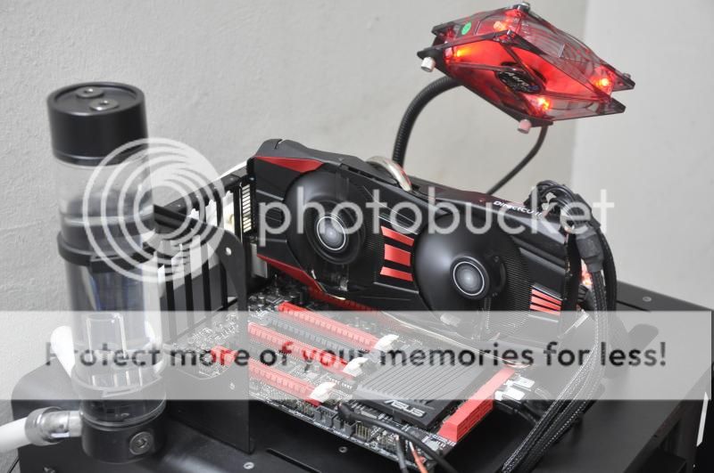

Testing Methodology
The Intel Core i7 4770K processor was overclocked to 4.625 GHz while all the graphics cards used were operating at stock clocks and stock cooler on air cooling. The 290X DC2OC was set to “Performance” mode. Ambient temperature was around 31°C throughout the benchmarks.
The settings for in-game benchmarks are listed in the table above.

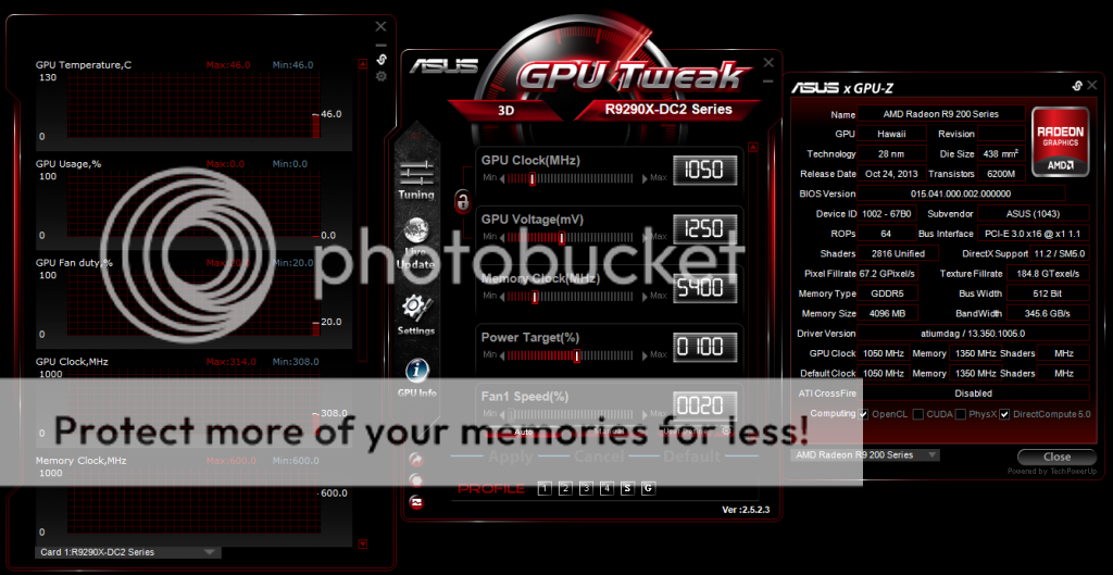

Software & Tools
ASUS GPU Tweak - an overclocking tool with GPU and memory tuning, overvolting, GPU loadline calibration and VRM frequency tuning, allowing for the most extensive control and adjustment parameters for maximum overclocking potential.

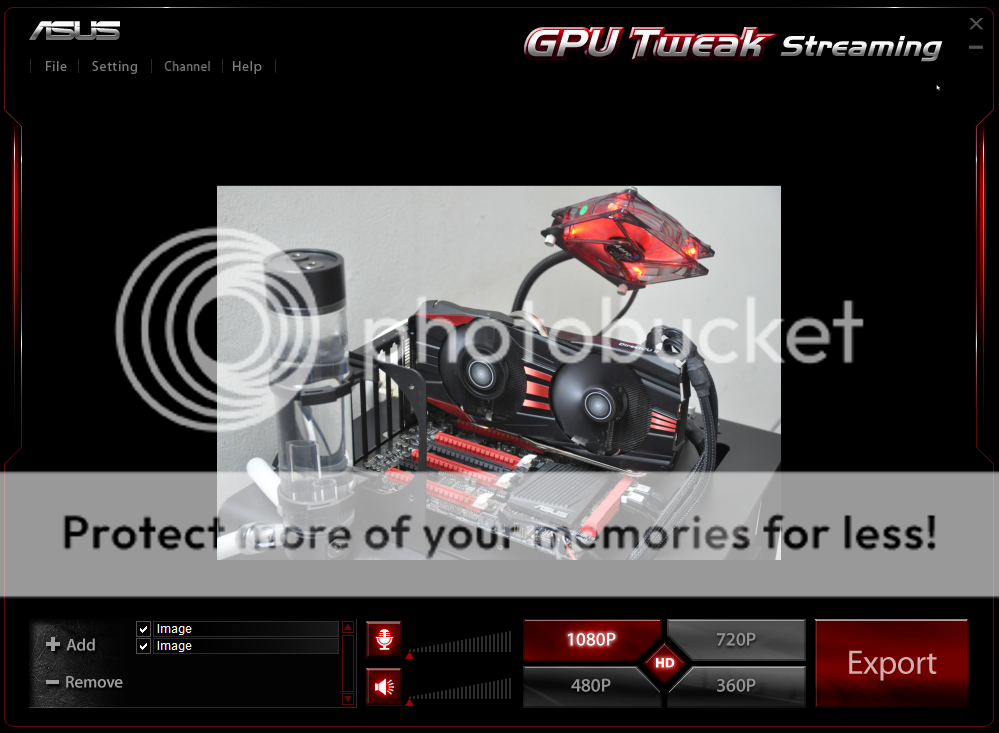

ASUS GPU Tweak Streaming - allows you to share on-screen action in real-time. Add scrolling text, pictures, and webcam images to the streaming window easily.

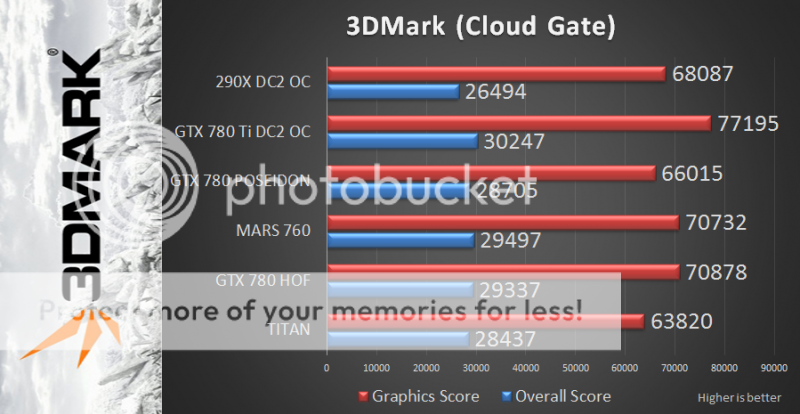

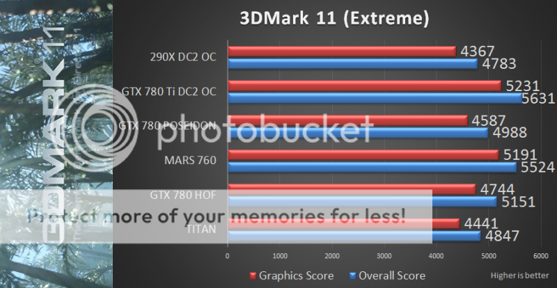

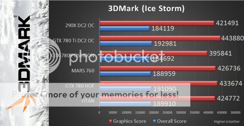

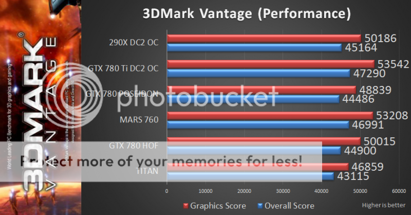

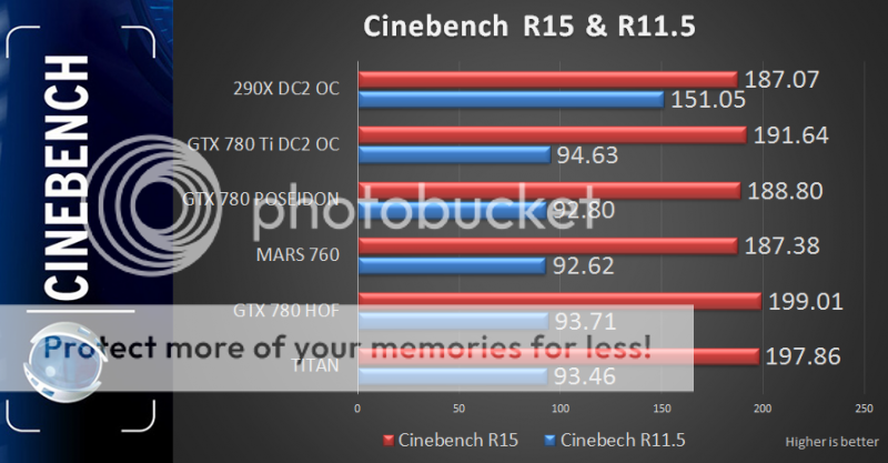

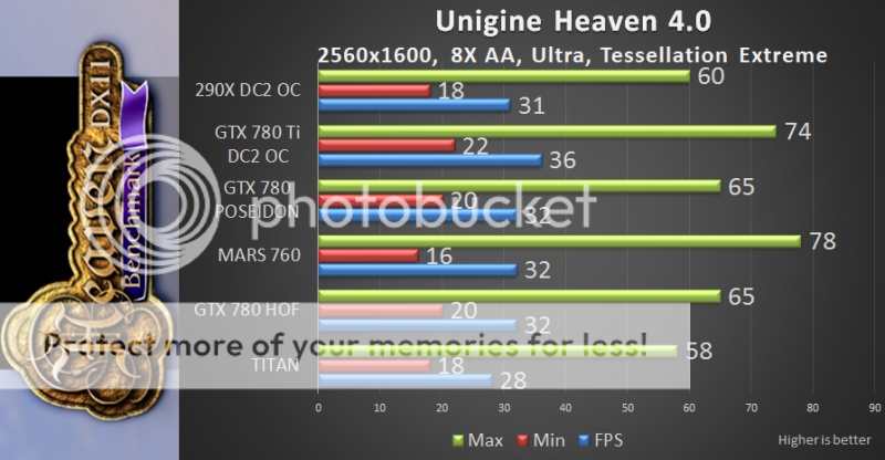

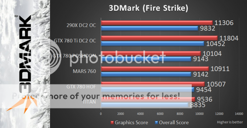

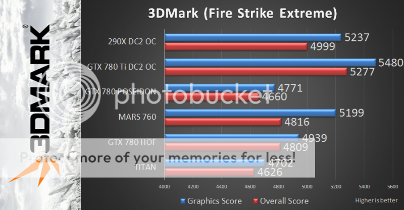

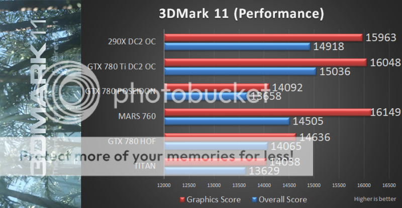

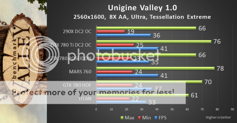

Synthetic Benchmarks

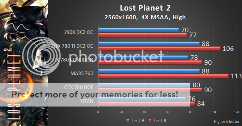

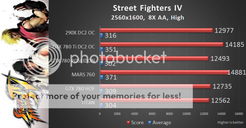

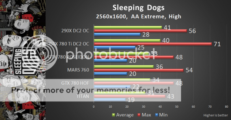

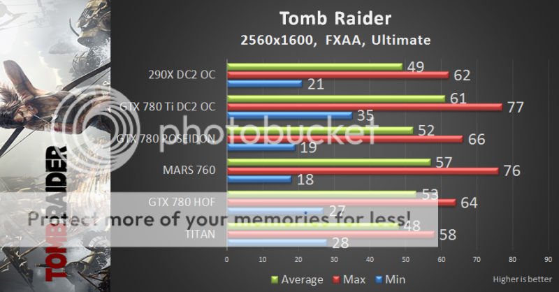

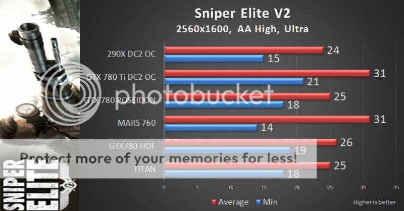

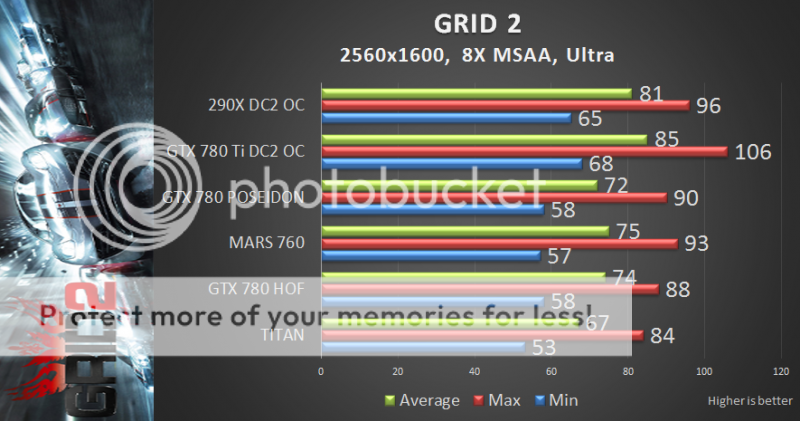

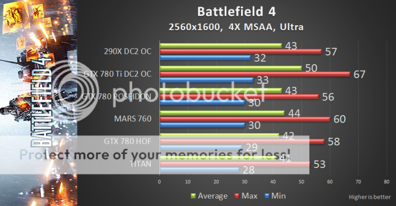

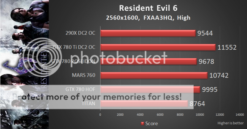

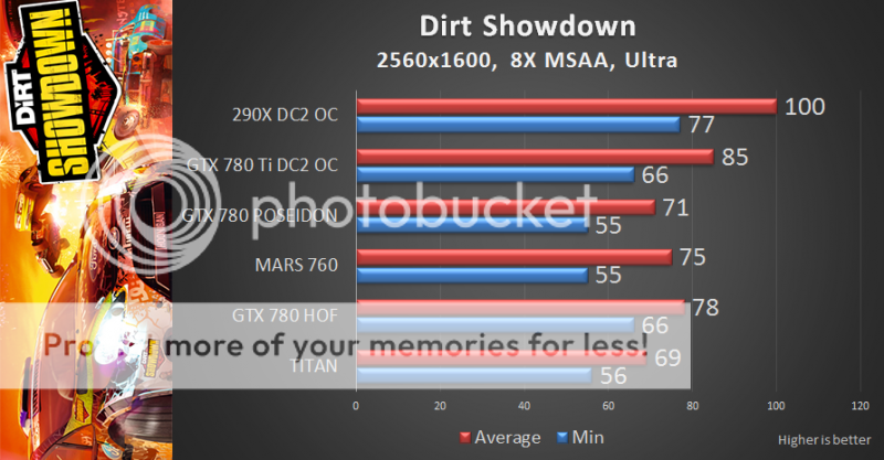

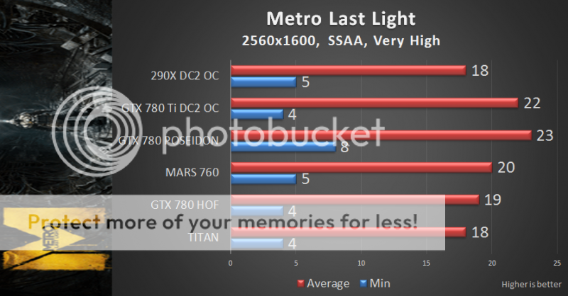

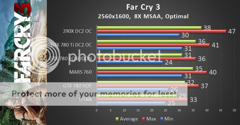

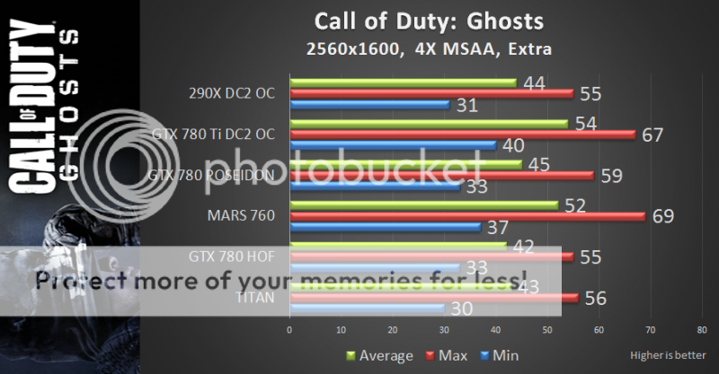

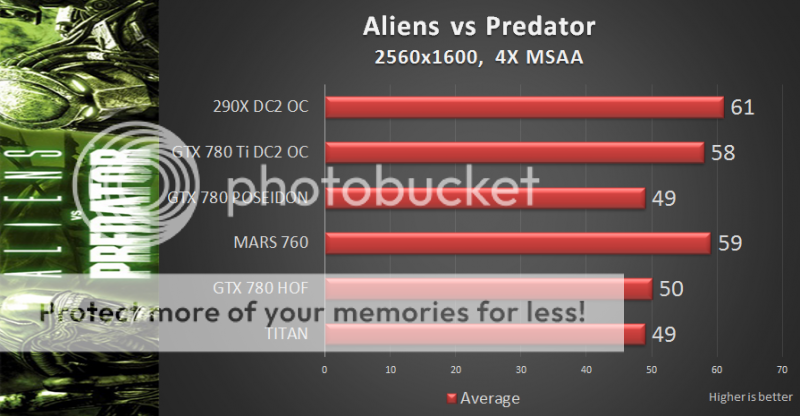

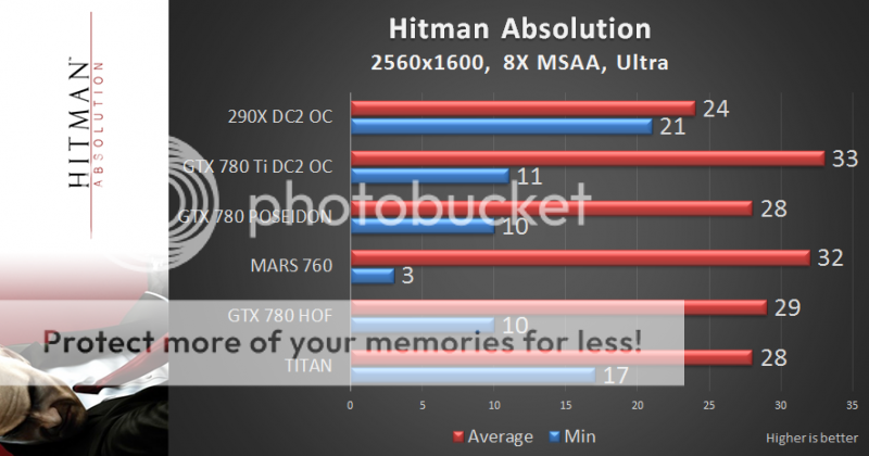

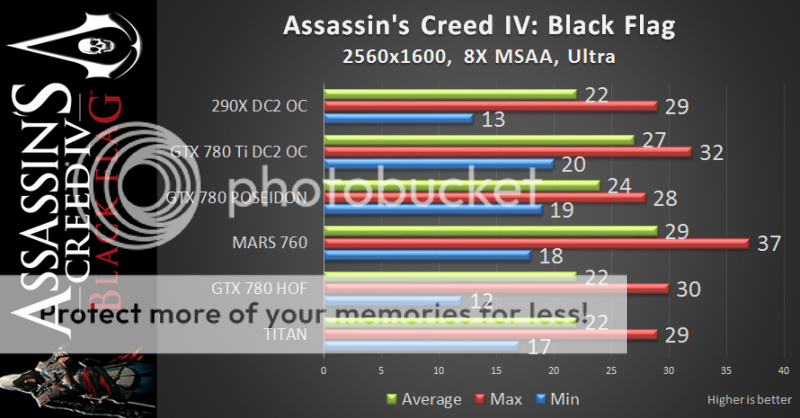

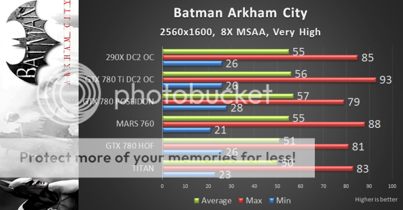

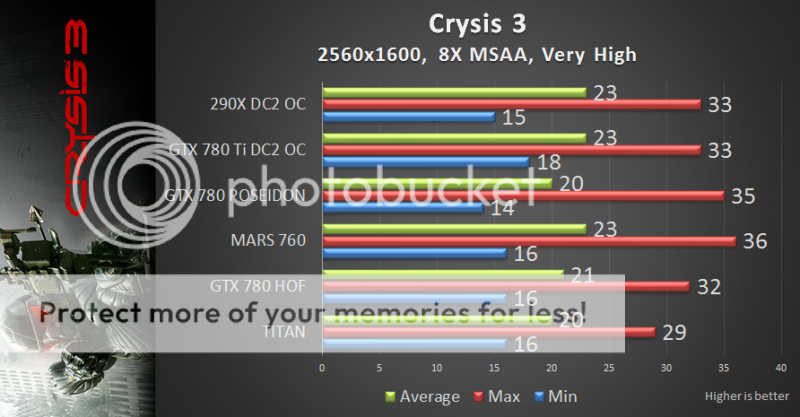

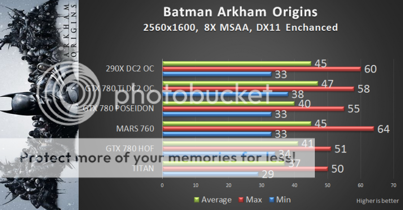

Game Benchmarks

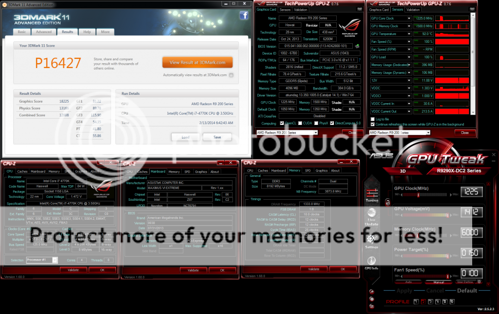

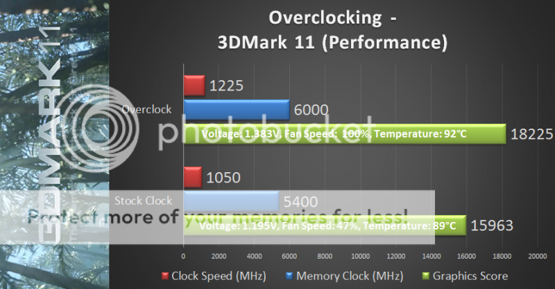

Overclocking & Temperature
With 1.383 V, we managed to overclock the GPU clock speed to 1225 MHz from 1050 MHz. Besides that, the video memory frequency was also overclocked to 6000 MHz from 5400 MHz. These are 17% and 11% overclocks for the GPU and memory clocks, respectively. The maximum temperature hit 92°C. In the 3DMark 11 benchmark, this overclock improved the graphics score by 14%.

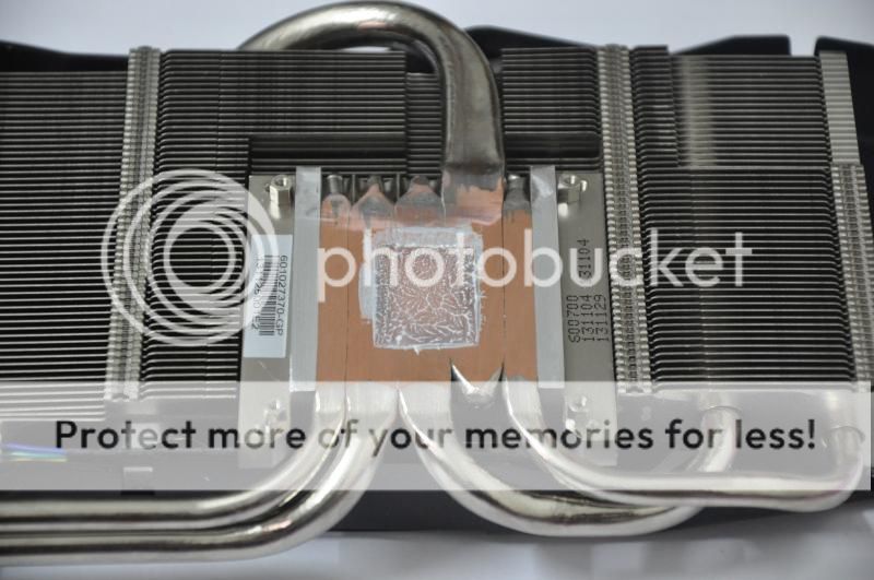

The 290X DC2OC has a bit of a problem; its cooler was actually designed for the larger GK110 GPU such as the GTX 780 Ti. As we can see this from the picture below, two of the copper heat pipes don’t touch the Hawaii XT GPU at all, and moreover two others make partial contact therefore result in inefficient heat dissipation. Their competing company, Sapphire managed to solve this by putting some heat pipes that have better contact with the AMD's GPU in their Tri-X cooling solution.

- DirectCU II base is not designed to fit AMD GPU, causing inefficient heat dissipation
