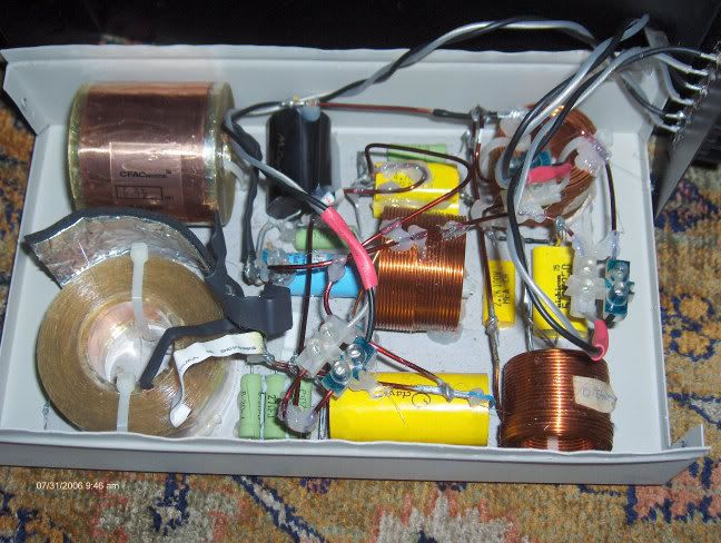

I tested the white one normal series in my crossover -- and can hear the singer's voice like having a cold or something ... then changed to the black one ZN -- no money to get the more exotic series sad.gif -- but the change definately brought a lot of improvements smile.gif
edit -- added image of my crossover -- it's a bit messy though but it does it's jobs ... using the cross for quite sometime but I feel still needs abit of modification.
powering some peerless mids and vifa tweets ..
This post has been edited by Escaflowne: Jul 31 2006, 09:57 AM
Lemon
post Jul 31 2006, 09:51 AM
donno lol..
1,443 posts
From: ......
QUOTE(Escaflowne @ Jul 31 2006, 09:28 AM)
is he using the white one or the black one(zn series) ?
maybe later I'll post some pics of my crossover
Please post, i want to see..
GRexer
post Aug 1 2006, 11:50 PM
VIP
3,815 posts
Escaflowne, is that a custom self-made passive crossover? Looks like there's quite some components inside, IMO, for passives, if possible, it's best to keep component count low wink.gif

Escaflowne
post Aug 2 2006, 06:38 PM
279 posts
QUOTE(GRexer @ Aug 1 2006, 11:50 PM)
yup I opted for a fourth order linkwitz riley design, impedance equalizer for both mids and tweets and a notch filter for the tweets just to balance up the sound --- reason for the jumbled up wires and component counts sweat.gif
** ohh and btw Fusion the blue coloured caps in the middle are the black gate AC series for crossover s * wink *wink .... And thanks for the advice biggrin.gif
