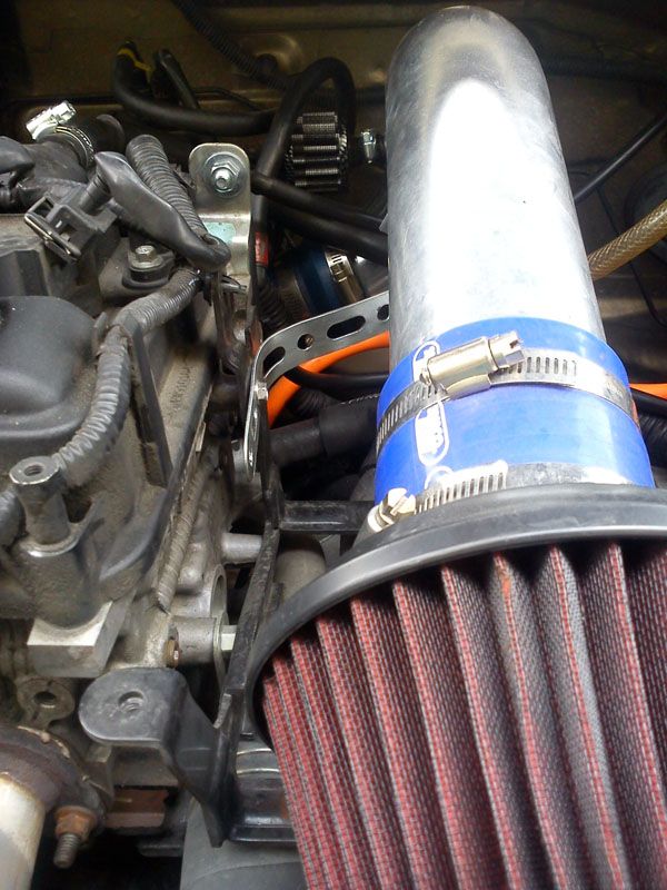

QUOTE(ichigotai @ Jan 27 2014, 10:51 PM)
well, the best tuning so far and it brings me to real CNY mood~
frank word i come to car club is to learn and making new friends. inactive since 2010 and nowadays appear.
glad that here the culture more or less in the good shape, some forums are dying......
back to topic, went to subang take 3max arb and installed it at workshop with @mahihi
meet up with jonathon, well verbal conversation, hope to see u again
prior that, i changed to absorbar to sport absorbar. it is all the preparation to install 19mm.
well, quite alot of parts, including ball arms and brackets. the installation is quite complicated, need to adjust the bar in middle and both arms all same aligned vertically.
this convince me rather than some so called BRANDED ARB which only a piece of steel and putting nuts only...
and oso improved the grounding cable point and bought an alternator booster from mahihi~ lol
sat nite drive home no rasa, memang la.... all highway u expecting what? lol
but throttle...... erm fine i all the way 110-170 play d~ just putting 5th and the throttle are quite well tally with my foot response~ since i got gc sets before and i still able to notice abit difference. the grounding point is vital hence i shall conclude, don't waste money to connect less effective points, it might give u drawback which is dragging ur car.
sunday, rest day... no testing
monday, which is today 27/1/2014....
driving own ride to foreman place to install alternator booster, sorry my friend he had to wait me, since got line issue at my factory and i late~ paiseh
playing those corner i used to be with higher speed.... and i felt the rear of my ride able to follow the pace of the front!
placebo, play more loh~ tackle another big left turn with 60kmh, which i normally do it at max 40kmh....
another noticable effect is the car less bumpy after installation of ARB...
will slowly slowly to push the car to the actual limit... one thing is when i do those hard cornering, the car will like "sticking" to the ground as usual driving at the straight road~ however i will observe tyre thread see whether it will cause extra burden due to lateral G force transfer~ since i notice one of my fren using so called god package >>> UR arb + stiff ring + ps3 and all the way teasing me endless months since he setup it on his car~ wtf
teasing me cornering is sucks and only can play straight road and asking me shao pei....
yup, keeping using tat arb and ur tyre will gg within another half years.... the extra lateral G force transferred will cause ur tyre wear out faster and uneven, good luck~
will observe 3max one will hv such drawbacks or not~ nothing is 100% but in general i do, i do love this setup now~
plainly the user feedback and if any masters, sifus correct me if i got any misunderstanding on the physics law playing behind the arb, thanks~
Regardless UR or 3MAX you've installed, the problem with CONSUMER will always stay positive to PLACEBO. The faster you go, the more camber thrust your tyre take, the faster tire wear off. Perhaps your next move, go for a softer spring and observe how your car react, probably will surprise how well it goes with the OEM stuff whistling.gif

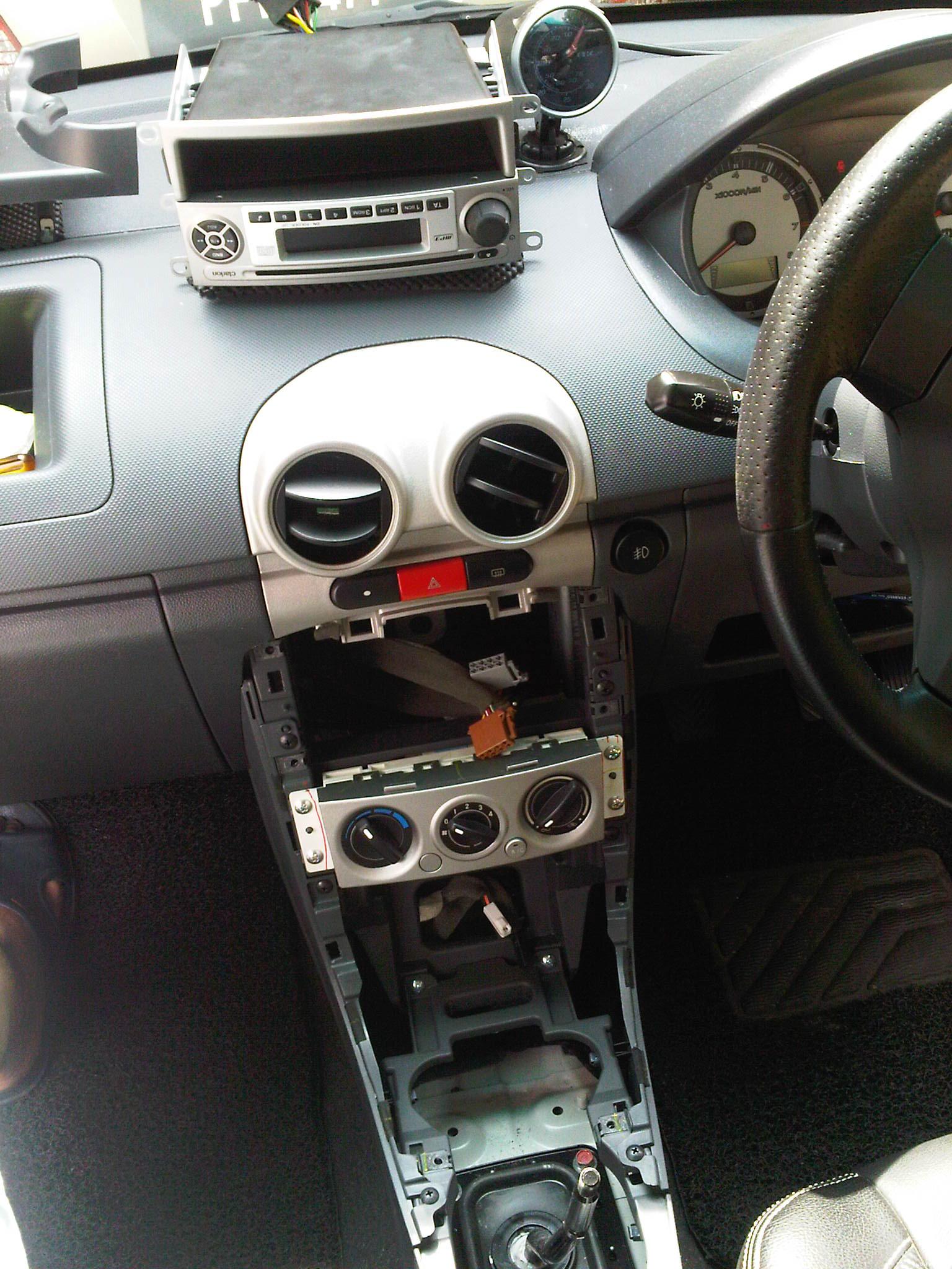

Bro's...
anyone know how to take out player from panel? cvt here. i already brought new player and want DIY blush.gif
try to install myself. any tutorial will be grateful.

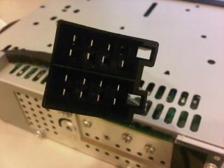

QUOTE(LOGIN @ Jan 30 2014, 07:57 PM)
Bro's...
anyway happy chinese new year 2014.
1. Remove panel around gear lever. For manual it's only held by clips, no screws to remove, don't know about CVT.
2. Remove the cupholders and the panel as shown in the pic below. Once the visible screws are removed, the panel is held by clips and you have to pull very hard to loosen it. Remember to unplug the 12v power socket connector.
3. Screws holding down the HU and the storage compartment should be exposed, the two will come out together and you can then separate the HU from the compartment.
4. Most likely the plug for the stock HU will not fit your new HU, you either need an adapter, or in my case, cut the wires from the stock HU and attach to new HU.

Btw this is the stock HU socket, see if it matches the one of your new HU.

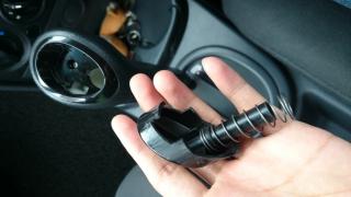

Spent the morning helping my sis fix her seatbelt because it would not auto-retract sleep.gif

QUOTE(dares @ Jan 31 2014, 09:41 AM)
From what I saw on the Gaga's retracting mechanism, my guess is that if you see any wire running from the mechanism, it has pre-tensioners. They usually go hand in hand with airbags.

QUOTE(lhwj @ Jan 31 2014, 09:51 AM)
Gaga is the mechanical/eletric type or pyrotechnic type?
I'm sure I didn't see any pyrotechnic mechanism on the seat belt retractor. Perhaps it's the electric type, though I didn't notice any wires. Too lazy to dismantle the plastics again yawn.gif

QUOTE(dares @ Jan 31 2014, 09:57 AM)
I'm not sure actually unsure.gif But regardless of which type, the fact that there is a wire to activate the pre-tensioners indicates its existence.

QUOTE(lhwj @ Jan 31 2014, 12:17 AM)
Done!
for no.1 manual n cvt the same. tq

QUOTE(lhwj @ Jan 31 2014, 12:34 AM)
HU the same as i brought the same player. just got extra feature for mp3. blush.gif
(sv dont hv mp3. just cd) cost me rm100. the previous owner cut 2 wire.. yellow and red.
what i did is remove the inside pin using small flat screw drive. (the flat pin inside got stopper)
if u see inside the cover, got holes between pin.. put the small flat screw drive inside holes and
push it upwards to the pin to flatten the stopper.. then push the pin to remove it (i did by using allen key)
once the pin out, i solder the wire back to the pin. cover with pvc taper ..insert the pin to the cover. done.

P42 have per-tensioner what type I'm not sure because usually we replace the whole seatbelt unit if the air bag is deployed. According to our repair manual if air bag deployed seat belt per-tensioner unit in the seat belt mechanism need to change.
There's also the mechanical type per-tensioner. Most cars have them. You can try this, try pulling your seat belt rapidly and it will refuse to extend. Then you need to release it in order for it to re-extend again.

QUOTE(TitanRev @ Jan 31 2014, 03:50 PM)
That one is inertial locking mechanism ler, not pre-tensioner.
The locking mechanism only locks the seatbelt and prevents it from extending, but pre-tensioner will pull and tighten the seatbelt when airbags is deployed hmm.gif

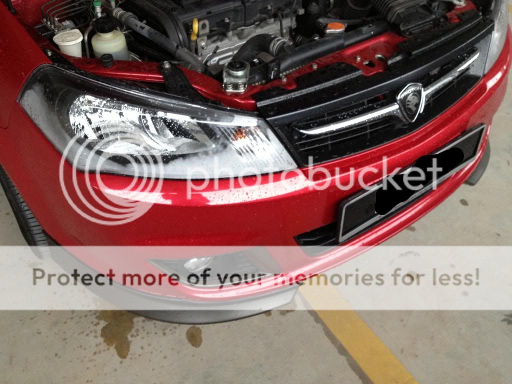

Guy my waifu bang a dog and driver side secondary lamp fall off.
Want to ask need to take down whole bumper to access there or the secondary light area can easily remove?
Btw is flx se

QUOTE(bai1101 @ Jan 31 2014, 09:55 PM)
Btw is flx se
U mean foglamps. prolly need to remove bumper cz the mounting is screwed from inside...

davidke20 wah ur putty quite fast dry on outer part. Take out a while the outer part start to dry. Need to apply fast fast laugh.gif

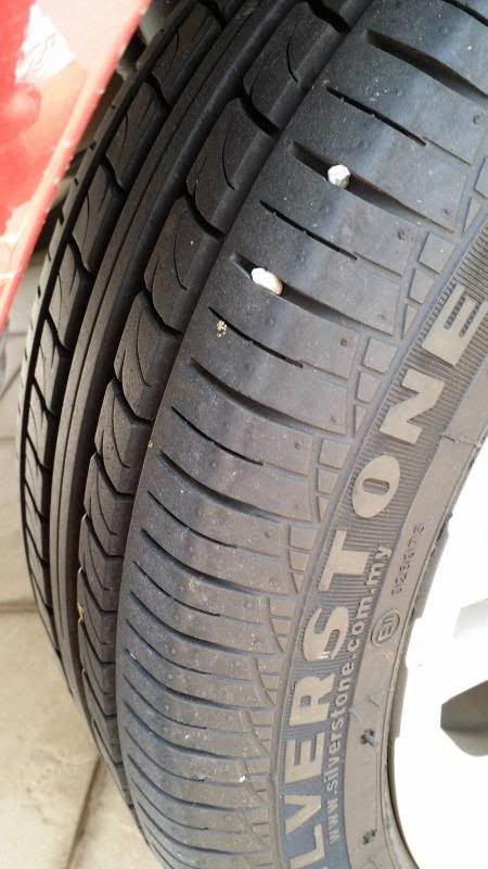

QUOTE(dares @ Feb 5 2014, 01:54 PM)
take out whole lamp mia...
QUOTE(dares @ Feb 5 2014, 02:00 PM)
I can only see that Biba tomoro or Friday, I try 1st.
The front left tire also leaking air but dun see any paku, the tayar shop don't even bother to check for her doh.gif
take out whole tyre pump to 40psi rendam water check...
if u lazy just mix detergent (powder type) with water then use a sponge to sapu the whole tyre and see mana bubble keluar...

iskazulka
post Feb 6 2014, 12:44 PM
62 posts
Joined: May 2012
Clareen
https://forum.lowyat.net/uploads/attach-93/...-1361260839.jpg
This post has been edited by iskazulka: Feb 6 2014, 01:01 PM

Yesterday i pergi kedai tayar. tayar bocor kena kayu.
n then i cross swap tayar..buat balancing n then alignment..
masa buat alignment, tayar sebelah depan kiri senget.sebelah driver okay. the technician asked whether nak repair @ x, coz my car under waranti.. but he informed me that even i go to SC, they will not do anything..
but if i proceed to let the workshop to solve the problem, i dont know apa yg akan void. suspension ka or anything. so i tak bagi technician tubuat apa2.
any comment @ suggestion? should i proceed @ just go to SC?

QUOTE(r3apers @ Feb 6 2014, 01:57 PM)
Tried 2 hours sweat like a pig, give up send to nearby shop and kawtim in 10 minutes for RM5 doh.gif doh.gif doh.gif doh.gif doh.gif
This post has been edited by dares: Feb 6 2014, 05:28 PM

QUOTE(dares @ Feb 6 2014, 05:27 PM)
Last time my stock FLX SE with no bars at all and no Ular Oren pun dabao bnyk dugong dan kura2 ketika naik genting. Summore aircon on and not even trying very hard whistling.gif  carrying 4 people also can go up without breaking a sweat......
haha... so missing which clip or screw? iinm its only got 3 or 4 only except got hiding wan... ph34r.gif
dares
post Feb 6 2014, 05:37 PM
834 posts
Joined: Jul 2011
QUOTE(r3apers @ Feb 6 2014, 05:35 PM)
screw only got 2. There are 2 plastic clips behind the lamp, one near the top another near the bottom, need to use screwdriver (wrap with cloth) and kiao the outside edge of the lamp to force it out. Use hand pull kenot wan.
oic... haha... the clip should be the same as the headlamp clip... quite hard type.. sweat.gif
dares
post Feb 6 2014, 06:01 PM
834 posts
Joined: Jul 2011
QUOTE(r3apers @ Feb 6 2014, 05:49 PM)
Next time just send to workshop suan liao, wasted 2 hrs to save RM5 shakehead.gif
r3apers
post Feb 6 2014, 06:08 PM
225 posts
Joined: Feb 2010
From: Subang Jaya
QUOTE(dares @ Feb 6 2014, 06:01 PM)
lol. but now u know should be easy lo...

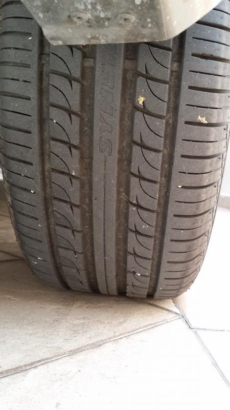

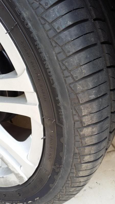

Joined: Jun 2013

go to sc first... ask them properly... don't risk voiding ur warranty...
