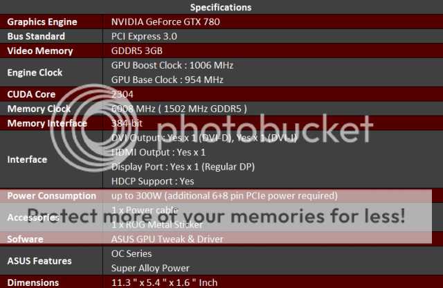

Specifications
Full specifications can be found HERE

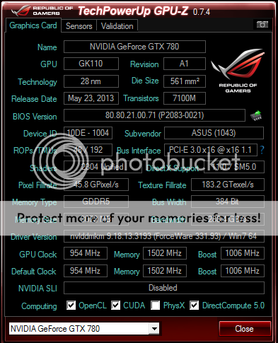

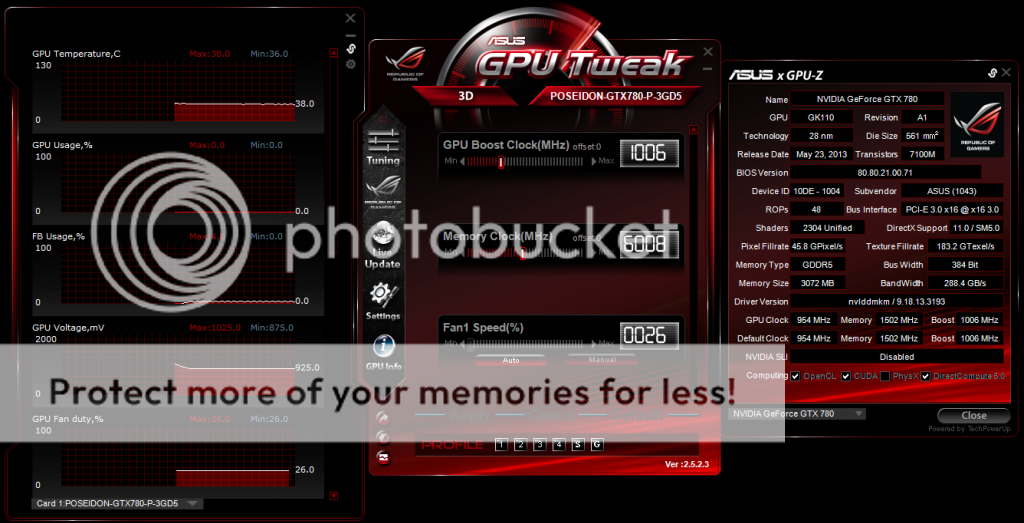

GPU-Z Information
The GPU offers 2304 stream processors, 48 ROPs and 3GB of GDDR5 memory on a 384-bit memory bus. This card features NVIDIA GPU Boost 2.0 technology and has a GPU base clock of 954 MHz, a boost clock of 1006 MHz and the memory is clocked at 1502 MHz (6008 MHz effective).

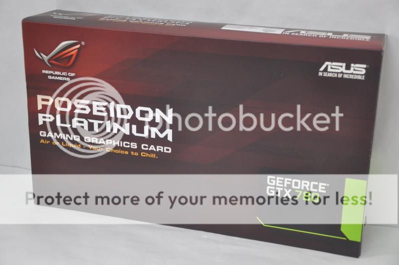

Unboxing

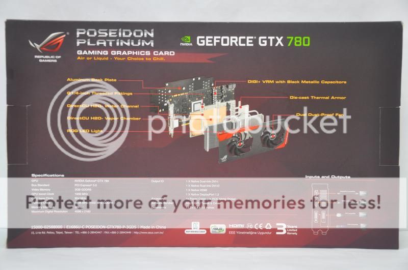

The graphics card comes in a red box illustrated with the ROG design.

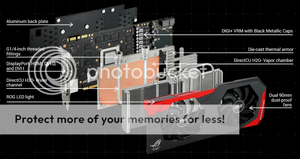

On the back of the box we can see the schematic design of the hybrid cooler.

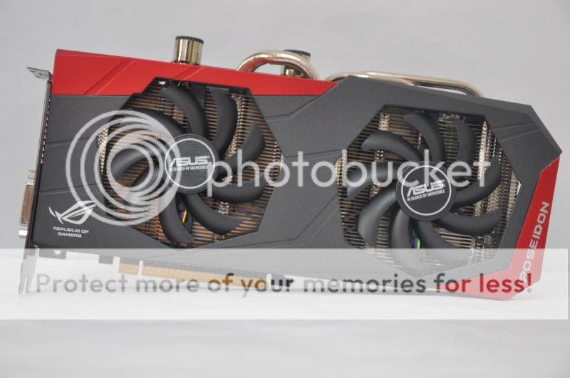

The Poseidon Platinum GTX 780 is a dual-slot solution measuring 11.3 " x 5.4 " x 1.6 ". The DirectCU H2O cooler carries two 90 mm dust-proof fans. ASUS claimed that this unique cooler provides 7°C cooler on air and 24°C cooler with water than reference design. On lower right corner of the cooler there is a “POSEIDON” logo which will not light up at all.

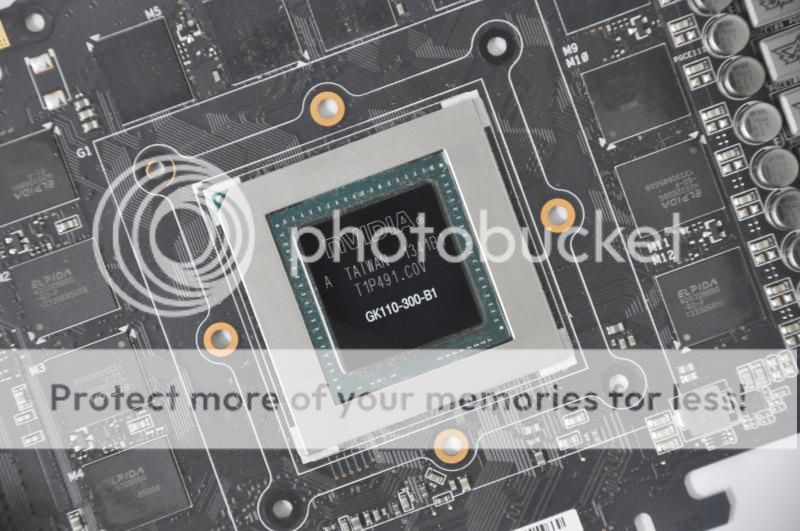

The NVIDIA GK110 Revision B1 GPU chip is soldered at the middle of the graphics card. For record, GK110 was first introduced as a Tesla-only product for powering demanding GPU compute applications. NVIDIA has now also released it as a GeForce GPU. It uses 7.1 billion transistors on a die size that we measured to be 561 mm². The GPU is produced on a 28 nanometer process at TSMC, Taiwan.

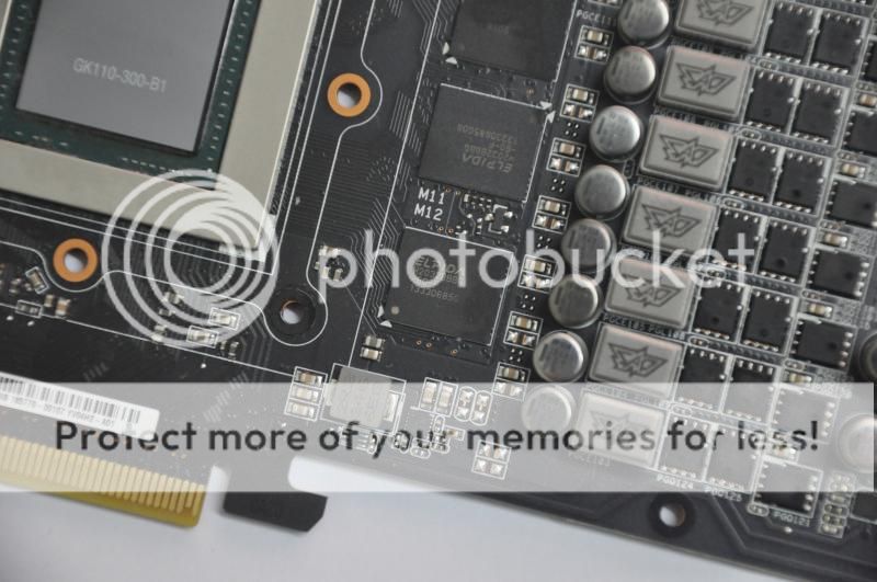

The memory chips are based on Elpida BBBG GDDR5 that are said to have overclock ability not as good as the Hynix-AFR which can be found on other rivals’ equivalent. It is disappointing that ASUS decided to use these memory chips on such a high end ROG graphics card.

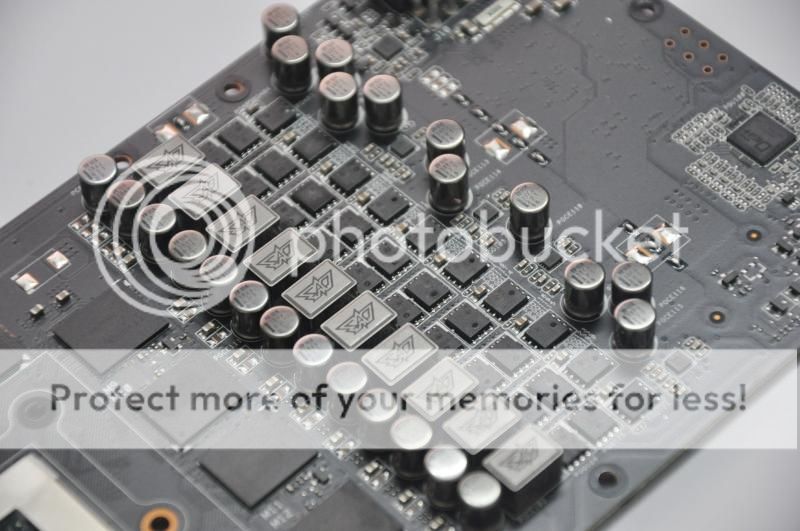

Let’s look closer at the power delivery design of the graphics card. The VRM power design gives 10 phase power with Black Metallic Capacitors so that we don’t have to worry about the overclocking stability.

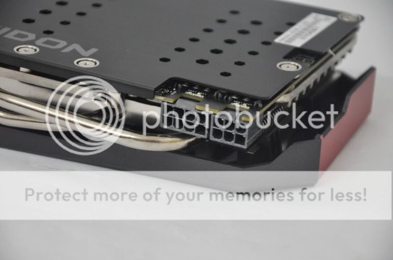

The graphics card draws power from an 8-pin and a 6-pin connector.

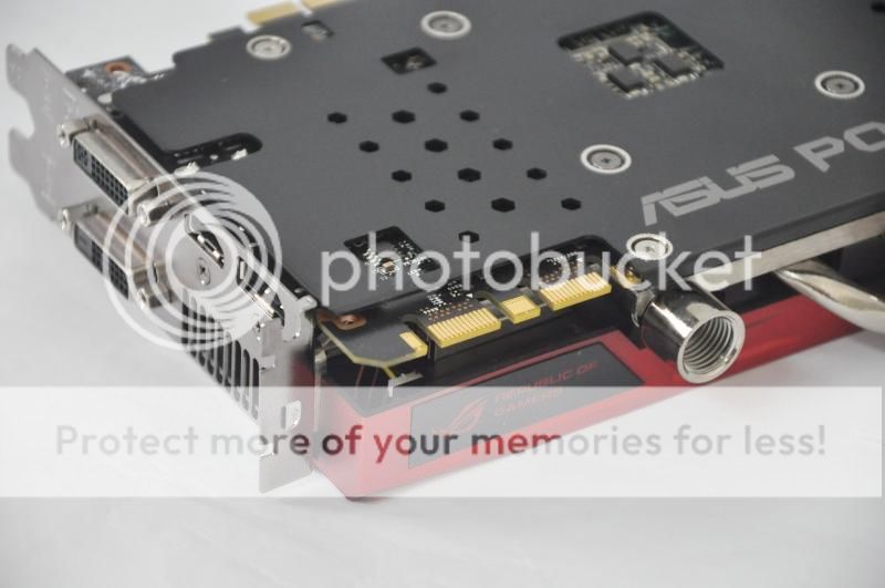

The SLI connectors support up to 3-way SLI (4-way with modified driver).

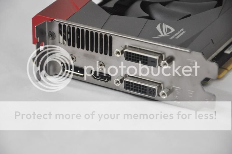

The rear I/O panel includes a DVI-D port, a DVI-I port, a HDMI port and a DisplayPort. These four interfaces support up to four monitors simultaneously for 3D Surround setup.

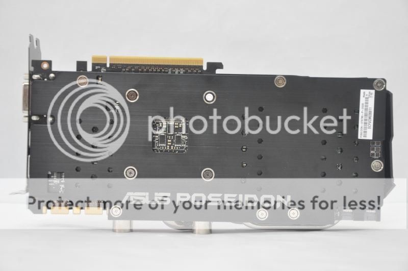

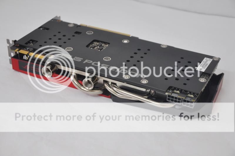

The aluminum backplate’s unique design does add some aesthetic looks to the graphic card as well as provides extra rigidity to the PCB.
On one the side of the hybrid cooler we have a pair of G1/4 inch fittings for liquid cooling. You can use any standard barbs or compression fittings. Also spotted, an “ASUS Republic of Gamers” logo near the I/O panel which will light up in red colour and blinking when the card is running.

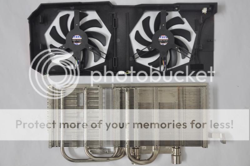

Now we will get down to see the hybrid cooling solution. The DirectCU H2O radiator comes with three beefy heatpipes so that the heat will be dissipated efficiently.ASUS utilizes the Vapor Chamber technology which is known to have a better performance than regular cooling solutions.

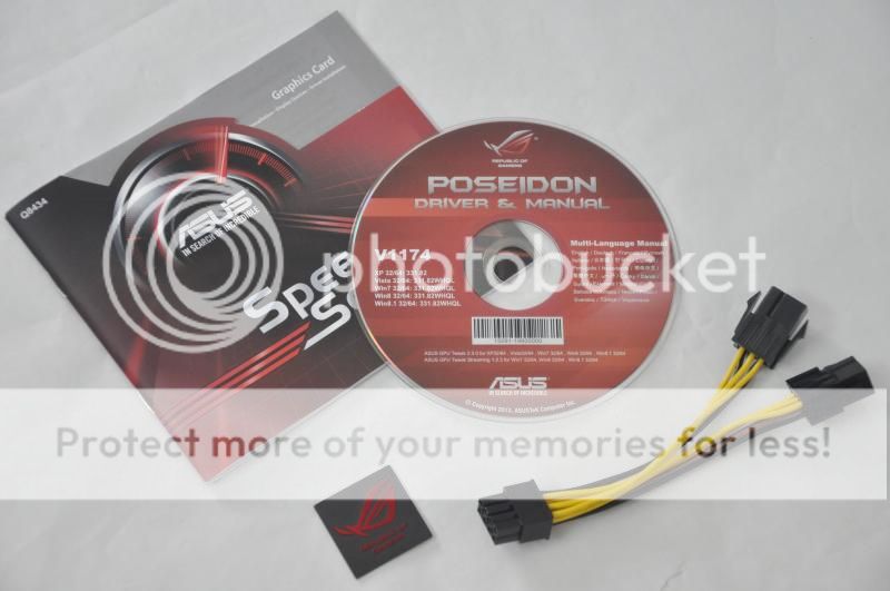

Included in the box is a dual 6-pin PCIe to 8-pin PCie Y-adapter, a ROG sticker, a quick setup guide and the driver/utility CD.

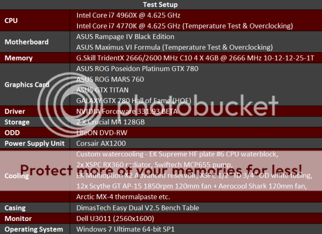

Test Setup

Testing Methodology
The Intel Core i7 4960X processor was overclocked to 4.625 GHz while all the graphics cards used were operating at stock clocks and stock cooler on air cooling.
As for temperature test and overclocking part, we used Intel Core i7 4770K overclocked at 4.625 GHz with the ASUS Maximus VI Formula.

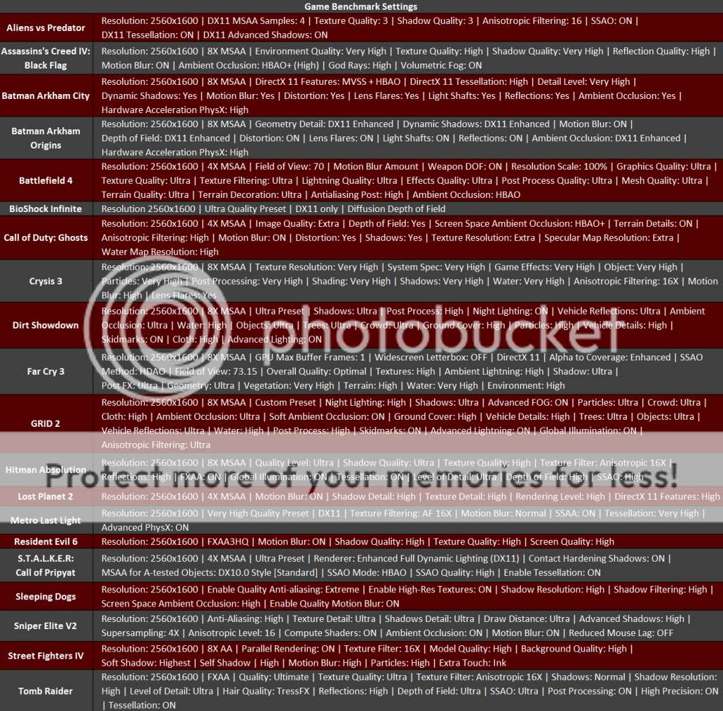

The settings for the in-game benchmarks are listed in the table above.

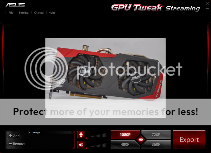

ASUS GPU Tweak Streaming - allows you to share on-screen action in real-time. Add scrolling text, pictures, and webcam images to the streaming window easily.

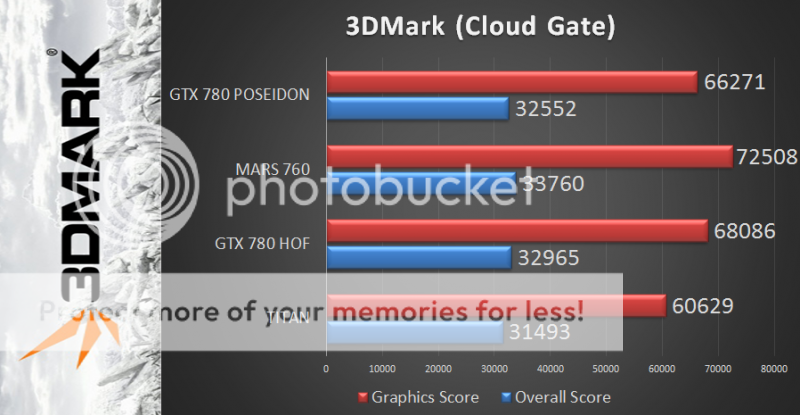

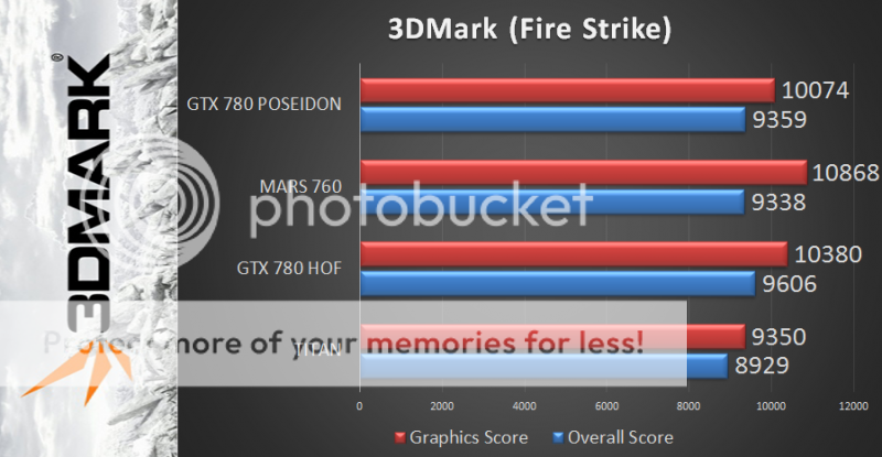

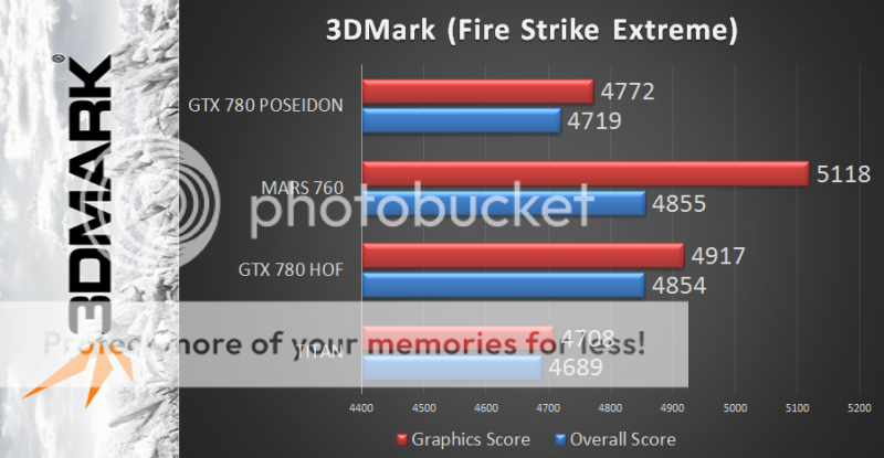

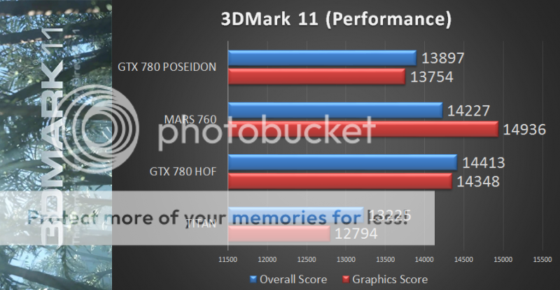

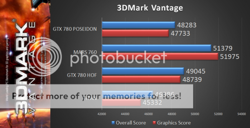

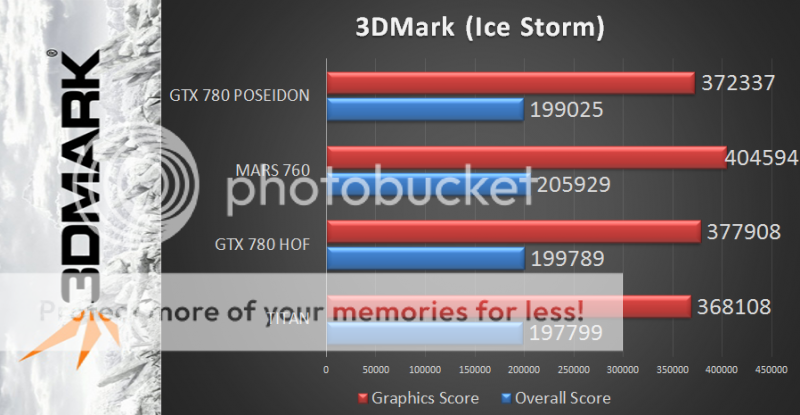

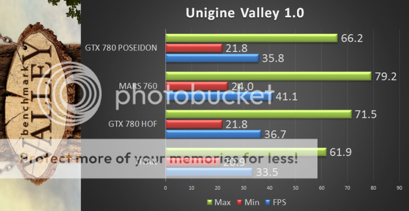

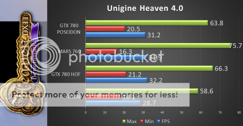

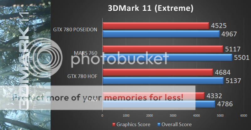

Synthetic Benchmarks

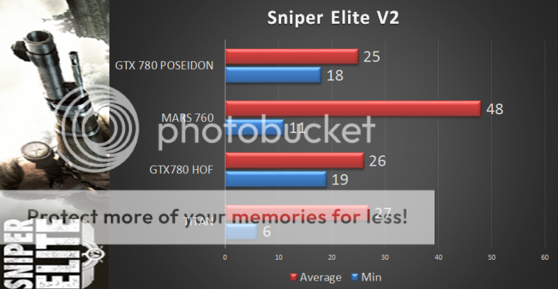

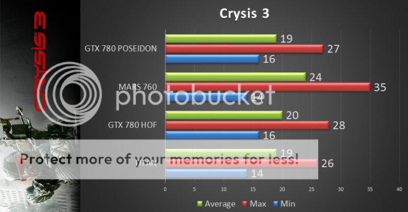

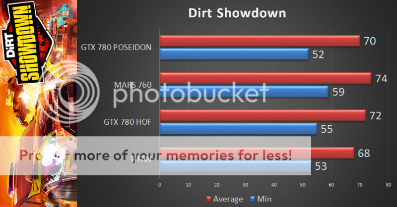

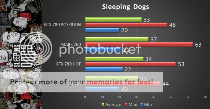

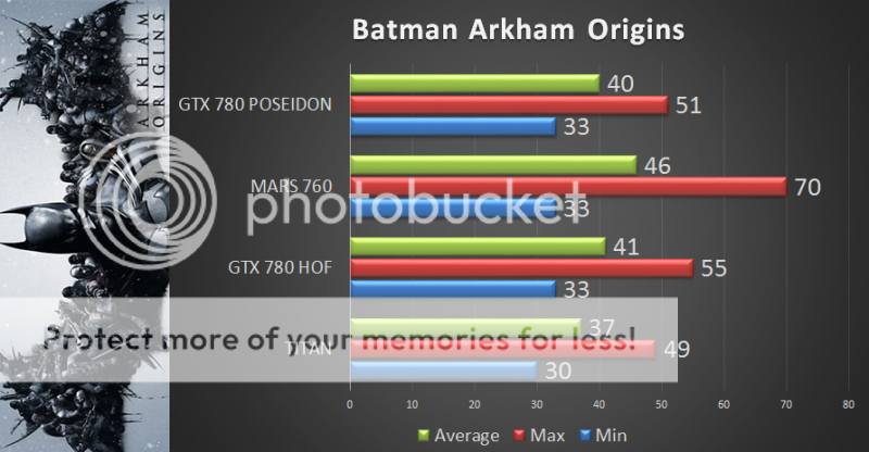

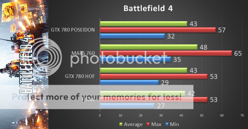

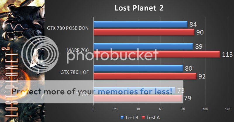

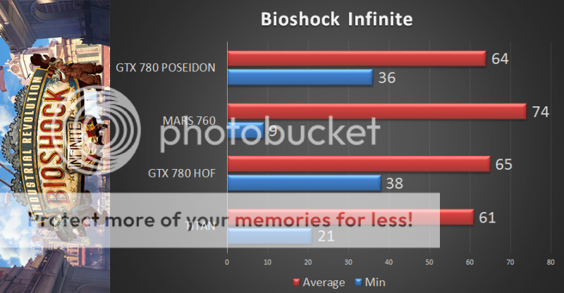

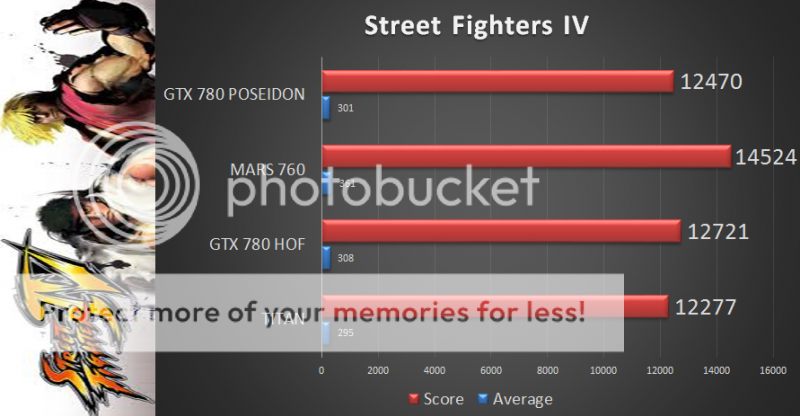

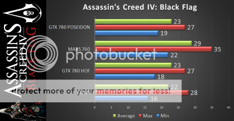

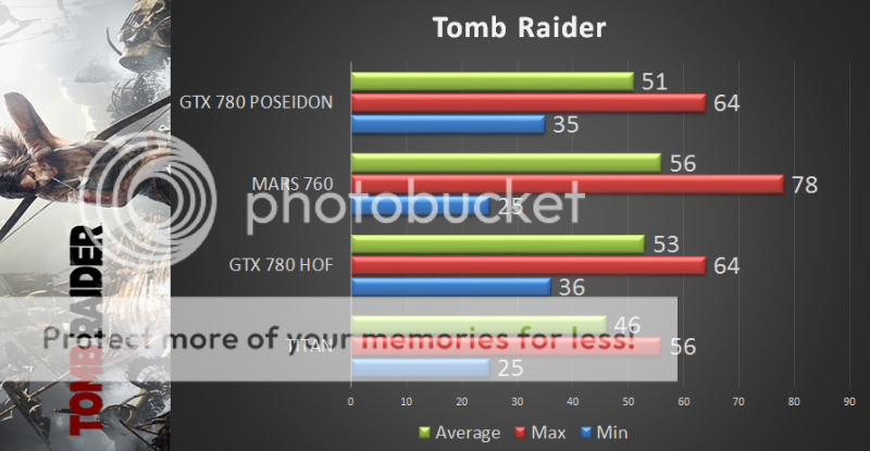

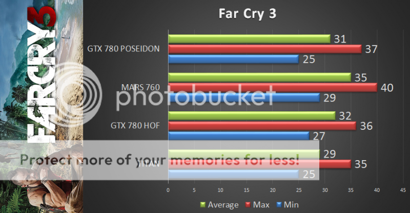

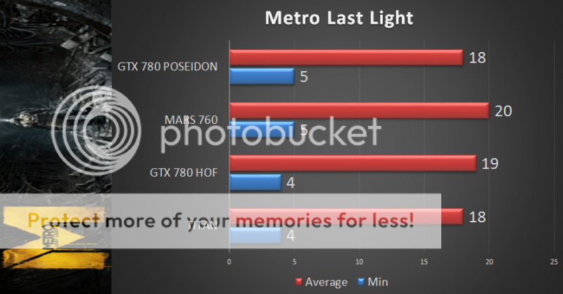

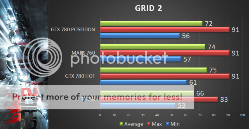

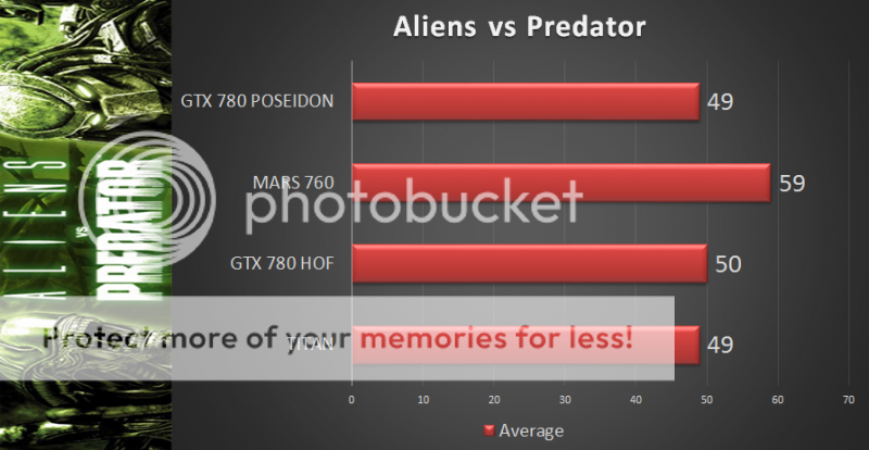

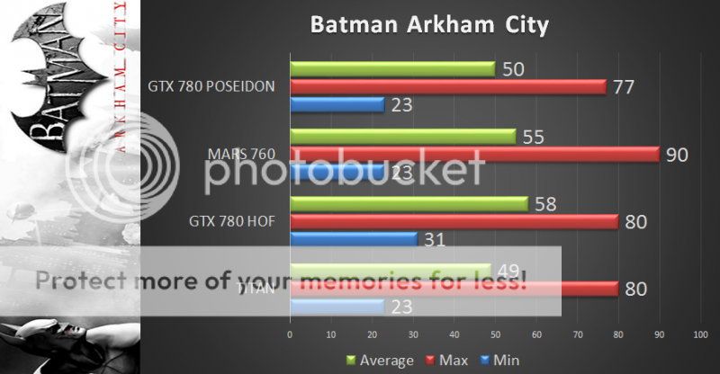

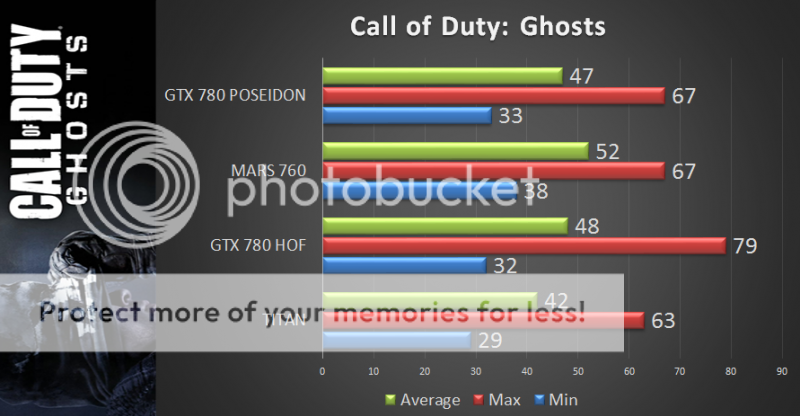

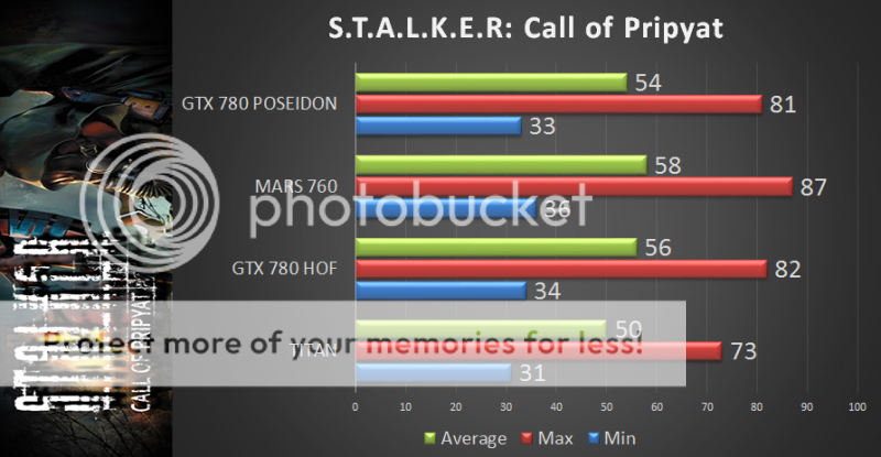

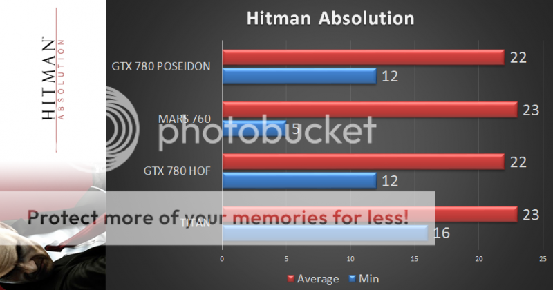

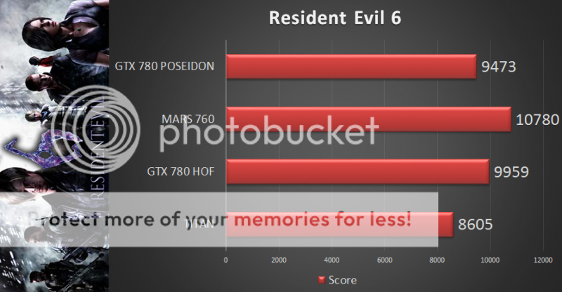

Game Benchmarks

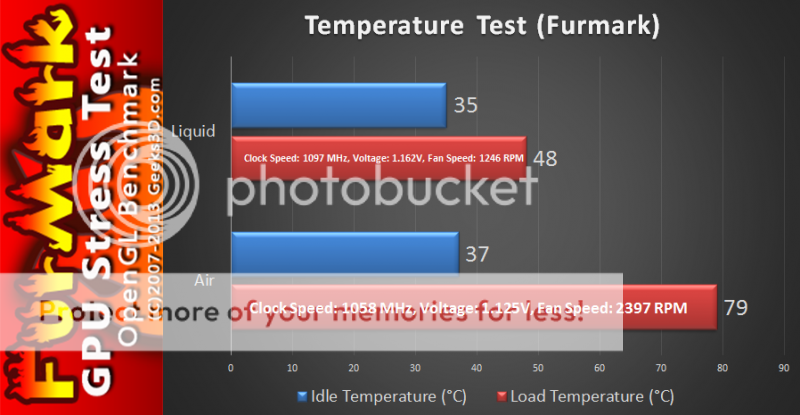

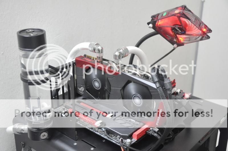

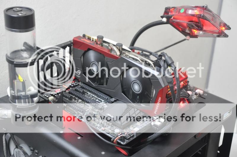

Temperature Test
We tested the Poseidon GTX 780 Platinum under both air and liquid cooling with the help of Furmark burn-in test.
With air cooling and the fan spinning at 2397 RPM, the temperature hovered around 79°C. We noticed that the clock speed dropped slightly from 1097 MHz to 1058 MHz.
During the liquid cooling mode, the temperature dropped to 48°C with fan speed at 1246 RPM. The clock speed maintained at 1097 MHz. The ambient temperature was around 30°C. It should be noted that the fans cannot be turned off so it is impossible to run the graphics card only in liquid cooling mode.
Overclocking
On air cooling, we managed to push the GPU frequency to 1280 MHz (boost) and video memory frequency of 7011 MHz. The maximum temperature hit 62°C with a supplied voltage of 1.193V.
Liquid cooling did not bring us much further other than the fact that the card ran cooler. We only able to push another 13 MHz on the GPU frequency. The maximum temperature hit 46°C with a supplied voltage of 1.195V.

Thoughts & Verdicts
The ASUS ROG Poseidon GTX 780 Platinum is a powerful graphics card that is capable of outperforming the mighty GTX TITAN. The graphics card is solid, packed with high quality components such as Black Metallic Capacitors and Super Alloy Power feature. It is a good graphics card for gamers that are going to be gaming on a 2560x1600 or 2560x1440 panel.
