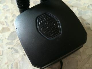

And here's the main body of the Nepton 140XL. The pump looks much larger and thicker compared to the pump of the Seidon series self-contained liquid cooler. The FEP tubing and the radiator seems to be thicker as well.
Below the pump is the copper plate to transfer heat from your CPU to the liquid that passes through the micro channel on the copper plate. Unlike the previous generation, the Nepton 140XL copper plate is secured with an uncommon looking screws which can only be seen from a professional screw drivers kit.

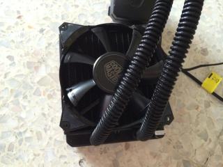

Check out the thickness of this radiator! From our observation, it is way much thicker compared to any other radiator of self-contained liquid cooler we've encounter so far.
Attached Image Attached Image
On the radiator itself, there's a warning message on a piece of sticker that warns user not to tamper the knob in the radiator. This is where you can change the coolant within the closed loop, but removing it will instantly void the 2 year warranty covered by Cooler Master. Better think twice before proceeding with what you plan to do with it.
The radiator is rather special - a 140mm radiator that supports both 140mm and 120mm fans. It's not a common design we've seen on most conventional radiators. Cooler Master did a good job for taking 120mm fan mounting into account, as most chassis available out there uses 120mm rear fan and this helps to give better compatibility for chassis that doesn't comes with any 140mm fan mounting.
Compared side by side with the Corsair H100, there's a very significant differences - Nepton 140XL has a much thicker radiator and thicker FEP tubing as well. To those who concerns about the stiffness of FEP tubing used, we can assure you that the FEP tubing on the Nepton 140XL is much flexible than the conventional FEP tubing from the previous generation self-contained liquid coolers that uses CoolIT FEP tubing design. Again, Cooler Master did a fine job in improving the flexibility of FEP tubing by increasing the diameter of the FEP tubing.
