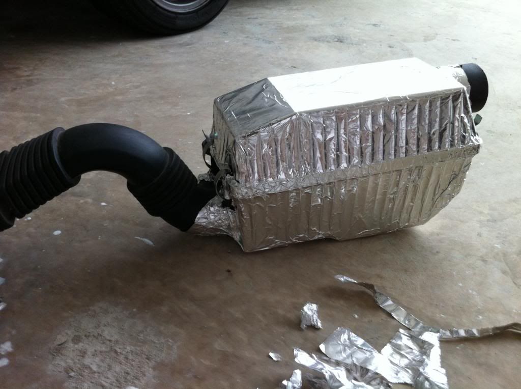

post Nov 28 2013, 11:25 AM
9 posts
Joined: Nov 2012
Yesterday, I work through until midnight to setup my open pod...finally got it installed....I wanted to do some test between drop in and open pod. It terms of intake temperature. I ran the POD without any CAI
After installing the POD, induction sound was much louder when throttle is applied. Power gain? Need to use Dash Command to run test to verify.
This morning, my test was more focus on intake temp. When on stock air box. The intake temp when the engine is fully warmed up and driving is around 43c give and take. When stop temp goes up until 46 give and take. When the car is moving the temp will have a constant of 42c +- at speed of 80 and above.
With the POD, i notice a drop in intake temp at speed of 80 and above. Temp taken this morning was around 38c +- BUT when the car stop at traffic lights the temp goes up pretty quick until 46~47C but once the car start to move back the temp drops down pretty fast. A strong jab on the throttle makes the temp drop another 1 to 2C.
NOW, I'm not concluding that Open pod is better but I notice with a POD the temp fluctuation is more noticeable then when I was using the stock air box.
On power wise, my initial findings, is that Mid range give more pull RPM from 2.5K until 5K was the most obvious but at 4th gear from 5K until redline seems a slow to me....This gives me an impression that it has narrow down the powerband. Compare to the stock air box.
Now, my findings is telling me that aix box has the best overall powerband as it's wider = more usable power range for daily drive. The powerband of the POD i believe is only useful for track (depending on track also) since most of the time the rev will hover around that area.
Since I have my airbox removed, I'm now finding ways to wrap the air box up with cooking aluminium foil. IF I can get the temp to go down as the same like a POD then it will be (killing 2 birds with 1 stone).
Above is my own theory and findings, it could be right or it could be wrong but owners are all welcomed to chip in and join this discussion.
This post has been edited by TitanRev: Nov 28 2013, 11:33 AM

Hi guys, thanks for caring...I went home early and as usual I'm a guy who can't sit still for long time. So I went to my wife lot kitchen and grab a box of Reynolds heavy duty Alu wrapping foil. I end up wrapping my whole air box and the stock intake rubber hose hahahaha....some say it don't do any effect but I still find the science behind it as Alu foil is a good insulator with the shinning side facing out. Because it reflect radiated heat. My point of doing this is not expecting any gain but more to intake temp control and to reduce the air box getting heat soak...what you guys think? I can't seem to find michi formation on this over the web...most they say is use to wrap sandwich

QUOTE(TitanRev @ Nov 28 2013, 07:10 PM)
Let us know if it works, I have been thinking how to insulate the airbox but never tried anything. Was thinking of using insulflex but mahihi said will trap heat instead rclxub.gif

QUOTE(dares @ Nov 28 2013, 07:22 PM)
IIRC acc2 basic Sc (learnt in Sec Sch?), DARK surfaces (eg Insuflex = Black) are Good Absorbers of heat whereas Shiny ones (eg Shiny side of Alu foil) are Good Reflectors... tongue.gif
This post has been edited by zeone: Nov 28 2013, 07:40 PM

QUOTE(zeone @ Nov 28 2013, 07:38 PM)
I don't think that theory is applicable in this case, as insulflex is chiefly used in the industry to insulate air conditioner pipings sweat.gif
If you've applied insulflex under your bonnet, you will see that your bonnet won't feel hot after driving as it is insulated from the engine heat.
zeone
post Nov 28 2013, 07:52 PM
A Friend...
784 posts
From: Rice Bowl of Msia
QUOTE(dares @ Nov 28 2013, 07:42 PM)
Insuflex is made of POOR conductor of heat (non-metal) whereas the Alu foil is of metal...which is a GOOD conductor!!
So it finally falls back on2 which feature & how it wld serve the application well...
Feel Bro Mahihi wld hv more tech info on Insuflex's properties...how it is more inclined towards...
Ie as an insulator of heat or as a sound insulator...

post Nov 28 2013, 07:59 PM
A Friend...
784 posts
Insuflex as an Insulator on the inside with Alu Foil as the Reflector on the outside?
Bro TitanRev, what do yu think?

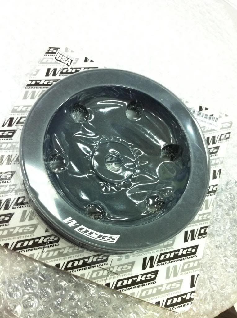

Mahihi
post Nov 29 2013, 12:31 AM
37 posts
Joined: Mar 2006
QUOTE(Eugene91 @ Nov 28 2013, 11:33 PM)
dilemma..
r3apers
post Nov 29 2013, 12:42 AM
225 posts
Joined: Feb 2010
From: Subang Jaya
QUOTE(djhenry91 @ Nov 28 2013, 11:29 PM)
either brake takda makan or i sot zo sudden tekan accelerator suddent fly..haha
Haha, come me join TT u will learn. More.
dilemma..
Soundproofing.
Mahihi
post Nov 29 2013, 12:56 AM
37 posts
Joined: Mar 2006
QUOTE(zeone @ Nov 28 2013, 07:59 PM)
mahihi isn't wrong, it will trap heat unless you have something like STP hood solution which confirms will reflect heat.
the surface seems to be made of aluminum too.
proven as my fenders are way hotted than my hood which is almost always cool to the touch. and after open up the hood you get all that engine heat rushing to your face lol.

QUOTE(Quazacolt @ Nov 29 2013, 08:55 AM)
Applied on my hood too, excellent heatproof and soundproof...but the downside is engine heat up pretty fast, i can judge by the frequency of radiator fan kickin...sometimes when car stop it needs to rotate more than 1 minute in order to cool down the engine compare to last time 30-40s only.
Quazacolt
post Nov 29 2013, 09:07 AM
Riding couple
5,367 posts
From: KL Malaysia
QUOTE(coolkwc @ Nov 29 2013, 09:02 AM)
yeah that's the downside of it since heat is trapped in the engine bay sad.gif
coolkwc
post Nov 29 2013, 09:15 AM
Fall in love with audio again.
3,112 posts
Joined: Jul 2006
QUOTE(Quazacolt @ Nov 29 2013, 09:07 AM)
One noticeable effect is my car hood paint won't fade anymore and no need to wax to keep it shining. thumbup.gif
Pros vs cons, 1:1... mellow.gif

QUOTE(zeone @ Nov 28 2013, 07:52 PM)
Aluminum foil is good heat conductor if the heat is transfer via conduction. Like how u take a metal bar at 1 end and heat the other end and in the end the whole bar will get heated up. Why I use the reflective side of the foil facing out is to reflect off radiated heat. In engines heat is transferred via radiation and conduction. So even I wrap the air box up heat will still be conducted there via the connected point (heat will always move to cooler area due to molecule expansion) what I did is to reduce the radiated heat as much as possible be it on idling or moving. As I have mentioned the test is to control the temp. Just now I went out for lunch and ambient temp was 36c I noticed intake temp with the wrap was around 40c when I reach my place so it has some how slow down the heating via radiation. If u guys notice aluminum foil has 2 sides 1 side dull n 1 side reflective.
I didn't use any glue to wrap my air box and the rubber hose. Just cable ties. If use insuflex, I will sandwich it between 2 layers of Alu foil with both reflective side facing out.

This is how I wrap my airbox and stock intake hose.....I've also used a sanding bit to smoother out the edges of the air intake holes...I found some sharp edges and ridges as common for injection molding...
After did this, park for 1 hour after engine drive start back engine intake temp shows 46C only instead of 49c before wrapping....temp when driving also stable....when using open pod if not wrap the temp gets to 54c when stop engine for 1 hour....

QUOTE(TitanRev @ Nov 29 2013, 07:31 PM)

QUOTE(Maxwell6635 @ Nov 29 2013, 07:47 PM)
Actually I'm using Reynolds Heavy duty alu foil...neh those use for cooking one...hahahaha....soooo see you guys who will be there tomorrow.

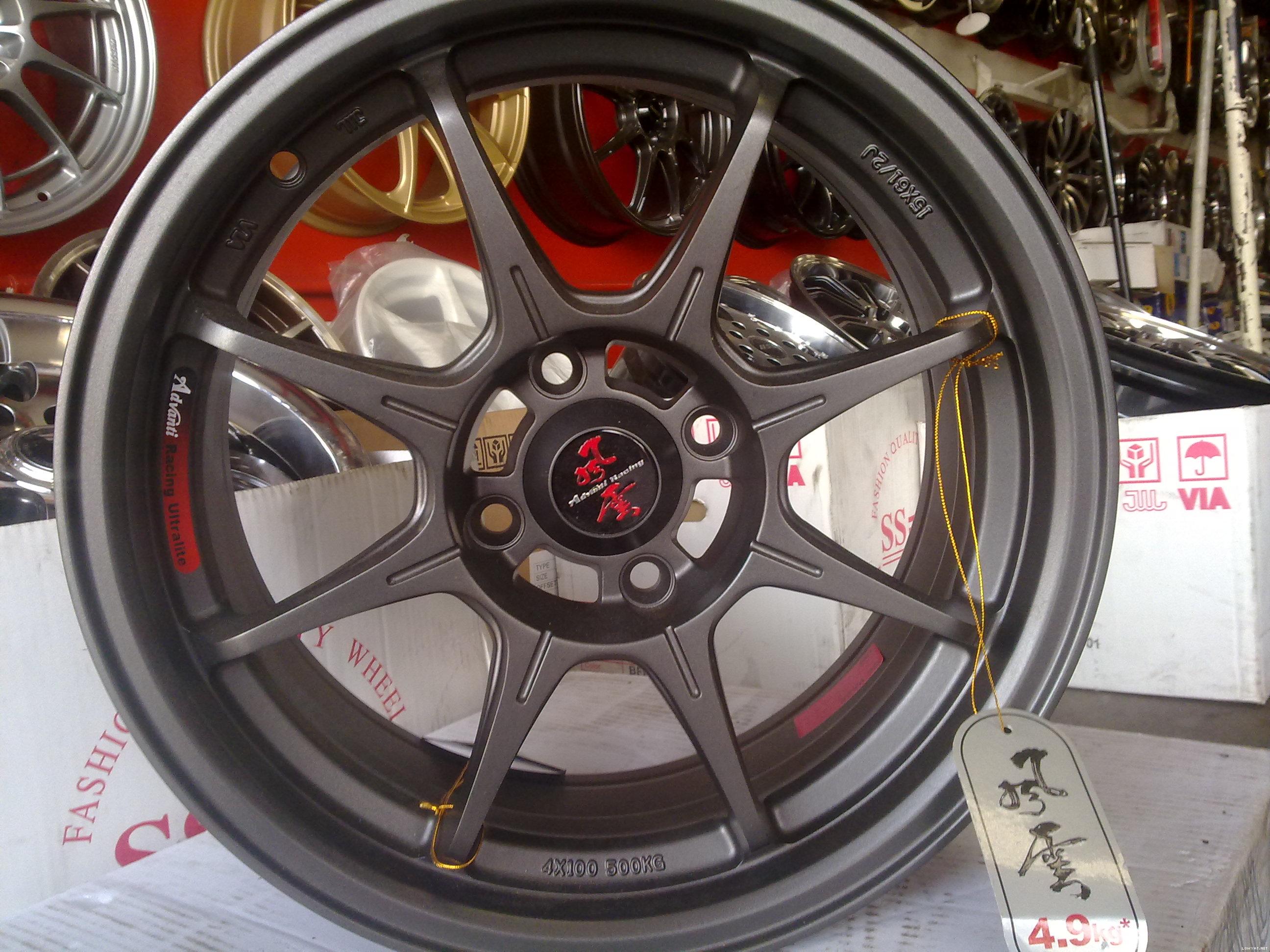

QUOTE(djhenry91 @ Dec 2 2013, 09:50 AM)
1.3 flx exec last week just got my car
ayam plan to change my solid white SV's rims
which size & color is the best combination?
This post has been edited by Predator10: Dec 2 2013, 12:46 PM
dares
post Dec 2 2013, 12:55 PM
834 posts
Joined: Jul 2011
QUOTE(Predator10 @ Dec 2 2013, 12:45 PM)
195/50/r15 or 195/55/r15
I prefer black rims on white car.
Offset I'm not sure, pls refer to sifu sifu ericmaxman kenjilew
Color up to you.
Size ideally 195/50/15 on 15" rims.

Predator10
post Dec 2 2013, 01:49 PM
421 posts
Joined: May 2007
QUOTE(dares @ Dec 2 2013, 12:55 PM)
same here
its either white or black
QUOTE(ericmaxman @ Dec 2 2013, 01:42 PM)
Color up to you.
alright, around how much damaged for new set of 15" rims + tyres
never survey the price b4
