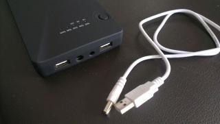

So you are using a non-microusb cable to charge your powerbank?
Could you show pics of the ports on yr pb and your charging cable as well thanks.

Two cable included. One for charging cable in picture. Second cable for 9v 12v output to router size round head.
Will upload second cable image later.Second cable I put at store.

this is second cable for 9v and 12v

Just curious, there are microusb cables rated for 2A or 3A, are there problems using those? I really like the idea of your PB and allowing the user to vary the capacity simply by reducing batteries, but I strongly prefer not to carry ANOTHER cable to charge the PB.
I suppose you could test out the high current microusb cables, since Note 2 and Note 3 already use it, and such quality cables are also readily available.
You may find "galaxy charging current" app to see actual charging current to reveal the true.
The original cable of s4 or note 2 may vary from 0.8 to 1.7 ampere. Note 3 can go higher ampere because it came with usb 3.0. Then it defeat the purpose of having one cable if using usb 3.0 since the less device using.

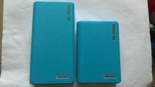

Your opinion is good. And I have 4 cell type of powerbank casing that can charge using microusb .Will sell up on request.
And if you want this with 6 cell casing with microusb I can special modify one for you. Pm me if u really want it. Thanks for your comment .

Actually Note 3 CAN use standard microusb 2.0 cables. See Note 3 thread post 3 ( I was formerly TS and published all the stuff there )
https://forum.lowyat.net/index.php?showtopi...post&p=64618115
I am also familiar with the GCC app and have used it for more than a year already from Note 2 to Note 3.
I also usually carry 2 microusb 2.0 cables with me for charging, so it's more convenient instead of worrying about a potentially lost non-standard cable.
I suppose your charging cable is the 3.5mm type used by normal AD/DC selectable voltage converters right? I do know how to make one but it's still a hassle.

Yup. I using note 3 replying yr post. Just go email alert almost realtime. It speed can par with old netbook with ssd already. Nice.
You are right. My case is once charge and use amost a week without worrying the pb is flats. Practically it never empty if normal using. Tested to light a usb table lamp, it last for a week by 24hoursx7day. It is monster of power. So the charging adapter (ipad 4) with the cable i put at one side. So i never bring charging cable go out.
I mean i can add a microusb port in the power bank for u if u want. To replace the 3.5mm head instead. Just the charging will be slower.

Now can customize battery base on your need. Contact us for more detail

This extra 5V@2A + 9V@1.5A and 12V@1A selectable supply to power an router or other devices.
New!
Power bank with 6 LG 3000mAh ICR18650D1 cell.
Noted: This power bank without charging adapter. It came with usb charger cable.
Recommend using original Ipad/samsung tablet usb adapter. Do not use unknown usb charger for safety reasons.
