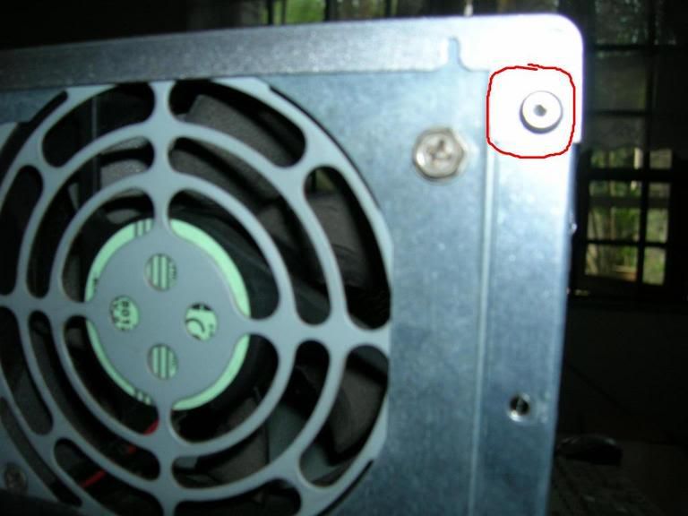

It is stuck inside, and it prevented me from removing my top casing cover.
taking out dead screw

Could someone teach me how do I take out that screw in the picture?
It is stuck inside, and it prevented me from removing my top casing cover. ![]() |

Thats look like a Rivet to me,if u wanna take out that u have to use a drill

Yup that is a rivet and not a dead screw. The only way is to drill it out but you would need to rivet it back again later or use a screw.

Drill at the centre of the rivet and make sure your drill bit is same size as the central of the rivet....too large will spoit the casing as well.....while too small may not able to properly to remove it from the case...
so go around check your toolbox for the right size....or buy at hardware shop for less than RM10... |

if ur worried about making the hole bigger..then u can just grind the top part n then push the rest with a screwdriver or sumthin

try using a dremel to remove the head.
best way is stil using a drill. |

What if I don't have a drill? Cause I don't have one..
Is there any other way besides asking other people to do the job? |

try using nail
hohohohooh tebuk on da middle of tat ting |

Use a flat headed screw driver and try break the rivet head .. drag out with plier.. this will save cost from u buying a new drill
I had this problem when my boss bought 50 used casings. .. darn! .. all of it like this .. using rivet! |

That is not a screw, that is known as a rivet, in order to remove it, you will need to use a drill. But remember to use drill heads that are almost or slightly larger than the center hole, u can get drill heads at abour Rm1-2 |

I have open rivet on my casing using drill. Until now nothing to do. Just let it inside the box.

drill is the only way, for perfect job. If not just file it of or grin it of. Rivet gun is RM15 for not branded type.

1 very important thing no1 else mentioned is DONT DO all that removal work with ure components inside. U never know where the metal shavings r gonna fly n stick to n cause a short on ure beloved rig. Remove everything 1st b4 starting work on it.

If u r vry rajin, mebe can try grindin the head w/ a metal file (kikir besi). Can get for around RM 5
Vervain : There are quite a no of sizes of rivets...so check out 1st whether the size u lookin' for is supported by the tool. Some support 3 sizes, some 4. Go hav a look @ hardware shops urself |

You do relized, that you may not be able to screw/fit it back again after drilling it.
