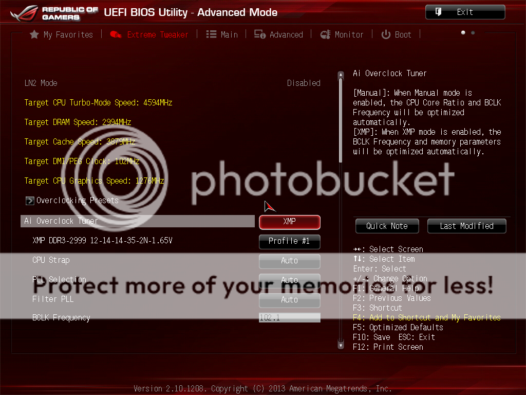

All memory kits were tested by simply enabling the Extreme Memory Profile (XMP) in the BIOS after clearing the CMOS. Maximus Tweak selected was Mode 2 to help overclocking and performance.

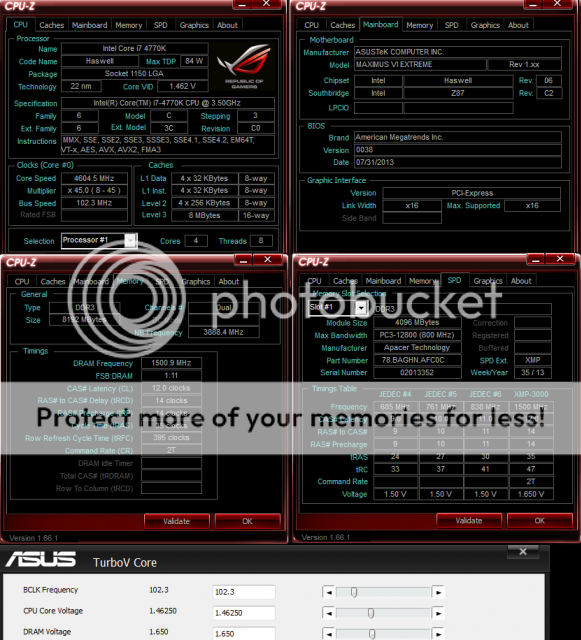

To enable the ARES running at the rated speed of 3000MHz, I used BCLK overclocking so that the CPU core frequencies are as close as possible when they are on the other kits. CPU strap of 100MHz was used instead of 125MHz because the latter will result in CPU frequency to exceed the desired clock by too much and not fair to compare with other kits. The RAM ratio 30x is not working with the CPU strap 100MHz so I had to use BCLCK 102.1MHz and RAM ratio 29.33x to make the memory booted at 2994.6MHz. Then the BCLK was raised to 102.3MHz through ASUS TurboVCore. At the same time, CPU ratio of 45x was used so that the 4770K core speed became 4.605GHz for the ARES benchmarks and 4.6GHz for the rest. Cache/ uncore was 3.887GHz and 3.9GHz respectively.
The overclock settings that I made are illustrated in the BIOS screenshot above.
Then, in Windows I adjusted the BCLK to 102.3MHz so that the final clocks look like these:
CPU clock: 102.3 X 45 = 4.605GHz
Memory clock: 102.3 X 29.33 = 3000MHz
Cache/ uncore clock = 102.3 X 38 = 3.887GHz

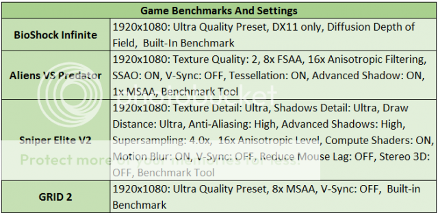

The game settings that I used for the benchmarks:

I used CPU strap 125MHz for this test since it's not meant for comparison with other kits. I managed to stress the ARES tweaked to 3000MHz 12-14-14-25-1T passing LinX without an error in about one hour. This test required a lot of patience and time to get it stable. Moreover, you need a combination of a CPU with a strong integrated memory controller (IMC) and a motherboard with overclocking features in order to achieve stability at this high memory frequency and low voltage.

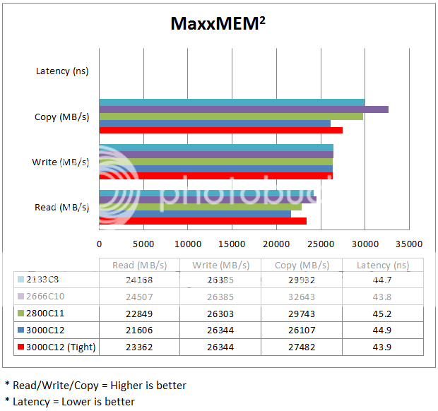

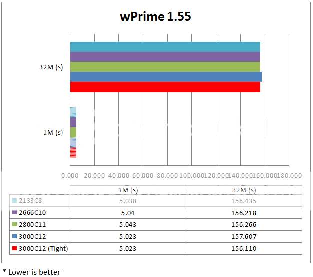

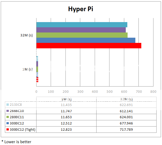

System Performance Benchmarks:
2133C8: G.Skill RipjawsX 2133MHz C8 2 X 2GB @ XMP
2666C10: G.Skill TridentX 2666MHz C10 2 X 4GB @ XMP
2800C11: G.Skill TridentX 2800 C11 2 X 4GB @ XMP
3000C12: Apacer ARES 3000MHz C12 2 X 4GB @ XMP
3000C12 (Tight): Apacer ARES 3000MHz C12 2 X 4GB @ tighter timings but still 1.65v

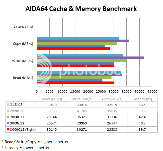

AIDA64 Cache and Memory Benchmark:
MaxxMEM2:
wPrime 1.55:
Super Pi 32M:

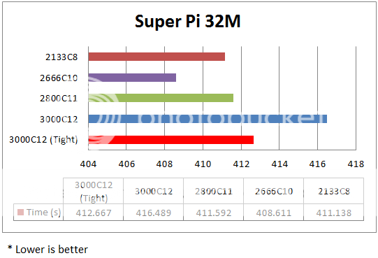

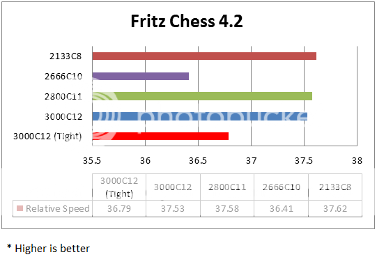

Hyper Pi 32M & 1M:

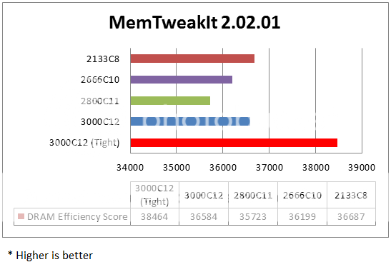

MemTweakIt 2.02.01:

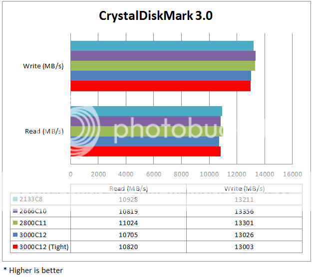

CrystalDiskMark 3.0:

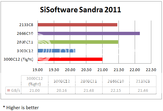

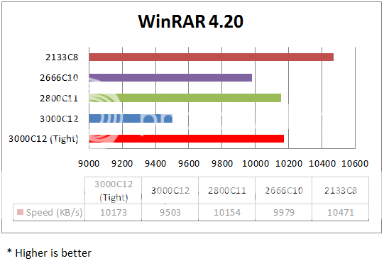

SiSoftware Sandra 2011:
WinRAR 4.20:
TSowikh84
post Nov 12 2013, 09:52 PM
i7 Clan
Elite
8,711 posts
Joined: Nov 2007
From: Butterworth, PG / Machang, Kelantan

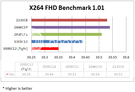

X264 FHD Benchmark 1.01:
Fritz Chess 4.2:

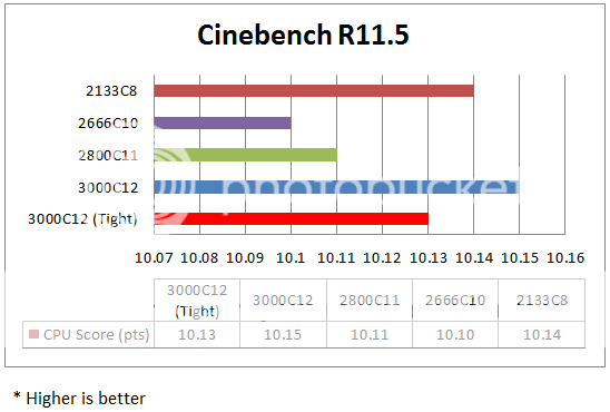

Cinebench R11.5:

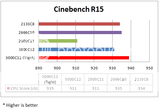

Cinebench R15:

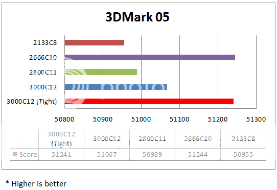

3D Performance Benchmarks:

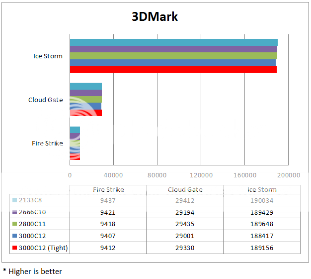

3DMark:

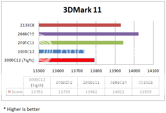

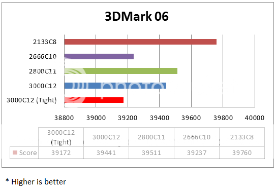

3DMark 11:

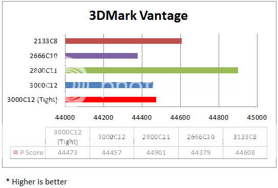

3DMark Vantage:
3DMark 06:
3DMark 05:

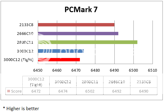

PCMark 7:

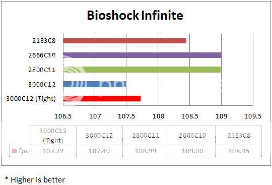

Game Benchmarks:
Bioshock Infinite:

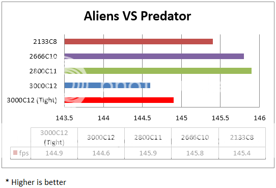

Aliens VS Predator:

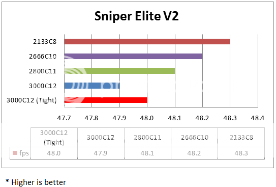

Sniper Elite V2:

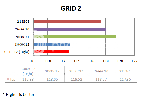

GRID 2:
