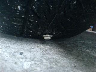

Guys kindly advise what should I do ? blush:
Just discover a naik stuck in middle when pump tyre. Model 175/65R 14
Should I take out & send to shop to tampal ?
Do the car need to perform alignment ?

don't take out..go straight to tyre shop... no need alignment...just spend rm5 only

Go tampal that nail hole and no need to do the allignment

Don't use RM5 repair, it will damage the tyre in the long run. Ask for repair from inside, about RM20 but you don't need to fear air leak out or tyre damage.

You better go and change the tyre now because it's going to affect your performance if you just rely on RM5 tampal. You cant drive faster than 180kph if you tampal, so knowing you, take the advice and change the holey tyre.

Actually if you do the RM20 repair, you can still use the tyre without worry. Water can't get into the steel in the tyre and air can't leak out. Basically same as tyre without puncture.
RM6 repair if prolong use, water will get into the steel and corrosion will occur, that time you can say bye bye to the tyre. Air also can leak out and unless you always check the pressure and refill the air, you might damaged the tyre due to running on low pressure for too long.
