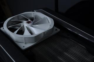

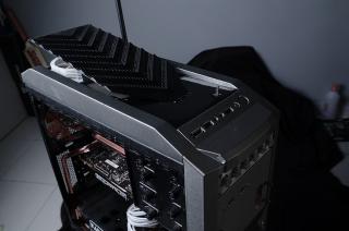

my final image for now, will update if got any changes happy.gif:
