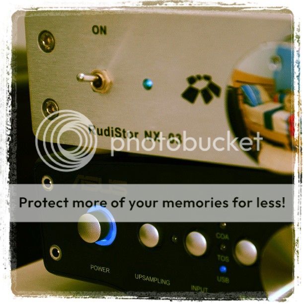

  • ASUS Xonar Essence STX + RudiStor NX-03 + AKG K701
The inclusion of RudiStor NX-03 was just amazing. The leap from STX to STX + RudiStor NX-03 sound quality is jaw-dropping. Of course, the Seenheiser HD555 sounds a lot better as well. The sound is cleaner. Everything is much well balanced now, the mid and bass.

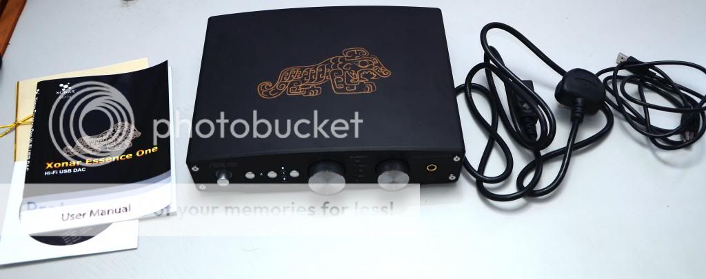

The ASUS Xonar Essence One
Similar to most of the reviews out there, the first impression was pretty shocking after looking at the size of the retail box and its weight. As usual at the front of the box contains the tiger symbol reference to Essence series product. At the back contains all the specifications.
Let’s look what’s in the retail box:
  • ASUS Xonar Essence One
  • Power Cord
  • USB A to B cable
  • 6.3mm to 3.5mm adapter
  • User Manual
  • Driver CD
  • Audio Precision (AP) test report

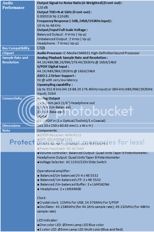

Let’s look at the specification shall we?

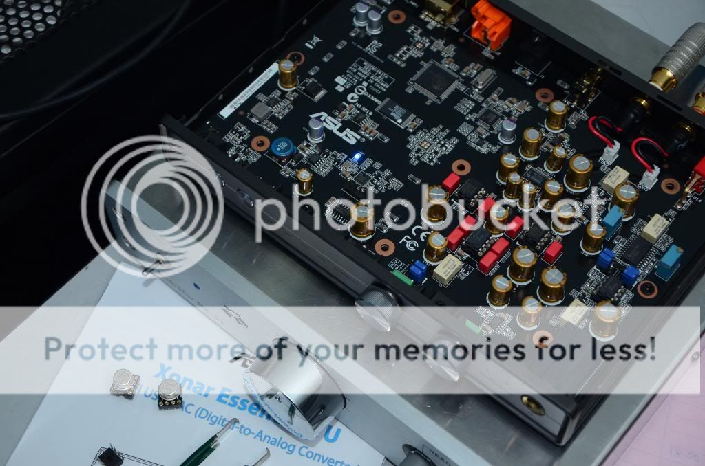

Let’s check out the electronics!
“Teardown” on the ASUS Xonar Essence One shows the components on the DAC & Headphone Amp unit. From the left is the power section, with huge transformer connected to the board. The board will clean and conditioning the power source. At the top right is the audio section which contains DAC, caps and op-amps. Let’s take a closer look.
That is where un-balanced (RCA), and balanced (XLR) output section
  • 2 x Texas Instrument PCM1795 DAC (1 Right + 1 Left)
  • 4 x NE5532 I/V stage (2 Right + 2 Left)
  • 2 x NE5532 Low Pass Filter (1 Right + 1 Left)
  • 1 x LM4562NA un-balanced buffer
  • 2 x LM4562NA balanced buffer (1 Right + 1 Left)

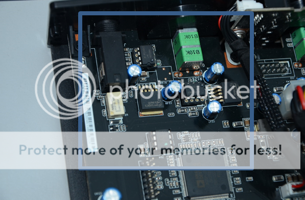

That is where headphone output section
  • 2 x LME49720NA buffer (1 Right + 1 Left)
  • 2 x LME49600TS headphone amplifier (1 Right + 1 Left)

Now, for easier understanding, allow me to show the flow for RCA and headphone output
I’m surprised that the E1 use one DAC for each channel! This is the secret that makes E1 sound quality better than STX! If you want to replace the op-amps, you will need to replace it for both channels. For example you opted to replace I/V's op-amps, you will need four op-amps. Yes, it's quite complicated if you want to find the best op-amps combo which suits your audio taste, but when you are at it, it will be easy!

Stock E1 -> Rudistor NX-03 -> AKG K701
Since the RudiStor NX-03 is a very clean amplifier as well, the result was as expected. E1 + RudiStor NX-03 produced even cleaner sounding. There’s no hissing sound at all. The STX + RudiStor NX-03 configuration is actually pretty near to the E1 by itself. E1 was still a notch ahead because of the power design. Perhaps if the STX is paired with a good external PSU, it would sound great as well.
The sound quality produced now much more refined. The sound stage is also wider. While the characteristics of E1 remains, the only difference was the whole configuration is able to drive the AKG K701 headphone. All instruments now felt very strong! I like the guitar playing. Seriously, E1 can replace STX for the sound quality!! Before this, STX also produced very well sounding, but when I listen to E1, I felt like STX lack of something, that is clean power!
