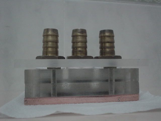

I just did this n the results r lovely. Just to share with u guys. Here's how to bring an outdated CPU waterblock back into use for current sockets n add sum real nice bling bling too.
Here's the old boring block. It's an old AMD socket block.

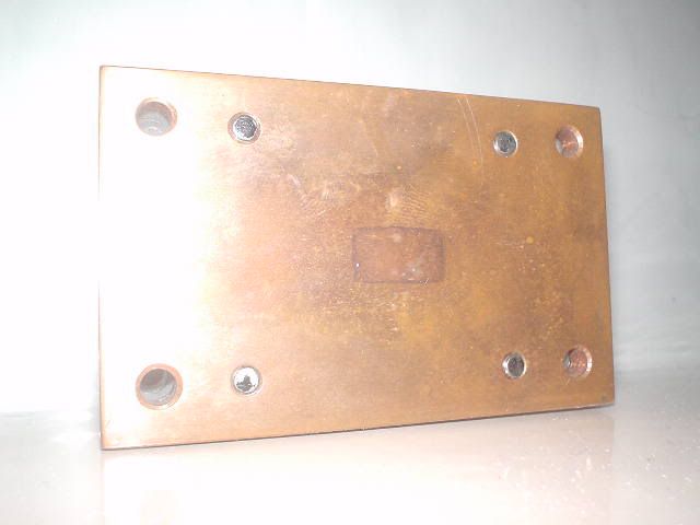

The copper base oso all corroded.

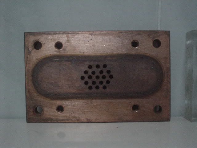

Even the insides of the copper block is all tarnished.

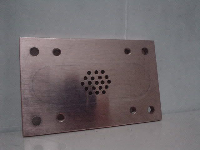

1st thing I did was dissamble the whole block n lap the base with 600,1000,1500, 2000 grit paper then finally autosol. I didn't take pix of this coz it's extremely messy work with hands all wet n black. It's just basically lotsa rubbing rubbing rubbing. Here's the results of all that rubbing.
Base.
Inside of base.
