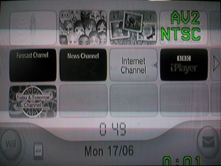

Hi all Wii pros,
Me sister brought home her Wii from UK.
Then we connect to TV, there's display but no color.
Sound is ok.
Try and error different connection on different ports but no color oso.
TV is ok, can watch channels in color.
Physical cable oso looks good.
She said there's no problem when she played it in UK.
There play got color.

Waaahhh, trying adjust but to no avail.
Problem still persist.
Then try set Screen setting in Wii setting.
Picked the 3rd screen mode.
Now blank, cannot see nothing.
Can feel remote vibrate to options but screen oni blue color of death.
Anyway to revert settings to previously?

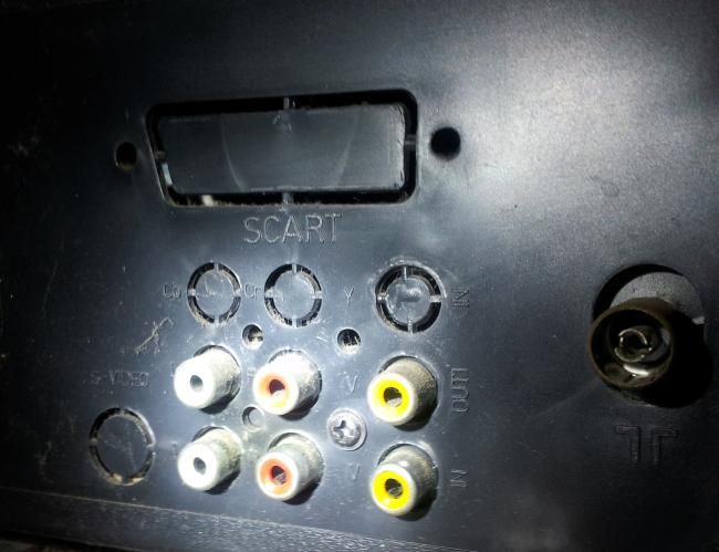

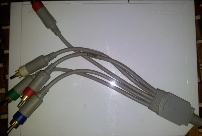

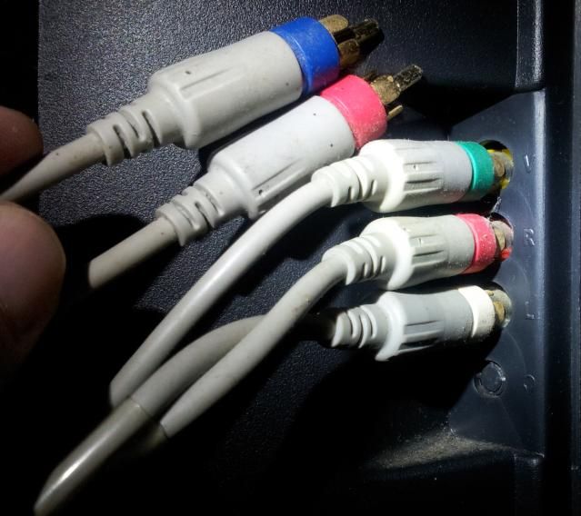

both answers are wrong... there's no problem in the tv settings...
infact, the problem is actually you have the wii component cable which have 5 inputs (3 video, 2 audio) but your tv only have standard 1/2 video/audio input/output & scart. so, you have to go buy a new wii rca cable (that have only 3 cables instead of 5)

Simple my friend. It's all because your Wii is using component cables when you have a TV that only support composite cables.
Solution:
a) Get a spanking new TV
or
b) Buy yourself composite cables!

Wait, don't you have other AV channels in the TV?
Yes, got PAL,BG,NTSC.
None work.

I see you're using component (Red-Green-Blue-Red-White) cables. Those are not meant for your TV. You need to get Composite (Yellow-Red-White) cables. If not, get a new TV that supports component.
Also, I'm puzzled at how a PAL console is outputting in NTSC O.o
