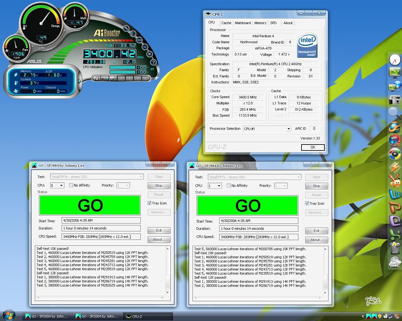

One more thing bout the prime test.. the correct way to stress dual core procs is run two prime95 app in single time..
Select CPU 0 for first prime app and CPU 1 for second prime app..
Untick "No Affinity"..

Hmm, your are not using Prime95 there right?
Just now I put it on test, but didn't use 2 test at once. Will this cause error?
As It return FATAL ERROR in the torture test. But bechmark is fine and quiet up to standard.

that is SP2004..
http://sp2004.fre3.com/download.htm
extract the file into ur prime95 installation directory..
If u run one prime test only actually u just stress one core..
If u got any error dat mean its unstable although u can pass through some 3d benchie app..
correct me if im wrong guyz..

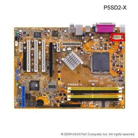

what i mean by 8pin 12V atx is, take a look the mobo layout below.. look for a red rectangle..
this is where ur procs get its power frm..
thats why ur second core got error while first core doesnt in prime test..
both core share the same 12Vrails from one source..
one thing for sure u might need 8pin 12Vatx psu supported as well for that mobo im showing..
40-42 degree load temp for dual core procs using stock heatsink is very odd..
normally it should be 65-70.. dun trust software reading.. touch the heatsink the feel the heat..
This post has been edited by newbieockids: May 2 2006, 09:49 AM

Yea, mine is just 4 pin 12v atx...
But my ATX and mainboard just come with 4 pin.. You mean if to make it stable, 8pin on PSU and 8pin on board.. God I didn't know that....
