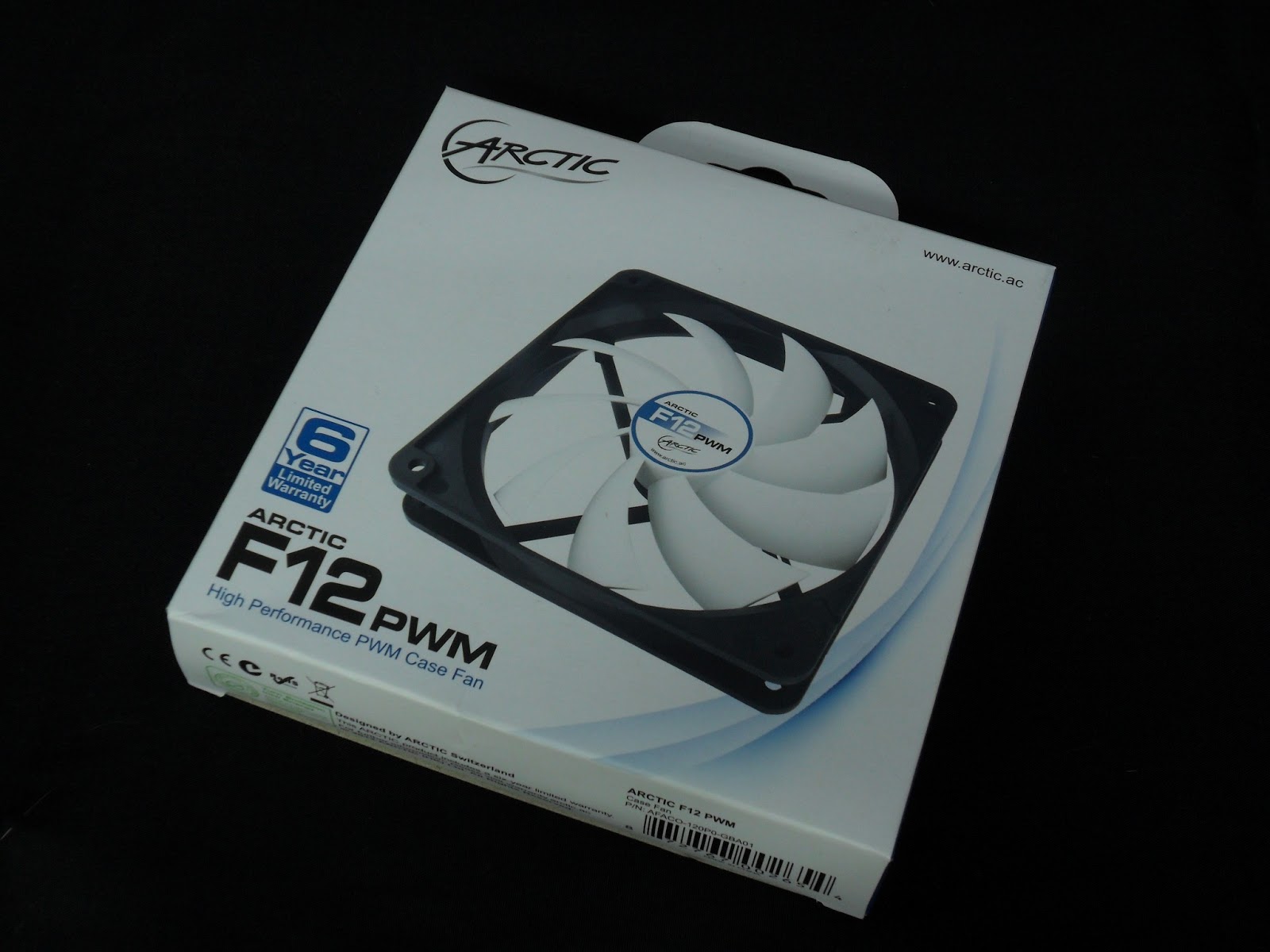

Artic F12 120mm PWM
This is a particularly well-known fan and probably the most used fan in the local forums. Basically it generated such a hype with it's good cooling/noise ratio for a fraction of the price from other high-performance 120mm fans which has caused it to be out of stock in local retails for quite some time.
The box is fairly plain-overall white with an illustration of the fan. The 6-year warranty on this thing will surely outlast a few builds.
Artic F12 View 2
This is the newer version of the F12 with the updated CFM rating. Another nice feature is the PST where you could daisy chain a few of them together sharing from a single motherboard header. If you're like me where there are only 3 fan headers on the motherboard with one of them being PWM, this feature is a lifesaver.
