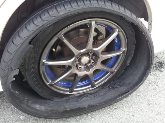

TS, please change the bulging tire before this happen...
Below is tire explosion due to sidewall bulging.

unitron
post May 2 2013, 06:56 PM
W1(R)3d
2,730 posts
From: In the shadows behind you
QUOTE(GoldenHawk @ May 2 2013, 11:21 AM)
Wow, I'm surprised the rims are still in pretty good shape. Lucky you tongue.gif
I used Falkens once & I didn't have a very good experience with them. Had to change them within a year - less than 30K KM probably. They were noisy & fragile.
My Paradas on the other hand.... brows.gif Ended up partially deaf though sad.gif
Luckily rear tire and lucky to be alive... was doing high speed engine tuning that time with my mechanic/tuner and tire exploded at >180km/h
