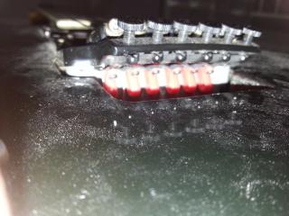

According to Bang Din, seems it's worst and he keep on remind me don't simply adjust the springs anymore. i still remember that's somewhere body near tremolo inner area was crack he told me. but it's not visible at outlook. Sorry for i have no idea how crack was it. i may afraid i am doing more and the worst may lend to me.
here is the springs. not sure i still can add on?

can't see the crack from the pic. usually, if the FR is balanced, changing strings would not require re-balancing unless:
1. you're using a different gauge string
2. you messed up the stringing process. (should change the strings one-by-one)
3. something's wrong with guitar.
can you highlight the cracked area?
but are u sure cannot add more springs? u dont own a screwdriver?
but assuming cannot add more springs due to that fugly block, and since u say the screw cannot tighten more, and that fugly block and claw holder cannot add more springs, then move the springs like this.
that should help abit, if cannot, then u have to send guitar to someone repair the crack.

QUOTE(Everdying @ Feb 14 2013, 07:02 PM)
you're blocking the trem with it? wouldn't that make it rattle like a piggy bank?
