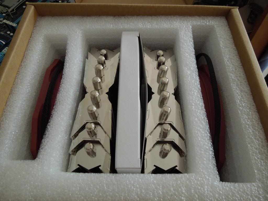

UNBOXING :
The packaging of the cooler is relatively simple compared to others.
But once you open the box, the shinny cooler gets your attention very quickly!

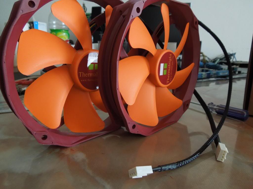

This is the fans' specification from official website above
TY-143 Length 151mm x Width 26.5mm x Height 141mm
TY-143 Fan Speed: 600~2500 RPM (PWM)
TY-143 Fan noise level: 21~45dBA
Fan Airflow: 31-130CFM
The fan mounting hole is the same as 120mm fan holes. Red frames with orange blade.
The fans come with 4 pin header (PWM) so the speed of fans can be controlled by the load of your system
Compare with the older non-Extreme Silver Arrow,
Thermalright Silver Arrow SB-E
Now Thermalright using 2 same dimension fans instead of 1 big and 1 small. The CFM and fan speed increased significantly.
The sleeved fan cable makes it look good inside your casing.

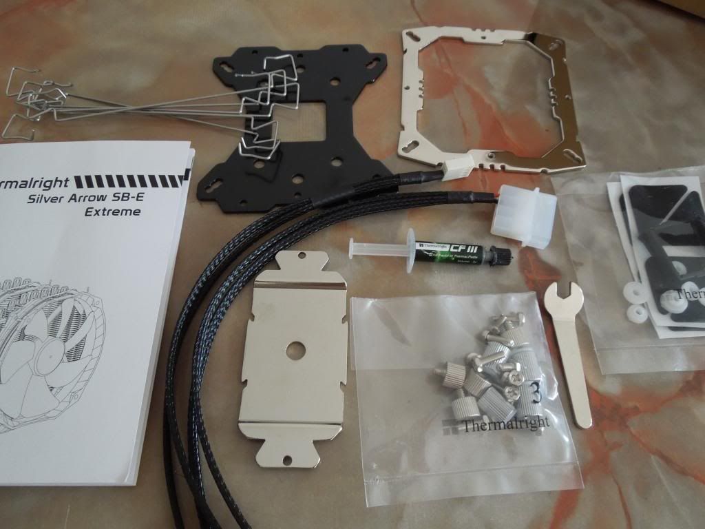

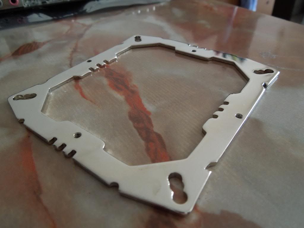

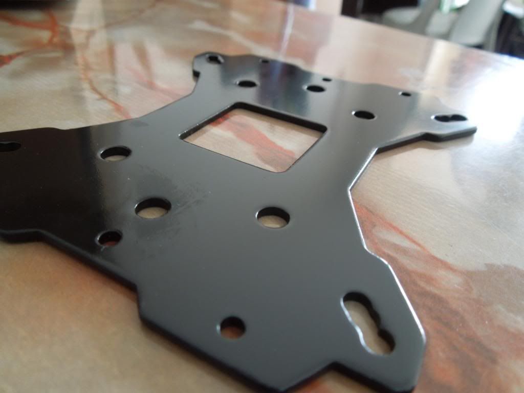

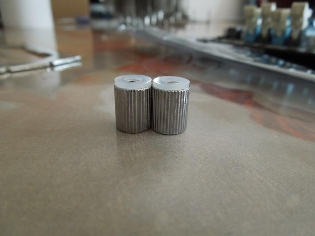

Accessories :
1x Anchoring Mount (Intel & AMD) - Very solid material. Refer pic below.
1x Metal Back Plate - Very solid material . Refer pic below.
1x Mounting Plate - Comes with 'Thermalright' word on top. Shinning surface. Refer pic below.
4x Screw Nut - With rubber at the base to prevent short circuit. Refer pic below.
4x LGA 2011 Screw Pillar
5x M3 L10 Screw
7x M3 L6 Screw
6x Fan Clip - Standard package comes with 2 fans. 2 more clips for you if you are going to add 3rd fan
4x Intel Washer - Current insulating material
4x AMD Washer - Current insulating material
8x Anti Vibration Pad - Rubber to prevent the fans from vibrating and produce noise
1x Backplate Cap
1x Wrench - Very useful tool when your screw driver is not long enough
1x PWM Y-Cable - Long enough for cable management
1x Thermal Paste
This post has been edited by unequalteck: Jan 20 2013, 01:14 PM

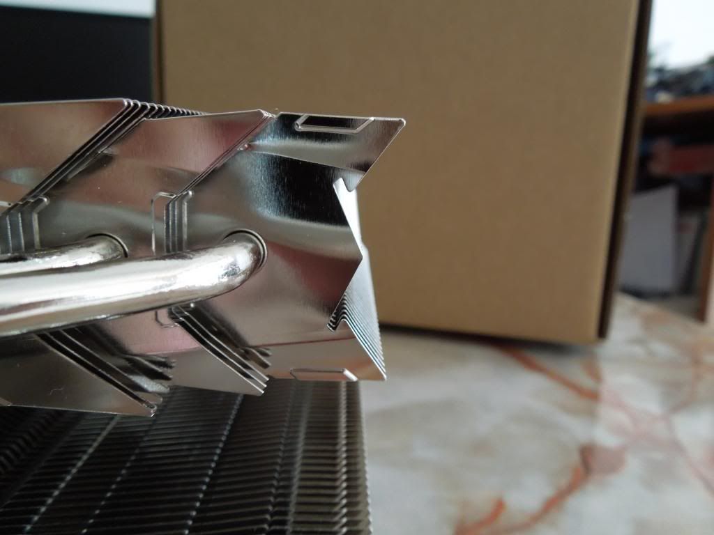

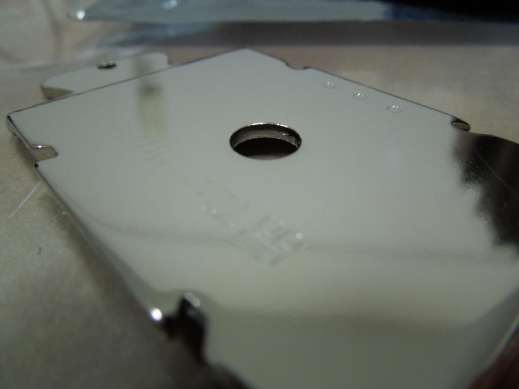

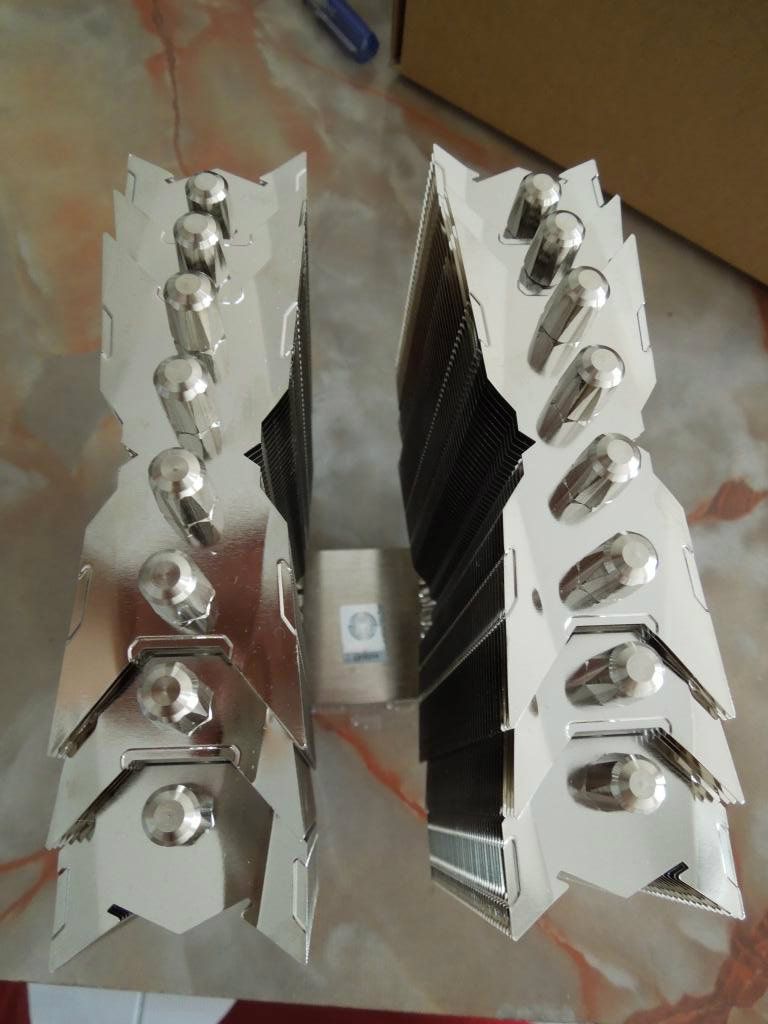

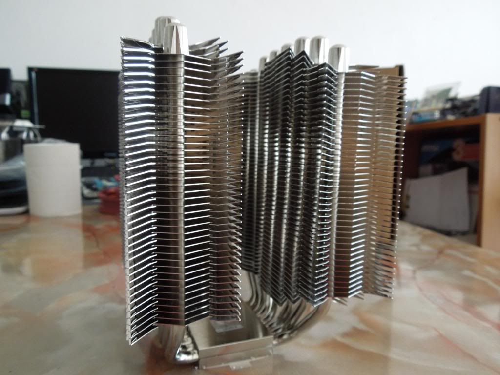

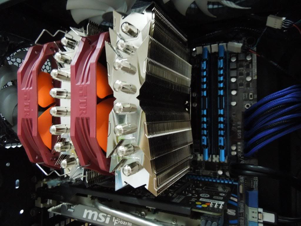

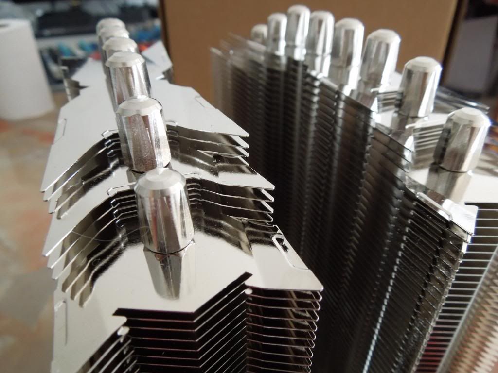

Now here come the giant HEATSINK
Look at the fins of the heatsink. Very shinny surface and very good material.
Good looking design and the finishing was awesome

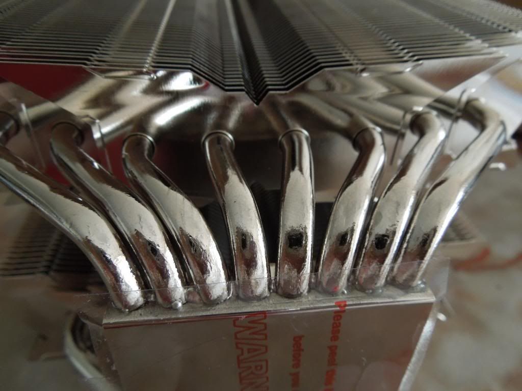

8 heatpipes to transfer the heat more efficient
Shinny finishing and sharp edge. Please becareful with the edge ( not joking, really sharp end )
The bottom of the heatsink. Mirror surface and according to LinusTechTips the design can helps in spreading the thermal compound evenly and puts more pressure on the heat spreader.

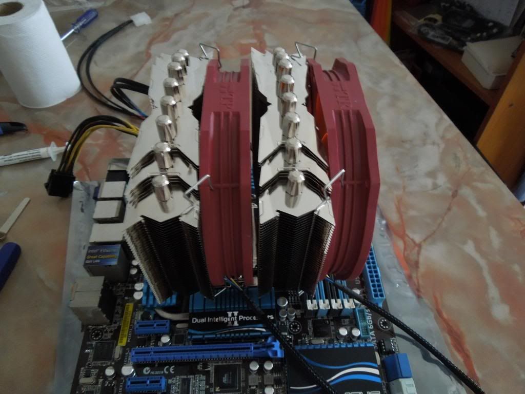

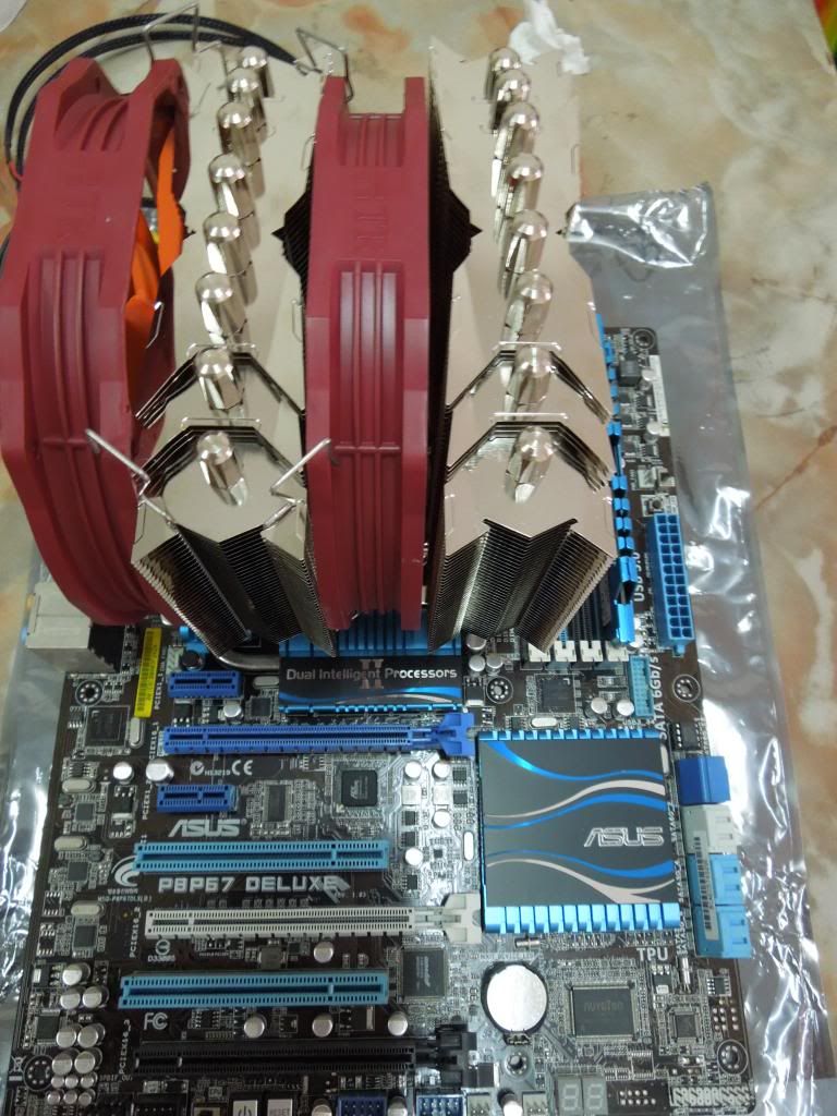

Fixed it on the mobo together with the fans. After installed the fan, you can't see your RAM or even top half of your mobo anymore.
This post has been edited by unequalteck: Jan 20 2013, 01:16 PM

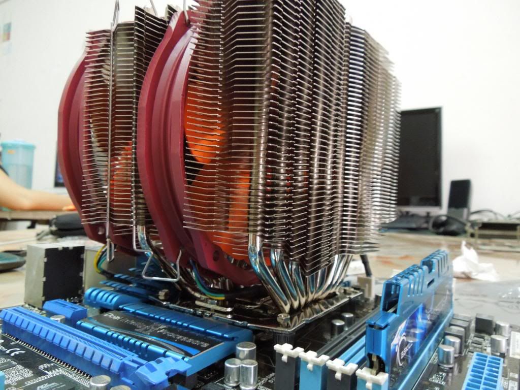

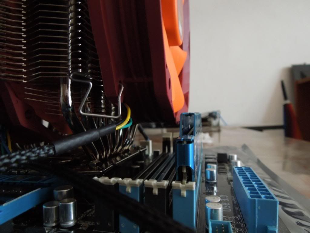

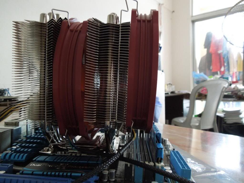

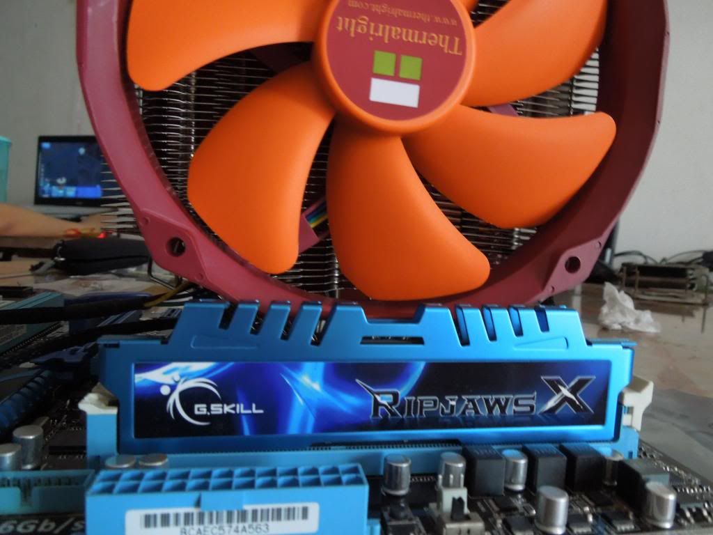

RAM CLEARANCE ISSUE:
As you can see in the picture below, after installed the 2nd fan on the right hand side the thickness of the fan already covered 3 RAM slots. If you're using high profile RAM, you have to switch the fan to the left hand side.
2nd fan switched to the left hand side

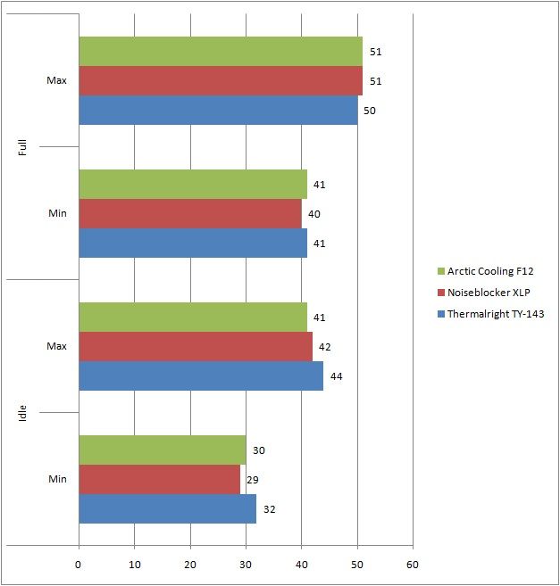

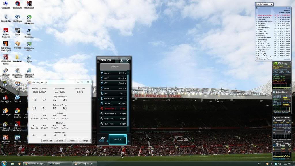

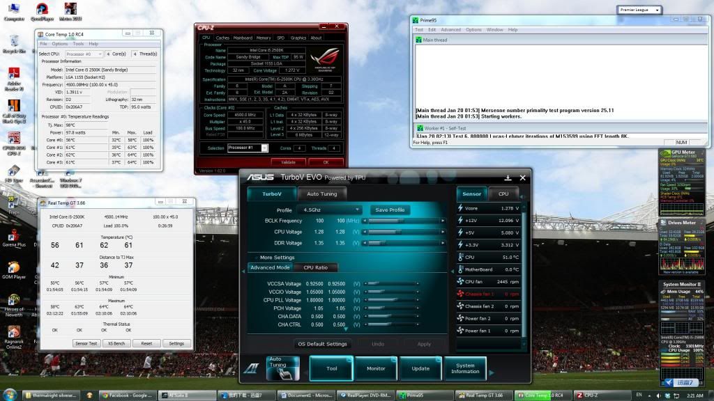

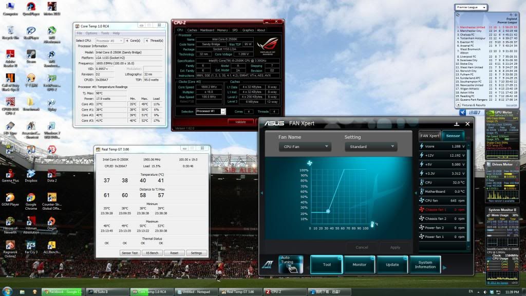

TESTING :
Spec
Intel i5 2500k Sandy Bridge
ASUS P8P67 Deluxe Rev3.0
GSkill Ripjaws X DDR3 1600Mhz 4GB x2
MSI GTX 660 Twin Frozr III 2GB DDR5
Crucial M4 64GB SSD
WD Caviar Blue 500GB 7200RPM
Corsair Carbide 400R
Corsair TX650M
IDLE = Only a few monitoring program running
FULL = Prime95 Blend Test
Room environment with ceiling fan only
Stock Clock @ 3.4Ghz (IDLE) Fan speed PWM controlled
MIN temp : 32°C
MAX temp : 44°C
AVE temp : 35-36°C
Stock Clock @ 3.4Ghz (FULL) Fan speed MAX
MIN temp : 41°C
MAX temp : 50°C
AVE temp : 48-49°C
Over Clocked @ 4.5Ghz (Surfing, music player, office work) Fan speed PWM controlled
MIN temp : 35°C
MAX temp : 53°C
AVE temp : 42-43°C
Over Clocked @ 4.5Ghz (FULL) Fan speed MAX
MIN temp : 50°C
MAX temp : 64°C
AVE temp : 61-62°C

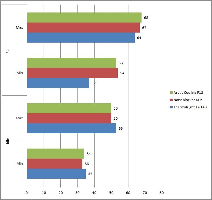

The fan speed plays important role here. In order to get max temp 64°C at full load, I disable the fan controlled option by ASUS AI Suite II. As you can see in the SENSOR tab, the fan is running at full speed 2500RPM +/- 10%. The noise is noticeable at that speed and is quite disturbing. I recorded a video with sound to show how loud is the noise produced by the fan at full speed.
The camera is positioned at 15cm away from the side panel. Judge by yourself whether it is a disturbance for you or not.
I used another 2 fans to do the test.
1. Noiseblocker XLP (1000-2000RPM)
2. Arctic Cooling F12 PWM (600-1350RPM)
Note : Only stock fan using PWM controlled as it is too noisy. Noiseblocker and AC F12 are running at full speed.
