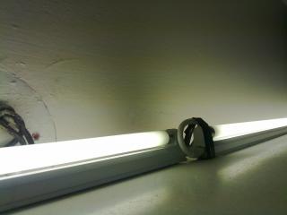

One way to light the place is one one side of the wall, install an Ikea LACK wall shelf. Comes in 2 sizes. 110cm and 190cm. Use as many as needed for one wall. Usually in living room, the whole length above tv as long as the air con is not there. Install it 1 feet down from ceiling. Instead of wall mounted lights, use T5 fluoroscent which can be connected in series without wires. They light up real nice and throw a soft indrect lighting making the place cosy.
Only draw back is the dust that accumulates which has to be wiped once in a while. I do it when changing lights or every 6-9months.
Another way is to use floor lamp lighting. Get those from Ikea. What I've done is to buy two and sacrifice two poles from one of them to make it taller ie about 7 feet or more. The remaining lamp with single pole is used as besdie table lamp or desk lamp. Many ways around.

To illustrate what I mentioned above here's a picture of the Lack wall mounted shelf. Here's two pieces: a 110cm + 190cm for the study.
Closeup on the T5 below:
The below is living room: 3 x 110cm + 1x190cm.
Yes I admint it's dusty. I plan to make custom shelf glass and place on them after cleaning so that only the glass needs to be cleaned instead of the shelf. directly.
T5 connector for the living room:

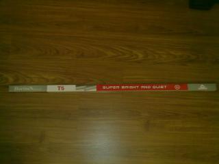

Closeup on the T5 below. T5 is powered by connection point for old wall-mounted lamp. This model from Horizon Malaysia uses a long tube wire flexi-connector :
HorizoN T5 lamps used for the study:
Yes I admit it's dusty. I plan to make custom shelf glass and place on them after cleaning so that only the glass needs to be cleaned instead of the shelf. directly.
Rigid plastic connector for China made T5 used in the living room:
