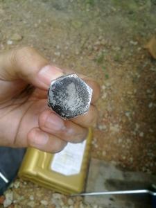

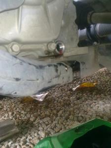

Thanks for all replies.. I did my ATF change last week.
To sum it up
1) Drain screw size is 24mm. Need a socket wrench for this (I was using the ratcheting type)
2) The drain screw is located at inconvenience place - just above the lower arm on the left side (@MR_alien did mention about this). Without proper guttering, the old ATF will spill all over the place.
I improvised a plastic bottle as a gutter
Attached Image Attached Image
3) Almost 5 litres (5 bottles) of SPIII ATF needed for replacement (mentioned by @erictioh). 4.5 bottles of ATF just barely above the HOT mark at 'N'. Refilling ATF is easy - just need to put funnel and pour the ATF in (no need extended funnel)
