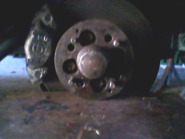

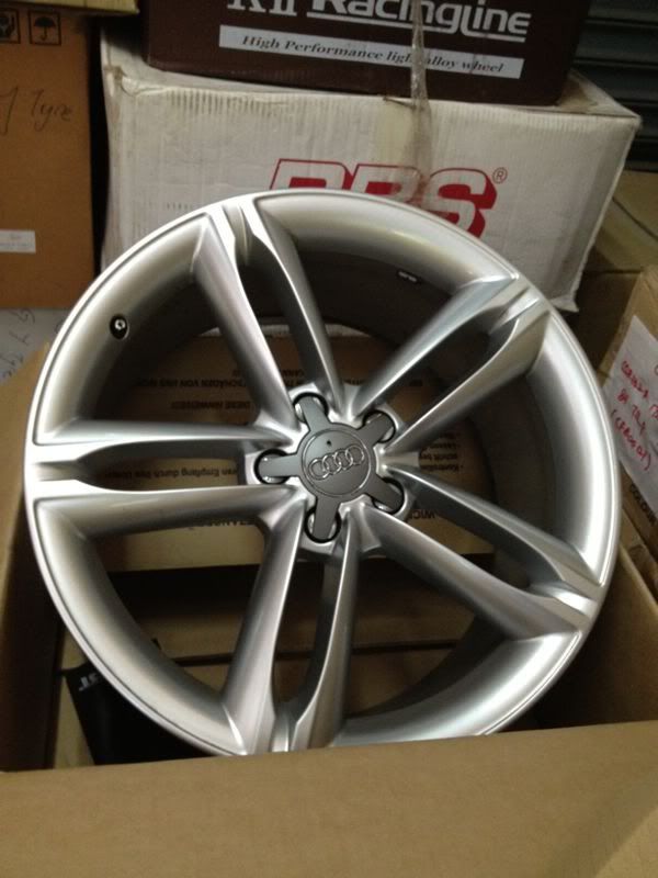

I'm wondering, how people change the rim PCD?
If it is enough space, its ok, to drill more holes.
like this:
but what if we needs to change at the existing holes?
good exemple is 5holes pcd 112 to 5holes pcd114.3
like this:
how much does it cost in Malaysia?

can.. those time when jap rims is still dirty cheap.. people drill hole on rims to fit.. coz those time most of car in malaysia are 4lugs.. in which 5 lugs rims is kinda easy to get.. so they drill another 3 holes to accommodate the 4 lugs.. sure it compromise the strength of the rims in the screw area~ seems those things are never being done again as there are alot of cases where the rim fail on them while at high speed

seen my friend's nissan cefiro A32.
His is a 5 lugs rim. but magically, there is one hole that has another hole drilled onto it.
making his rim suitable for 4 lugs.i am not sure of the pcd, but the rim have a total of 6 lugs.

QUOTE(alpha33 @ Aug 27 2012, 09:42 PM)
6?i think it is more than 6 holes.. if ur talking about 5 to 4 lugs.. the only possible way is using 1 hole out of 5.. in which need to add 3 more holes.. and to do that u need to have the same pcd as such 5 holes pcd 114.3 to 4 holes with the same pcd 114.3.. 5x100/4x100.. my current rims is also 4/5 holes of pcd 114.3.. they usually address it as 9 holes as it accommodates 4 and 5 holes with the same pcd but actually it only hav 8 holes..

For 5x112 to 5x114.3, there is also the option of using wobble nuts (dun laugh)
Many Fiat owners use this due to their uncommon PCDs (98mm i think), but I'm not sure if they can be sourced here in Malaysia
netmatrix
post Aug 29 2012, 08:20 PM
6,735 posts
From: Zion
The fastest way is by using this. An add on adapter.
The hard way is this, drilling new holes on the hub.
The other alternative is to use the whole new hub assembly from donor car. That does not need adding spacers or drilling the hub. Other alternatives is buying the correct wheels so u do not need to get headache about this. laugh.gif laugh.gif
