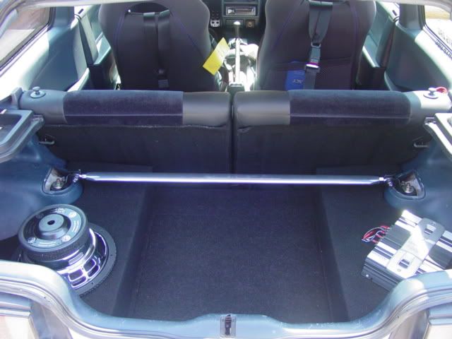

I was thinking of placing my subwoofer in this position in my hatchback.
Any issue that I need to think of? Things that need to be considered? Expected result?

the only thing u have to worry is how are you gonna put stuff at the boot w/o damaging the driver? and oso, where will the spare tyre sit?

I wont be keeping the spare tyre in the trunk.
I might put a grill for protection
.... and maybe raise the floor a bit for better clearance for the magnet
This is just a planning anyway....

it looks unique though.. but since u saz not gonna put anything in the trunk, why not get a wooden box enclosure?

actually... i said i wont be putting the sparetyre in the trunk.... not anything tongue.gif
spare tyre removed so that i can fit the driver that way.
i need the boot space, if i use an enclosure box there wouldn't be much space left sweat.gif

i would say a box or cabinet should sound better. this setup is more likely a freeair. and of course u need a solid floorbed as well biggrin.gif

the trunk floor should be sealed right?
what happen if i make it ported?
how about power requirements for free air subs (is this considered free air or semi-free air?)
what's the differences of free air setup with the magnet or the woofer face exposed?

although i'm no expert, but wouldn't bolting the subs to the car floor will somehow affect the chassis too? slight vibration to the chassis?

the trunk floor would be raised a little bit so that the driver magnet wont be touching the chassis floor. perhaps some insulation might be extra helpful?

I tried this setup before, The bass is not deep enough, but the car vibrate like hell.. it is better to install in woofer enclosure. It will sound better if you have 2 woofers and build an Isobaric (push & pull) box for them.

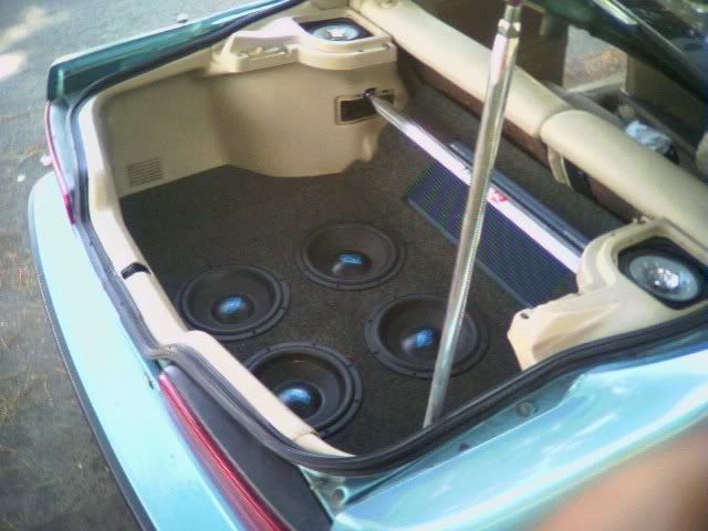

the problem is 2x10" subs with single enclosure already taken up more than half of my boot space, something that i don't want for a daily driven car as i need to put stuffs in my trunk (keeping stuffs at the back seat is not safe.... inviting car break-in theives).
somehow i'm still gathering infos on this kind of setup because there are still autoshow cars with free air subs setups and their stuffs are not cheap. how do they maintain the quality? we know that using expensive brands with crappy setup would be a waste right?
i know having the drivers facing the back seat wont be a good idea, that'd kill the rear passenger.
EDIT: for those who don't know the size of a Civic EF hatchback trunk size... check out the pic above, it's around that size. I need boot space badly sad.gif

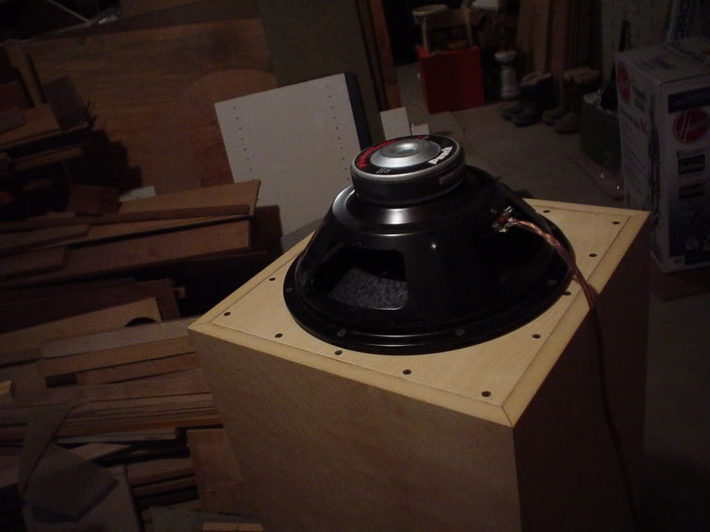

Isobaric won't that up much space, the size of the box only about 1cubic ft. This is how isobaric look like.. you can take it in and out anytime you want, by using banana jack.

can u explain more about the push-pull setting?

QUOTE(soulfly @ Feb 8 2006, 01:39 AM)
aaaa.... 2 subs = one +ve/-ve, the other one -ve/+ve, in other words:
either < < or > >
first sub connected normally +ve/-ve, so the cone move up-down, the other sub outside connected -ve/+ve to give down/up cone movement, so both cone move the same up-down and down-up.... thus the push-pull setting? tongue.gif
but between the two sub connected like <> must be air-tight (some kinda seal between them)
isobaric wont give u twice the power, but, it will save space... 2x8" subs in an isobaric would be the same as 1x8" sealed... Its not really an enclosure type but more like a woofer loading method. wink.gif
