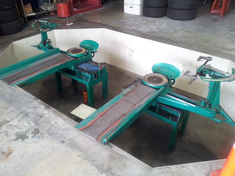

I'm no longer a fan of electronic tyre alignment machines. From now on, this is my preferred equipment. They may charge a bit expensive, but they get the job done.

QUOTE(wideawake @ Aug 1 2012, 12:48 AM)
but how they adjust the rear side?
Nightstalker1993
post Aug 1 2012, 02:34 AM
M� �R�|�
8,930 posts
Joined: Nov 2005
From: Subang Jaya
reverse in?
