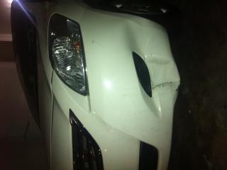

Refer attachment.
thanks a lot!
Vios Front Bumper Dented, Recommendation on what to do?
Jun 21 2012, 11:54 PM, updated 14y ago
#1
1,108 posts Joined: Oct 2006 |
Jun 22 2012, 12:02 AM
#2
276 posts Joined: Jun 2012 From: Orient |
change the bumper? too damaged to knock it up i think.
Jun 22 2012, 12:06 AM
#3
u xperienced? estimated price?
Jun 22 2012, 12:54 AM
#4
1,717 posts Joined: Apr 2010 From: Selangor |
Vios bumper is plastic right? Just push it bak outwards.
Why bother fixing. Waste of money. |
Jun 22 2012, 01:16 AM
#5
1,911 posts Joined: Jun 2007 From: Ang Mo Kio, Singapore |
Rm300, the shop will melt the bumper with the torch to put back into shape and respray
Jun 22 2012, 09:53 AM
#6
it got torn sumore. ppl say when we plaster it, it will go splinters by time.
correct? |
Jun 22 2012, 10:52 AM
#7
84 posts Joined: Jan 2012 |
DIY with hair dryer or hot air gun.
Jun 22 2012, 10:56 AM
#8
4,403 posts Joined: Jan 2007 From: Johor Bahru |
Change to Type "R" bumpers
Jun 22 2012, 11:16 AM
#9
830 posts Joined: Jul 2009 |
What is the material of the bumper? Fiberglass / carbon fiber? Just be careful when using bare hands touching around the splintery area. They can be very sharp.
Jun 22 2012, 11:43 AM
Staff
10,459 posts Joined: Sep 2005 From: Puchong |
Change the bumpers. From experience, heating fix is still not as perfect as new, still can see the difference under close inspection. Depends on your requirement of car detailing.
Jun 22 2012, 11:40 PM
1,008 posts Joined: Jan 2005 From: Shah Alam SDE |
still can repair, happen to my vios last time.. no need to change bumper.. fix n re-spray.. rm200-300 depends on shop..
Jun 22 2012, 11:49 PM
174 posts Joined: Jan 2010 |
Change to TRD bumper lah
Jun 23 2012, 03:06 PM
yeah i did undent at a mudguard shop in kuantan. but dont got time to plaster and repaint so will visit the shop again. i quite confidence with the shop.
only minor torn i think do not worth it to change the whole that will cost around 1k. thank you all.. |
