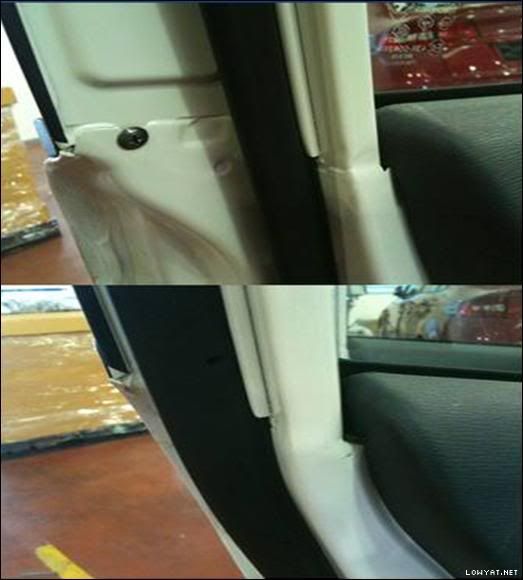

Fail welding is fail.

This means their QC are still not up to standards.

who's the welder ni ... i tot they using robotic arms welder ... err correct if am wrong .. ayam no good in automotive ........

wow... looks like hand welded by indonesian

Nobody will notice much as normally ppl won't tear out the covering or cushion to see what's inside laugh.gif
Robot just only weld some part, some part need done by human due too complex..

as a quality engineer, this weld is acceptable. why waste money doing full weld when u can just tack weld and get the strength needed?
door frame is not structurally integral to the car so it not critical and that weld is probably stronger than the base metal surrounding it.
I'd love to see the welding on other more expensive cars.

ok la ni .. just a welded part ony .... the rest still looks intact what .. still ayam proud with proton ..... .hewhewhew

apsal buruk sgt weld dia hahaha, but i dunno if it will effect the integrity of the car, if it doesnt, then dont bother

Perodua can do a better job at this man.

not structural parts.. welding sikit cukuplah

cant says like tat, even below 40k also cannt accept quality like this
but i doubt the pic car is preve lar.. looks like half cut from other car

itu kan spot weld.....welding paling senang dalam dunia

proton are expert in adhesive not welding

this thing is like the inner part of the car, if the welding strong enough can hold the piece, they why they wan to file off the weld to make it pretty since it is not exterior.. please use some brain, u only see this when u open and close the door, sometimes u dont even see them.. u everyday go check the part at where u open and close door? u too dumb nothing better to do?

this is preve
original

1st - i wonder is that confirm Preve or not
2nd - which part of the poor welding is ar by looking at the pic?

QUOTE(cypher @ Apr 18 2012, 06:24 PM)
yeah, which is poor welding? is no attractive welding consider poor welding? then now i know why malaysian are dumb( singapork ppl owes say so)

QUOTE(homicidal85 @ Apr 18 2012, 06:13 PM)
Alamak... quality engineer can accept this low weld quality. No wonder Proton quality fail tak laku.

QUOTE(ben3003 @ Apr 18 2012, 06:29 PM)
i mean, by looking at the pic, the so called poor welding at which part? door? or where?

QUOTE(cypher @ Apr 18 2012, 06:28 PM)
why dont have a full resolution picture and let us zoom in?
blurr la.
sohai phone take sohai pic
but if u insist

maybe someone with the structural engineering or QC background would say this welding part is enough and more than capable for its structural integrity ...
but for someone with no/less knowledge about this ... when they see this .. i think they wont be so impressed about the things ...

QUOTE(ericmaxman @ Apr 18 2012, 06:31 PM)
blurr la.
but if u insist
i mean take the pic at far and show its original pic and proof that is preve...
coz i cant figure out where is the poor welding is also...
blurr la.
but if u insist
dah try ketuk or bengkok the door? seems like very fragile.

QUOTE(cypher @ Apr 18 2012, 06:33 PM)
It is Preve.
Whether this constitutes poor welding or not, this question is best to be answered by those in the industry.

QUOTE(Kampung2005 @ Apr 18 2012, 06:33 PM)
It is Preve.
i think it will hold well, integrity is there, but just not refine, sakit mata jugak tgk. Im sure if u spent tons of cash, u want ur purchase to be good n refined.

QUOTE(FrostLance @ Apr 18 2012, 06:34 PM)
If it is proven that it remains strong, then it is a non-issue.

super_evil_alien
post Apr 18 2012, 07:24 PM
Slumber Mode
5,105 posts
Joined: Mar 2007
From: In front of my desktop/laptop/phone
Even my mother's new FLX welding is ok.
How come Preve's welding like this?
@FrostLance
But welding in 2nd picture is really bad.It looks like the welding cracked already.

FrostLance
post Apr 18 2012, 07:26 PM
Dr.Frostie
607 posts
Joined: Feb 2005
From: Malaysia
Not SPOT weld but TACK weld.
QUOTE
it looks more like a tack weld to me, spot weld, absolutely not~ spot welds in automotive industry are mostly automated with robotic articulated arms. . .
Engineer friend told me

I just look at pintu Citra mpv, and have the same welding spot but more "kemas"

which parts is that? expose or under rubber ?
n the most important thing. how the rigidity on those part, sometime its look ugly but it do the job in metal joining or rigidity
This post has been edited by Revamperz: Apr 18 2012, 09:07 PM

unless it is not visible .. it is an ugly joint

Putting emotions aside, the picture of the welding when viewed OBJECTIVELY do you think it is acceptable if it is sold overseas?

this is good welding
this shit
blurr la.
but if u insist

But the standard of welding is like shit no?

no need say much. Picture says a thousand word. The welding quality is horrible to end user. it is not acceptable.
Please use metal grinding & grind it before roll out for paint job.

Spot welding
kthxbai
http://www.moparmusclemagazine.com/techart...t/photo_17.html
This post has been edited by heavenly91: Apr 18 2012, 09:44 PM
TSericmaxman
post Apr 18 2012, 09:44 PM
7,951 posts
Spot welding is one thing, but after 25 years, proton still cant spot weld it any better ah?

my company fabricates machinery and we do spot welds when full welds r not required (becoz full weld costs a lot more material, man hours and more skills to make it look goodl )
but generally we always minimize spot welding on exterior surfaces (especially those at eye level after installation)... it works but seeing spots here and there looks shitty... sometimes we spot weld from the inside....
IMO... proton could have spot welded the door and hide it behind the rubber smile.gif

for me, the welding is cosmetics failure.

actually i am curious... most ppl here say it fail becoz of cosmetic reasons or car safety?
if safety, we can always refer to the side impact test results... unless we can get an objective opinion from an experienced car engineer...
if cosmetic, well... tutup mata lar.. 65k... u expect nice nice welding meh

most of the car use epoxy + screws. u cant really find welding on ur fender or thin metal sheet.
this shit
and what do you know about welding ???
there a reason why not to weld the whole thing
you simply simply say shit welding but i doubt you cant even know how to weld

Welding not easy yo
Last time I do it for my laboratory my hand keep shaking.
Crazy.
But Proton use machine.
And I remember the textbook got say for beautiful outlook USUALLY manufacturer will HIDE the ugly weld.
Looks like Proton don't give a shit

i am not basher nor supporter, i've been working in 1 of the reputable local assembly plant for Japanese vehicle before.
judging from the photo, i may conclude
1. yes it is spot weld, nothing wrong with that.
2. the quality of spot weld is not acceptable by JIS body shop standard (pre assemble the metal part before send for paintworks)
3. 1 of the photo clearly shown misalignment of the 2 panels, should the panels involve mechanical movement, ie window glass railings, this may distort the movement thus case premature power-window issues.
4. the poor welding finishing may cause water ingression and develop rust in future (as you can see on top right photo, there might already be some rust mark there)
Just my 2 cents. Hope that proton can improve in this
blurr la.
but if u insist
1st picture = welding pass
2nd picture = welding fail and also QC fail , i cant believe proton QC will release the car like this
3nd picture = welding pass (2nd grade) , welding location abit low and temperature too high
4th picture = welding fail send back for repair , that why you see 2 time welding on the same place.

weld is good, it's tact weld, but the only fail side is finishing .. supposely make it more nice by grinding..

QUOTE(PVCpipe @ Apr 18 2012, 10:58 PM)
compare la car wielding bro....  compared dengan wielding binaan/bangunan x aci
i know its different kind of welding, i know i didnt know how to weld but i did learn it before this and do my own weld.
- if want to use spot welding, at least make the finishing is good, not like that picture look already rust and not even or center between the metal joint, how the hell it passed the QC?
- dont care about the welding 1st, let see the metal joint, not even align properly, how this pass QC ?
- that joint is very easy to see, why not use different kind of welding, like the full welding, or just use spot weld but with fully closed the space around that area. at least it look proper, and no hole or space, nothing will enter into that like water making the metal inside rusting.
im not proton basher, i just say that proton should do based on wat they want to proof about especially the quality.

got genius said the photos are from a pre-production car..

PROVED the pic is real....just now i go showroom check it out and i point to my friend and got few other stranger join me see the epic joint. Guess it will spread like wildfire soon..haha

Maybe its an engineering concept. When got accident those two metal will seperate and all the impact of the accident will flow from the end of the metal.

its called a SHOWROOM.
PROTON makes the door.
I'll try capture MOAR pics if and when i got the time.

QUOTE(MrSafe @ Apr 19 2012, 01:05 AM)
they try to  make everything perfect.....but still left out something which is visible to eyes doh.gif
thats not major thing,but on some cases,i can see the joint are not well-alligned that can pose future problem like rust build-up
overall ,its an eyesore

i notice this one too... but does this effect the car safety ???

According to insider news, they have clarified that the picture was a pre-production car. They admitted they had problems with the panel but it has been rectified before the launch. Basically, this picture is not of the test drive car! #newpreve #MalaysianDrivers
https://www.facebook.com/photo.php?fbid=249...7&type=1&ref=nf

hmm didnt know we have a lot of engineers and experts in lyn. (for those that do not understand this is sarcasm)
i'm no fanboi, but bashing like this is unfair. Would be better if there's actual test done or any citation saying this weld would effect the integrity of the car.
(Such as part of the door flying out when driving 120kmh)
in my understanding the door is one of the crumple zone refer this diagram
user posted imagehttp://www.bbc.co.uk/schools/gcsebitesize/science/images/ph_forces08.gif
the blue lines are the chassis; now the integrity of the car depend on this. IF a kapcai can damage the chassis (blue line) than by all means please bash.

is not the crumple zone, it is the work standard and quality rendered!
potong phail is phail!

anyway... back to topic, if it is a safety/quality issue, then we can only trust those independent testing on the side impact, unless u r a qualified car engineer...
if it is a cosmetic issue, then ya... proton needs to buck up... it works... but looks ugly sweat.gif

Stupid nia waste my time to go see the welding. Size of a pimple only can stretch the picture to the size of a fist.

the welding job is bad compare to forte vios city

Preve Spot welding
Cheap cap ayam korea car Spot welding

Plus, its big so u guys can clearly see the difference of quality in spot welding.

korean car wielding better. no lubang & rust.

zz i just went back to see the wielding part,its damn small yo,the picture look so big wan....

I checked already.. The welding point is actually common.. even Hyundai Sonata also having this welding point. So it's nothing new. Later I upload the photos of both Sonata & Preve welding points.. The only differences.. Sonata more welding metal & workmanship abit better than the rough Preve welding.. Nothing wrong wth it smile.gif

Actually I checked both the showroom car & the test drive car.. The test drive car having better welding almost similar to Sonata but the display unit abit rough & less welding metal..So I think, it's not robotic welding but man-welded job & thus differences between cars are very obvious smile.gif

Here. Most cars also having this welding point. So it's not uncommon.. Only the quality of welding diff story.. One better than another.. So when the earlier photos saying Prevelike 1/2 cut job is not true.. other cars also having similar welding ponts :

That's secondary.. But earlier, the whoto of Preve welding point is just to paint an incorrect picture that only Preve having 1/2 cut style welding and no other cars having this welding point biggrin.gif

Lol the joint is normal but if u look closely the sonata's joint got silicon type sealant at the gap and does not show any holes.

Again, it's not about the quality of welding but the fact other cars too hv the welding points. smile.gif ..Earlier, somewan trying tio paint he fact that only proton using cantum-cantum game

based on the diagram, what i'm trying to say the welding of the door does not affect the structural integrity of the car directly.
that is all. btw the door is supposed to crumple when collided. to absorb the shock.

so far i don't have any doubt on the integrity of the welding.. but it is ugly.. looks cincai .. they should cover it nicely

owner report they have better welding finish. So, Proton heard the complaint.

exactly what im trying to say, not life threatening (this apply to all cars)
but yeah appearance wise it is ugly, and its quite obvious compared to other cars that uses the same technique
(people never really noticed this with other cars)
