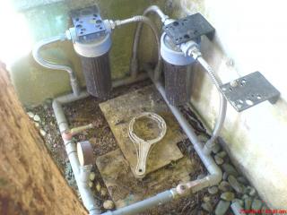

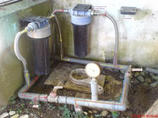

Hi Jin,
We are out of topic. Anyway a promise is a promise, see pix below
Attached Image click pix 1 to see waterflow direction on the pix
From the pix you can see there suppose to have 3 filters but I cut off one. 2 is enough. I also have a pressure meter installed to check water pressure how much it drop when turned on taps in the house. usually drop less than 10psi from 40 to 35 or from 60 to 55.
The filter is 3/4 inch pipe female, to connect it to the flexible hose I use a reducer to 1/2 inch male. The reason I use this type of stainless steel flexible hose is because the diameter is as big as the copper tube and will have better flow if I were to use the normal cheaper flexible hose. Look at the pix below and compare.
Attached Image Attached Image
