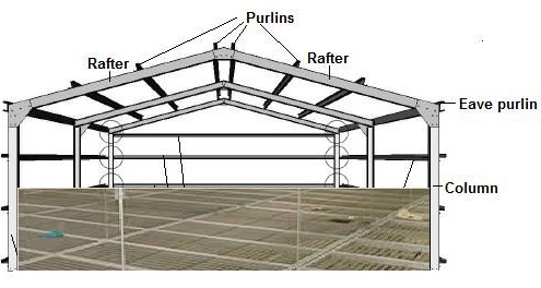

What are the best options to secure house from rooftop intrusion?
1. adding wood or steel purlins to narrow the gaps
2. using zinc below the roof
3. wire mesh just above the ceiling
This post has been edited by MGM: Jun 20 2019, 01:08 PM
