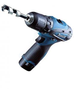

Just to share my new toy Bosch GDR10.8.
just to share reference size between 226(nearly same size as 2470) and small impact driver brows.gif
Attached Image Attached Image

Thank you for your power tools' pictures. smile.gif Great matching combos smile.gif

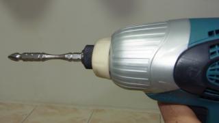

Some fun with my impact driver. BTW, the screw driver bit was VERY HOT. If you want to try this at home, please wear a thick leather gloves.

smile.gif ... No la.. I am not a scout, just remembered what I learned in history text book, many-many years ago. smile.gif
That just demonstrate that misuse of power tools can be very dangerous and hazardous. I hope I can show something new next week. smile.gif No promises... Stay tuned.

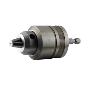

older technology, NiCa which need more than 1 hours
You mean this type of chuck ( 1/4" Chuck ) :
I get the picture from lelong.com.my
QUOTE(totally_skint @ Feb 25 2012, 10:42 PM)
Can we use an impact driver for drilling?
I think I saw a special drill kit for use on an impact driver.
Anyone try it?
Sure can , but the drill bit a bit difference , it must have 1/4" hex shank because the Bosch Impact Driver only come with 1/4" Chuck. But the drill bit also more expensive compared with normal drill bit , I bought the drill bit before and just few hardware shop selling it.
The 1/4" Shank Drill Bit :
Or you buy 1/4" Hex Shank chuck like what Eng_Tat Mentions.

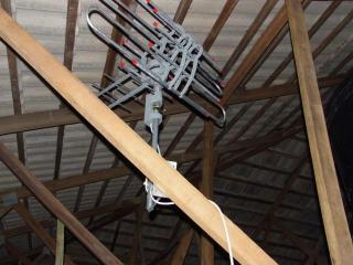

Last time I installed an outdorr antenna IN the roof, yup, NOT ouside, but IN the roof attic. I mount the pole holder to the roof supporting frames wood with screws, using the corded impact driver.
how's the signal quality ? won't it drop since need to pass through the roof tiles ?
TSbahathir
post Feb 27 2012, 11:31 AM
1,200 posts
Joined: Jan 2009
QUOTE(JinXXX @ Feb 27 2012, 11:14 AM)
Since the antenna has built-in booster, the signal reception is fine and as good as any outside antenna. A good thing is, it last longer because it is not exposed to heat, sunlight, strong wind, rain and bird's dung smile.gif.. heh eh he.. The antenna syustem also can rotate remotely, so it easy to get better signal. Since is not outside of your house, it make more aesthetic looking house. smile.gif

QUOTE(bahathir @ Feb 27 2012, 12:13 PM)
I;ll check it out later.. or I may take the picure of the antenna in the roof attic. smile.gif
Sorry for the delays... smile.gif Here is the picture of the antenna mounted in the roof's attic. smile.gif
I am using PVC pipe as the pole/mast. Easy to cut to the length I wanted.

Has anyone seen this Makita keyless chuck locally?
Makita 763198-1
Or any good equivalent.

Here are my impact driver's bits collection.
From right
1) 150mm P2 (Phillips #2)
2) 85mm P2, Makita Torsion screwdriver bit
3) 50mm P2
4) Makita Hex bit holder, 2,5mm P2
5) Hex 4mm
6) Hex 3mm
6u) Square bits, Stanley brand
7) Hex -> socket adapter
7u) Socket wrench, 6mm - 11mm
8) 10mm nut setter
There are several other bits type which are not shown here.
What is this?
Here is the a beautiful screwdriver bit. This is Makita torsion screwdriver P2 bit. The middle part of the shaft is clearly slimmer. This part absorbs the enormous impact force pulse
from the impact driver, by twisting. It momentory absorb the pulse, and like spring, it twist and transfer the smoother impact force to the bottom half. I cannot see the twist in action, unless I have an ultra high speed camera. smile.gif Or, ask Makita to produce the high speed camera of the action.
I like 100mm P2 screwdriver bit, and I already damaged 2 of the high quality bits, which claims 10x longer lasting. In both ocassions, the bit's head broke when I wanted to remove 3 and 4 inches screws from the wood. As I remembered correctly, the bits broke after 10 to 20 times of continous driving in and out into the wood's block. IMHO, the heat from screw driving may has the effect to bit's strenght
I'll try to break the Makita torsion screwdriver, and see if it can lived up to the claims...smile.gif I alredy tried using it briefly, driving 2 and 3 inches screws, and I found it is a bit pleasant. Normal bits tend to stuck into the screw's head, but, it never happened with the torsion screw driver bit yet.
This time I put a cable tie, to see how fast the bit was spinning. I also demonstrated how the TD010F impact driver can varies the power output. Yeah, it seem like a slow motion, but it was taken in realtime. No tricks, just controlling the power using the trigger.
Enjoy
Thank you.

Why is that second screw going fast, then so hard going, then fast again?
Same thing unscrewing?
In the close-up at the end you can see the sawdust jumping around from the impact's vibration. biggrin.gif
TSbahathir
post Mar 18 2012, 02:58 PM
1,200 posts
Joined: Jan 2009
It was hard to maintain the torque. Either I was accidentally squeezed the trigger harder to prevent it from stopping or the friction is lessen when it's start moving. Or, I just tired wasting time to keep it slow and demonstrated it is not a slow motion effect. smile.gif
Good observation. The screw also shredding tiny pieces of the wood.

QUOTE(totally_skint @ Mar 14 2012, 10:22 AM)
Makita 763198-1
I found a smaller version of it, which can take up 6mm bit at ACE Hardware@Mines. Sellery Easy Chuck, cost around MYR20. It can be used for secondary or backup because it may wobble a bit.
Why are there 1/4" and 3/8" hex shank parts?
TSbahathir
post Mar 18 2012, 09:40 PM
1,200 posts
Joined: Jan 2009
QUOTE(totally_skint @ Mar 18 2012, 07:18 PM)
The bigger the shank, the bigger size bits or accesories can be used. There are drilling machines which use bigger shank size for bigger heavy duty bits.
Added on March 18, 2012, 9:57 pmThe mini chuck which I found at ACE Hardware@Mines.
Sellery 11-243
Ref: http://www.sellery.co.id/component/page,sh...id,35/vmcchk,1/
This post has been edited by bahathir: Mar 18 2012, 09:57 PM
totally_skint
post Mar 19 2012, 02:21 PM
1,185 posts
Joined: Mar 2007
QUOTE(bahathir @ Mar 18 2012, 09:40 PM)
Sellery 11-243
I asked because I've seen keyless chucks (online) with 1/4" and 3/8" hex shanks.
Minuscule difference really.
How does the Sellery wobble?
Loose shank?
TSbahathir
post Mar 19 2012, 02:42 PM
1,200 posts
Joined: Jan 2009
The 1/4" hex shank for impact driver has a little space tolerance which the shank/shaft can moves in the impact driver's hex chuck; free playing.
I mean, it is not as perfect as the hammer drill or cordless drill chuck, but, it is still usable.

Talking about but extra bit, i'm looking for socket bit to drive allen screw 8mm
do i need to get socket adapter?
This post has been edited by tyja: Apr 11 2012, 06:56 AM
Eng_Tat
post Apr 11 2012, 09:12 AM
2,215 posts
Joined: Nov 2007
From: Cheras, KL.
tyja, they is two type that i am using one is with socket adapter with small hex bits another is without adapter specially for cordless hex driver. i attach a photo of some of my things that can be used with impact driver.
tyja
post Apr 12 2012, 09:19 AM
-I Just Want To Share-
913 posts
From: Nusa Indah, Johor Bahru
QUOTE(Eng_Tat @ Apr 11 2012, 09:12 AM)
Eng_Tat,
Where do you got socket adapter (the up right one)?

Hi tyja, I got those near my house. it comes in a set of 3 sizes as per photo, 1/4, 3/8 and 1/2" (up right one) its around 15-20 if not mistaken. this is normal unbranded one. if thouse branded one i think is quite expensive.

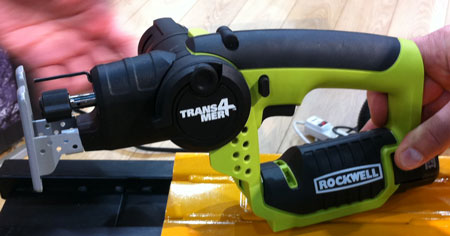

For metal cutting, I use 4" angular grinder, Makita GA030 with cutting wheel. It is more thrilling because, it produces lots of 'fire works' effect smile.gif
Other reci-saw

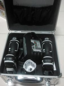

Joined: Feb 2007
From: Uarla Umpur

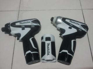

finally something to share..

Congratulation... smile.gif You got the LCT302W, which include TD090WDE impact driver and DF030W drill driver. Nice.. nice.. smile.gif
In impact driver's world, 90Nm is at middle, where the lower torque about 10-20Nm (Makita Penpact or TD020); and 140Nm-170Nm is at the higher torque (BTD144 or TD147). It is not about the torque, but how the impact driver utilize the impact mechanism to transfer all the torque to drive screws/bolts efficiently., as I demonstrated driving screw using impact driver and rotary hammer (substitution of the driil driver). The impact driver also dramatically reducing the hand twisting especially at higher torque, and we able to drive long screws very comfortably and accuratel y without damaging the screws or screw driver bit.

As I said earlier, I just published a YouTube video demonstrating using impact driver to screw and unscrew an electronic appliance. smile.gif
Makita TD0101F impact driver has 100Nm of torque. The torque is enough to break 'high quality' screwdriver bit. In my case, this impact driver had broke two 100mm Vanadium Chrome Steel Phillips #2 screw driver bit, and one of it is is the 'ICEBIT'. smile.gif It also can drive 5" lag bolt into wood without any stress. It seem that, these kind of power seem to be useless for PC repairing which only needs small torque to tighten the screw without damaging the thread. In this clip, I am using Makita's torsion screw driver bit, which is an excellent, tough and durable bit. smile.gif
I demonstrated the impact driver can be used to screw/unscrew an electronic appliance, in this case, my 20 years old digital audio effector, Sony DPS M7. I have open it up for several times for tweaking and replacing CMOS battery.
Scene 1: Unscrew and screw.
This impact driver does NOT have electric auto-brake, the mechanism which stops the spindle to spin as soon as the trigger being released. so, the spindle keep spinning due to the inertia. I let inertia to tighten the screw until it stop. Usually it stopped after 2-4 clicks of impact, which IMHO, gives a good tighten torque.
Scene 2: Close up.
Notice the screw's head. Very little damages, after the years..., which most of the time, I was using a normal Phillips screw driver.
Enjoy.

hey guys
saw this in amazon.. is it possible ??
its one of Milwaukee "Shockwave" adaptor
http://www.amazon.com/gp/mpd/permalink/m1S...ref=ent_fb_link
really so keng meh ?

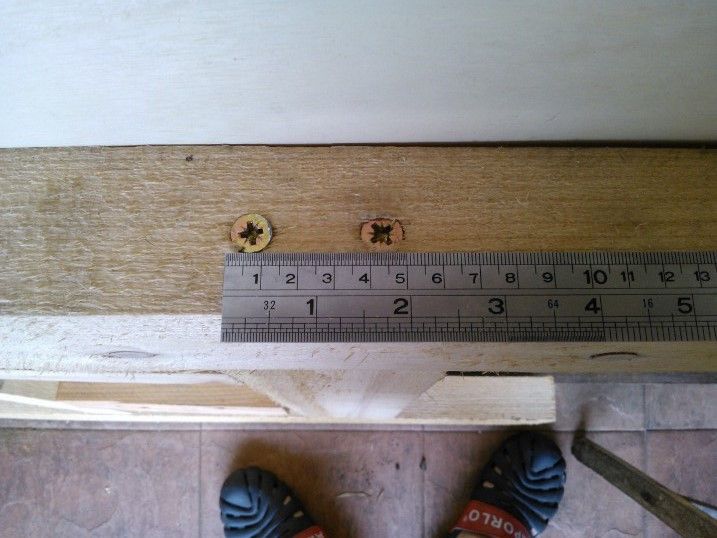

Couldn't stand it anymore...
Bought myself a Dewalt Impact Driver DCF815s2 keeping it in line with the Dewalt line...
Update: The impact driver really compliment the drill/driver. I just finished a portion of my bench project in a couple of hours which i might take more time without this impact driver. Its very easy to use, and slipping is non existance while driving in self tapping screws. Since the switch has variable speed, it is also easy to control the depth of penetration. Thre is no backlash so ni need to put so much effort when driving, except taking care of the alignment of the ttol with the screw driven.
My drill driver is on duty for drilling works (pilot holes) as it holds drilling bits much better than the impact driver. So these two work hand in hand, with much better output and productivity.
My advise for those thinking of getting these tools, go for it, netter still get the combo deal as it is cheaper when bought individually. rclxms.gif

Probably its just my habit, but with pilot holes, I can be sure that my screw goes in at the correct angle that I want it to go. Without pilot holes, one needs to be extra careful at the start of the screwing stage, it is easier with softwood, but with hardwood, i prefer to drill a pilot hole.
Yep, the variable speed switch is a real welcome, this impact tool is a doddle to use, even women can use it as it has very minimal backlash, its just point and screw. And also the Dewalt DCF815s2 has 3 leds which is far superior than a single led, minimum shadows.

Yes, each brand have this chucking drill. Read back previous page in this topic. Even Jinxx cordless makita set is using this chucking.
I prefer the drill type chucking as the drilling more precise.

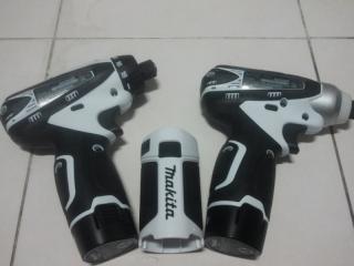

QUOTE(wildrestark @ Aug 29 2013, 02:25 PM)
like the 3 in 1 functions for now. im not sure if bosch , makita or dewalt have figured out this functions since its so convenient to change the bits when you are at higher altitude like roof or fixing pergola.
of cos other brands have these combi drills.
these hex type is mainly on impact drivers only, cos it is more secure, won't become loose.
cos the impact force is a rotating force turning the bit.
normal drill with no impact driving function wont have a hex head.
it all goes down to the availability of model over here in msia that suits the average DIYer,
in terms of feature n price.
amazon sells way cheaper, do u want to buy from amazon?
over here in msia..
i believe u can't find any cap ayam cordless impact driver?
more over combi drills like the one you are having.
so? next will be bosh n makita 2 most famous brand.
makita makes for pro that needs pro features.
the combi tht is available here is a 4 in 1 with impact drill function.
with a huge 18v batt.
a whole set will cost over 2k+RM...
bosch has one available for the msia market BOSCH GDR 14.4 VLI-MF
its rare u hardly see it in hw shops...
with pro features as well like huge batt.
as u can see it doesn't have torque setting/adjustment like urs.
price converted from online, it is close to 2kRM already...
so for us who want a tool that we can afford and can buy from shops with warranty.
there is only this that u r having..
worx have a few innovative tools tht appeals to DIYers like this transforming jig saw,
this one sure makita doesn't have cos pros dun need it, they can afford to have many tools..
DIYers look for versatility at cost that they can afford...

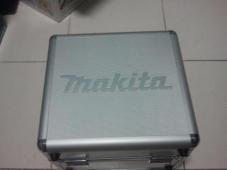

For RM 670, this stuff really look cooler than you think.
it catches some attention as well. the charger with big red Led light on the charger when charge and green when done.
the box is some kind of futuristic laser gun case by Arnold Shwarzenneger in total Recall.. kidding.

QUOTE(wildrestark @ Aug 29 2013, 09:52 PM)
if it's the cordless type, does the makita or hitachi brand came with lithium ion battery? my last check , these battery easily cost more than the old type. This Worx which cost RM 670 has 2 lithium ion battery and cordless. most important is that we compare the same 3 in 1, lithium ion batt 2 pcs , what else... maybe home use range as i think those meant for construction one probably more durable . im not sure  ,but my experience in holding Skil driver really awful due to the weight and poor holding power in drill bits.
he is talking bout the makita set lct302w available in amazon for 157.99USD..
now all tools are using lit-ion, except some lower end ones..
ur previous skil is using ni-cad it is huge the batt thts y very heavy...
there is alot of info posted earlier.. if u read all frm page one.
u should go look for the makita torsion screw bit...

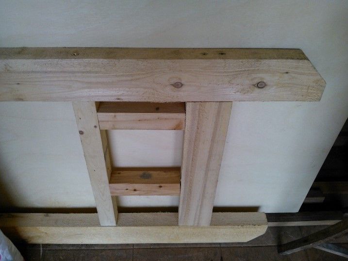

yesterday I pick up a wood pallete from road side, wanted to salvage the wood.
there are screws that go through the wood of 4" thick holding it down to aother piece of wood.
I would estimate the screw at about 6" long with big Philip head (normal screw head 4, 5 & 6 not enough, believe we need 8 or 10) wanted to salvage it also.
Ala, it was tightly screwed, I cant even turn it a little bit manually. I wander what is the Nm force needed to unscrew it. rclxub.gif

the pallet has about 20 pieces of 6" long screws and I want to salvage it for my future use.
Wander is it worth to try to buy an angled screw driver?
yet again I am afraid I will not able to unscrew it, then wasted my money.

QUOTE(H2D @ Sep 9 2013, 05:15 PM)
Can post pics?
See if I snap the photo tonight and watchable, otherwise tomorrow afternoon.
I can salvage things,
1) the screw
2)the wood, it is 3"X4" and more than 6 foots long, got 2 pieces. and 3 pieces of 3X4 and 2 foots long.
I can use the 3X4 to make the clamp for my router, so that I can table mount it. Most of the nicer router bits can only use in router table.
H2D
post Sep 9 2013, 11:54 PM
598 posts
Joined: Dec 2006
QUOTE(ERN2 @ Sep 9 2013, 05:59 PM)
1) the screw
if u can salvage everything.. good,
if can't no choice have to sacrifice the screws... unless some one
ERN2
post Sep 11 2013, 10:29 AM
168 posts
Joined: Oct 2008
QUOTE(H2D @ Sep 9 2013, 11:54 PM)
bro
ya, wonder who has the impact drive who want to take the challenge to unscrew the 6" hmm.gif
here is the picture
and close up with screw
sorry, there is correction on my previous postregarding the size of the wood.
the wood is not 3X4 but 2X4.
This post has been edited by ERN2: Sep 11 2013, 10:31 AM
H2D
post Sep 11 2013, 09:45 PM
598 posts
Joined: Dec 2006
QUOTE(ERN2 @ Sep 11 2013, 10:29 AM)
here is the picture
there is one way ( i think can ) for u to remove the screw...
dun have impact driver .. no prob..
but u still need some tools.
mebe u will manage to borrow...
what ever that is horizontal will give u torque...
This post has been edited by H2D: Sep 11 2013, 09:47 PM
