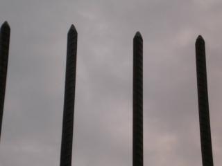

First type is BS type of steel iron for concrete...BS means British Standard. Second is CQ type. If you go to hardware shop selling construction material.. normally they will ask..BS or CQ...if you want to know what is CQ stand for...do ask me..smile.gif...
1.the differences between BS and CQ is the quality and percentage of pure iron inside...the BS steel iron is so hard..compare to CQ (CQ steel iron is a bit 'lembik' and BS steel iron is bigger size...if you want your house stronger and lasting and do not want to crack beam later after a few years....then.....insisted your contractor to use BS steel iron...i m sure they will surprise when you mention BS and CQ...the price of BS steel is higher about RM4-RM5 per pieces. That why contractor do not want to use BS..they want to lower the price with lower quality of steel.
2. I can know by looking at the steel whether it is BS or CQ and what size the steel iron....there are many size of steel iron the lowest and smallest is size 8. There are sizes 8,10,12,16..etc....Make sure for beam and foundation..at least use size 12...do not used size 10...some contractor used size 10...later many years your house will crack..

TS, the rebar diameter can goes down to 6mm.

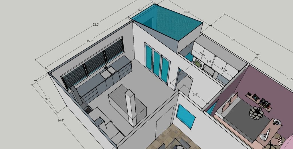

tomjason, i want to renovate my kitchen. i want to expand the kitchen about 5 feet because i have another 5 feet blnce (tanah kosong) at back of my house, so better i expend it fully to the end. so what i need to know about it, because i'm really2 zero about renovation. "tunjuk ajar ku sifu...."

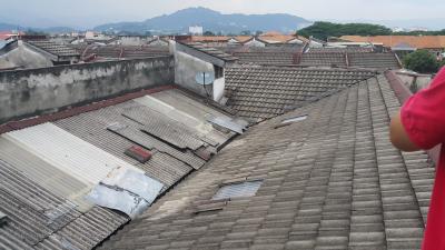

post Mar 8 2012, 02:03 PM
866 posts
Joined: Oct 2011

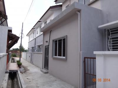

QUOTE(xsaed @ Feb 22 2012, 12:44 PM)
lucky for u TS,
post la some pics of your handywork...
this is reno pic..there a lot more...my reno size 43x23..

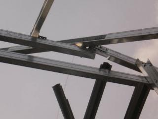

for those want to reno house please use GI trust for roof..stronger and long lasting and anti termite..but a bit expensive and difficult to install unless you had experienced..
This post has been edited by tomjason: Mar 8 2012, 02:05 PM

my renovation size area...my pillar is 12 feets high..

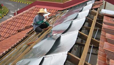

TStomjason
post Mar 8 2012, 04:38 PM
866 posts
Joined: Oct 2011
the most difficult thing using GI trust is to lift from ground to upper beam...if already pro can install the GI on the beam itself.

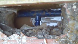

another tip..for roof tile..if want to use biasa2 punya..go for brand such as 'Monier'...around RM 2 per piece...

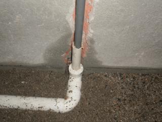

one more thing...for sewarage..please use PVC pipe for under ground color oren Sirim approved as pic below..do not use white PVC...white PVC for rain water can...
one more advise..for sewarage..every corner should have one main hole..this is to avoid clogging...and also the corner must use clay corner..as pic..

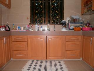

one the photos of my simple KC
i use hood Pacifica..
This post has been edited by tomjason: Mar 19 2012, 04:59 PM

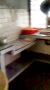

some pic of my KC..sorry i have not tidy up the things on table top..
This post has been edited by tomjason: Mar 22 2012, 08:10 AM

for ceiling.. ensure the steel frame is not not more than 18 inches..this to ensure the strength of your ceiling

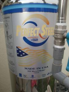

my kitchen door..
my hallway to bibik room,laundry room and kitchen bathroom
TStomjason
post Mar 23 2012, 03:06 PM
866 posts
Joined: Oct 2011
pic while during changed my main meter pipe from 3/4 inches to 1 inches stainless steel.

share my grill pic..the design..i design myself..
tips. ensure that your pipe is not to closed with the grill, so that water cannot splash to your grill later your grill will rust. If you do not have rust grill, before paint, coat it with galvanised.

today tips:
please ensure that the space between roof trust frame is not more than 4 fts, this to ensure that the roof trust is strong enough to support your heavy roof tile.
pic below is my neighbour contractor using small wood for truss, i suppose 2x4 inches. If want better, use 3x5 inches. The disadvantage of wood is termite and wood after years..it will bend.
Added on March 29, 2012, 11:08 amAnother tip:
to avoid any crack after plaster, please wet your wall before apply the cement for plaster. The brick has the strong ability to absorb water, thereofore if you do not wet the brick, it will absorb the water from your plaster cement, cause the your cement plaster premature dry , not normal dry.
These also apply when, cement the 'rabung' for roof. Please cement your 'rabung' not during high sun eg in noon.
TQ

Let me elaborate about this steel trust (kekuda). The steel trust is new to malaysia and to most contractors, not many contractor know how to install these steel trust. The difficulty in technique to assemble and joint between steel is the main reason, but if already expert or experience no problem. To the beginner, to install the steel they hv to assemble on the ground and lifted to the upper beam, lifted the frame is difficult job but with experience, they can install on the upper beam itself. The steel trust C type, to make is stronger, they must clamp together.
Are there strong enough to walk on it at least?
Yes, they are very very strong..when they are clamp together and joint compared to wood. As picture above. They do not bend over time as compared to wood, for wood you will see that your roof will 'melengkung or melendut' over time.
Do you need to ground the frame?
Certainly. You have ground it to upper beam.
Do this frame stand against the rust?
Yes, they are Galvanized to protect from rust
How is the cost compare to wood frame?
The overall cost is abit higher compared to wood, but it is one time investment, long lasting forever compared to wood.
The cost of per piece is not expensive around RM32 compared to wood but they must clamp together consisted of 2,3 piece to become one.
They are joint together using GI screw and if you were to buy loose, the screw cost RM0.08, but if per boxes more cheaper. Every joint between steel at least minimum 3 screw else afraid not strong enough.

For the roof trust, there are 4 elements: the C truss, screw and L joint plate and V type trust (the V type trust is the last layer to put roof tile) as pic attached.
The L plate is to ground the C type trust with upper beam and the L plate also to connect between C type trust.
one year ago the price as i m remember, the C type trust is about RM32 per piece, the V type trust is RM12. The screw is about RM0.08, for metal roof a lot of screws needed, for my house cost of screws only about RM500.

someone ask me, the sample of BS steel, below is the sample my house steel, size 12, if you have chances to see size of CQ steel is smaller and 'lembik'..
for beam, better to make is a little bit bigger, mind is rather small.

This just to share tips during my KC installation. During the KC installation i hv made special briefing to the installer, where the water pipe line and wiring goes, so that they don drill that area. Also i kept my refrig box so that i can cover my new refridge and i also ask they to cover their faulty ladder with box so that they do damage my new tile. Actually, my tile and table top were cover with card box especially their tools.

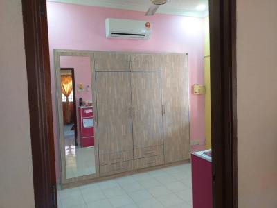

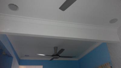

My room ceilling, fan and aircond . Aluminium downlight.
Tips:
1. My Mitsubishi aircond mr slim really slim, the size my 2HP is same as 1HP but cool. Tips, whoever want to choose MR Slim (2HP), the cable wiring is recommended outside,that means power supply to compressor first, then from the compressor board wiring back to the indoor unit.
2. My Fan ceiling is Panasonic, Mini Tsunami. special feature is like natural wind breeze.
This post has been edited by tomjason: Apr 5 2012, 11:57 AM

today tips:
1. attach picture below is my DIY for the kitchen sink pipe outlet. This is the correct way to install the kitchen sink outlet pipe. Please use this type of elbow (using screw) so that when your outlet pipe is blockage with food wastage , you can easily unscrew the elbow and clear the blockage with wire or 'wire ring' that you can buy from hardware shop.
2. From the pic below also, to avoid your food wastage pipe from blockage, use my tips, use at least upvc pipe size 3" or 4" at the last end to man hole, this way your do not have food wastage blockage is future. My design , from the sink, i use upvc sirim approve (thick) size 11/2 ", then goes to upvc pipe size 2", and at last goes under ground upvc pipe size 3" to man hole. Please study the pic in detail.
[Tomjason already deleted the photo attached. Sorry ]...PM me if you want the photo
want more clarification, inform me.

QUOTE(tunemusic @ Apr 15 2012, 01:27 AM)
i would like to ask if the house is already 20 years, is it advisable to change the roof or repaint the roof?
is it nowadays roof is not as good as the old days roof?
if your roof not in bad condition such as cracking etc, better repaint. For repaint old roof tile, to make your paint last longer advisable to remove the fungus on the roof tile first before (the fungus can be remove by spray water jet) repaint else the new paint will not stick long enough on the roof tile due to fungus. It depend on the fungus on your roof tile..if not so bad then can repaint without removing it.
Yes old roof tile is much better than today roof tile..
good luck.

My common toilet pic...just DIY install my water heater on last saturday...
My Joven i70P at common toilet.....my master bedroom still not install yet cause quite busy now...
Below is my shower head..notice the flow of water from the shower head is good...all my toilet without using pump...i hv already mention tip before in the thread...how to have your plumbing without pump...the most important is the pipe size and combination of pipe size..

today tips:
[attachmentid=2787447]
3. For electrical, i would advise to have seperate DB for your house if you are doing reno, such as one DB at living room, one DB at kitchen or one DB at upstair. In this way you can easy manage and easy to troubleshoot in future.
4. If you are doing reno, i would advised you to install power socket and light inside your upper ceilling, And the ceilling power socket and light have switch control from down stair.

QUOTE(meezan @ Apr 19 2012, 09:06 PM)
hi tom
your sharing info is really useful,how about toilet wastage, is that ok to use upvc one. What is the best brand for upvc you can recommended for me..tq
for toilet wastage, it still can use the white Upvc one..but request for Sirim approved (thick one).....but the best is upvc orange SIRIM for under ground....but expensive a little bit...but i would emphasis on this orange Upvc SIRIM else..if still want to use upvc white..please use Sirim approved (thicker).

just want to show my latest DIY of my second water heater joven i70P smile.gif

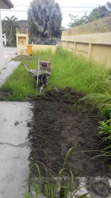

QUOTE(gg8090 @ Jul 3 2012, 10:28 PM)
Bro tomjason,
nice tips from you. Pls PM me special screw for grill? Pls estimate my reno cost for the following jobs:
1.Demolish car porch(18 x 12) inclusive pecah porch/ram BRC & korek supaya level with entrance
2. Buat car porch with built in gutter (25 x 22) tile size 2x1
3.Buat foyer(2 tiang, lantai Pable wash & siling slab) 25 x 6
4. Tembok 80'
5.Extend kitchen 9x22.
If possible, PM me your formula as well.
Below is the pic of the screw/special wall plug:
Attached Image (the pic will be remove later).

18 posts
Joined: Jun 2007
bro,
do you have a name of the grill wall plug? the pic is not so clear.

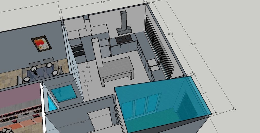

post Jul 4 2012, 03:29 PM
23 posts
Joined: Jun 2012
Its being soooo fun of reading this threat.
hi Tom, need your advise pls.
Am having headache of my kitchen design and planning for renovation soon.
Refer to the floor plan attached. Am thinking of below few options but not sure
which option to choose, can you pls give some advise?
My options / thinking as below:
1. Remove the utility room and extend the kitchen, the utility room is half wall only.
2. Renovate the yard area(beside utility room) become the wet kitchen,
but this will be more cost right? To have dry and wet kitchen saperately.
Not really like this coz the toilet and the room will be very dark.
3. Extend the kitchen till the bathroom window only, so the toilet and room won't be dark
4. Do not do anything at utility room and yard, dry and wet kitchen combine
as per existing.
This is new double story house.
Please also calculate for me the estimated cost base on your advise of which option to choose.

QUOTE(gg8090 @ Jul 4 2012, 02:51 PM)
bro,
i suppose the pic is clear... smile.gif ....if i can remember the wall plug name is 'K Screw'....its the name only got screw..actual no screw just drill and hammer the wall plug...the wall plug and the nail is attached together...but do be careful at tile area do not over hammer else...your tile break...
...after this this will delete the pic...
good luck bro

TStomjason
post Jul 4 2012, 04:46 PM
866 posts
Joined: Oct 2011
QUOTE(ginming @ Jul 4 2012, 03:29 PM)
    as per existing.
hi ginming,
this just my opinion...
actually the first is the budget...if you have small budget go for item 4...the existing kitchen divide in 2 dry kitchen and wet kitchen..but a little small lah....if got budget go for item 3...
my opinion is like this...(this option is if you want to maintain the guest room)
extend your yard becoming wet kitchen...your guest room now become dry kitchen...shift the toilet at back beside the utility room on ...expand your utility room , now become guest room...so you got dry and wet kitchen..you got your toilet share with guest room and wet kitchen..you also got your guest room..
the cost is :
1. to expand the yard (from your diagram if not mistake 10x12 ft) = RM14400 (include all excerpt Kitchen cabinet)
2. Shift your toilet to back RM 2000-RM2500
3. Hack the uility room RM600
TQ
craftsnknots
post Jul 4 2012, 05:15 PM
577 posts
Joined: Feb 2012
QUOTE(ginming @ Jul 4 2012, 04:29 PM)
    as per existing.
Just wondering, if you got with option 3, what is that extra little space for? Will there be a door to the other extra land on the right (behind guest room)? if yes then you cant really put anything at the small extended space. I mean by extending that bit of a space, you will incur wet work cost, tiling and lighting and such, but the incremental of the space isnt much. Just wondering that's all smile.gif

Joined: Jun 2007
Thanks tom for the grill plug/screw.
I plan to have 2nd stainless steel tank place above my concrete slab. Will the water getting hot as it directly exposed to sun?
TStomjason
post Jul 5 2012, 10:25 AM
866 posts
Joined: Oct 2011
QUOTE(gg8090 @ Jul 5 2012, 12:33 AM)
I plan to have 2nd stainless steel tank place above myĀ  concrete slab. Will the water getting hot as it directly exposed to sun?
you are welcomed....about tank..yes..certainly it hot.....if want save money just use poly tank..

ginming
post Jul 5 2012, 03:02 PM
23 posts
Joined: Jun 2012
Thanks a lot for your prompt suggestion and estimation.
QUOTE(tomjason @ Jul 4 2012, 04:46 PM)
hi ginming,
the cost is :
TQ
Added on July 5, 2012, 3:04 pmyah, you are right, me too think that not worth to extend such a small place. Thanks for your advise.
QUOTE(craftsnknots @ Jul 4 2012, 05:15 PM)
This post has been edited by ginming: Jul 5 2012, 03:04 PM

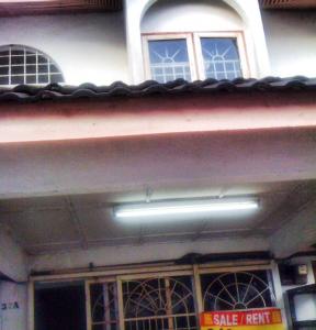

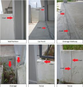

RickOoi
post Aug 4 2012, 02:51 PM
403 posts
Joined: Jun 2008
Hi Tomjason Sifu,
I have been following your thread and noted you are very experienced in renovation stuffs. Appreciate it if you can please help to advice on below. Thank you.
My house is only 18 x 65 sq.ft. (I think) double story terrace with 10 feet land beside.
1) 1st photo - if I extend the back, how do I deal with the manhole (not sure what to call it? Sewage coverage?)? If contractor cover it up or cement it, will there be any problem later like maybe Indah Water want to access it to drain 'shits' from it?
2) 2nd photo - if I extend the back to double-story and side single-story (just the back), may I know roughly how much if I buy all the materials (I don't know the measurements)?
3) 2nd photo - if I deepen the drains (to have a better drainage) and use stone cover to cover them up, will it be very costly?
4) 2nd photo - the fence, I think is only 5 feet (standard allowed?), can I add maybe wooden planks on top of it to make it higher? Is that even allowed?
This post has been edited by RickOoi: Aug 4 2012, 02:53 PM

QUOTE(RickOoi @ Aug 4 2012, 02:51 PM)
Hi Tomjason Sifu,
I have been following your thread and noted you are very experienced in renovation stuffs.Ā  Appreciate it if you can please help to advice on below. Thank you.
Hi bro,
First of all, i would like to inform that the cement price has gone up to 10%..... flex.gif ...this also will effect the reno price...
Below is my comment:
Ans: you can use aluminium frame (for man hole, top can fill tile) to the replace the old steel frame man hole. DO NOT BUY steel frame as it rusted. The aluminium frame cost is about RM25 if i can remember, my house main holes all use these type (if you wan to put tile on in).
Ans; i would assume you wan to do reno about 18x5 ft. Cost complete all (normal tile) about RM11K. If material only about RM5-RM6K.
Ans: why you want to deepen the drains. When reno time move the drains to under ground drains using 6 inches under ground PVC bigger than your existing drains.
Ans: First of all, who make the wall fence?...if you..than no problem just add it and before that tell your neighbour first. If you neighbour make the fence than you must discuss with them.

1) I wish to clarify, you mentioned that extension 18x5 ft, cost complete all (normal tile) about RM11K. Is the cost for single storey or double storey? I want to extend the back to double storey 18 x 5 ft plus additional single story at the side 10 x 5 ft.
2) Referring to photo below, may I know roughly how much to demolish existing staircase and build a concrete staircase with a storeroom underneath following the flow of existing staircase?
This post has been edited by RickOoi: Aug 7 2012, 02:53 PM
TStomjason
post Aug 7 2012, 01:36 PM
866 posts
Joined: Oct 2011
QUOTE(RickOoi @ Aug 7 2012, 01:30 PM)
Hi Tomjason,
Thank you very much for your answers.
I wish to clarify, you mentioned that extension 18x5 ft, cost complete all (normal tile) about RM11K. Is this cost for single storey or double storey?  Actually, I want to extend the back to double storey 18 x 5 ft , with additional single story at the side 10 x 5 ft.
Ok..if double storey you multiply 2 with the figure...
for single storey 10x5 ft..estimated cost RM6K.

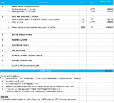

i was quoted for 60K for extending about 10f for 2stry house. is this reasonable?
i dont have details breakdown on the pricing but the contractor said something about new "beam" (not sure if it is correct spell), extending the wiring.
basically from the reno, my kitchen and main bedroom will be move to 10f and the size of the room will be remain the same. 10f from prev spot will be living room for 1st floor.
leocmc

well for your case..about RM24K completed all with simple2 tile (the cost without KC and grill).

TStomjason
post Sep 14 2012, 11:59 AM
866 posts
Joined: Oct 2011
QUOTE(pooi_pooi1 @ Sep 13 2012, 09:51 PM)
Bro tomjason,
Can you recommend a good iron grille supplier? Need to do grille for my house in klang. Thanks
try call Chua 0126271317 for Grill
someone asked about the K screw for grill....below is the pic.
