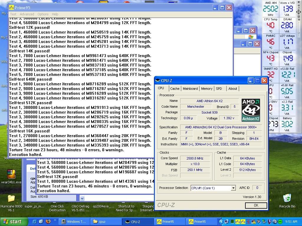

The CPU-Z dispaly the proc as Manchester, but, how do you know it is Toledo? is it CDBOX and BVBOX thingy? I've heard somebody told me the same thing too, which the CPU-Z display the wrong info. By the way, here's mine, donno Manchester or Toledo screen shot @ 2500MHz @ 1.39V, Currently priming at 1.38V. water cooled with homemade water block biggrin.gif Max load @ 43C, at sunny day and non-air conditioned room.

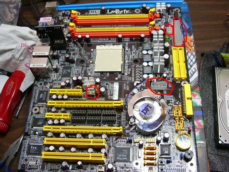

just got my DFI LP UD, and a 7800GT.
i decided to go for UD instead of SLI-D because some one told me UD is confirm modable to SLI-D, and i will mod it one year later, since modding will void warranty!
going to assemble it now, hope can get better result.

The bridge will cost you at least RM50 and last time I checked, it's not easily available locally while a conductive pen from Jalan Pasar will cost you RM100+. At the end of the day, it is not cost effective at all buying an Ultra-D to mod it to SLI-D.Then there's also the risk that the mod will not be successful.
