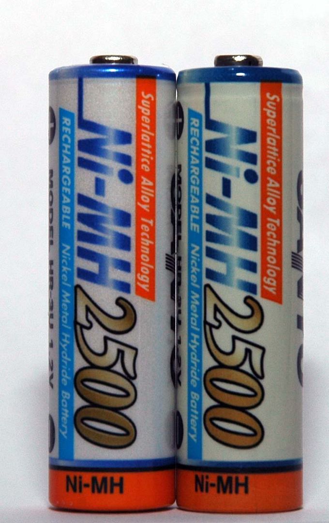

how to identify fake sanyo batteries:

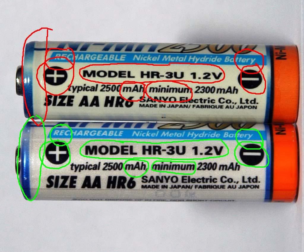

1. Look at the colour of the background. The left hand is original sanyo battery. the right hand side is fake sanyo battery. The fake one will have yellowish on the background instead of pearl white
2. Look carefully at the "MODEL HR-3U 1.2V" font. the left is original sanyo. the right side is fake sanyo battery. The fake one the font is a little bit compressed instead of bold font and the font side is a smaller for the fake battery
3. look carefully for all the font. The left is original sanyo and the right side is fake sanyo battery. if you look carefully,the font used in fake sanyo is different. (+) in original battery will have closer bracket (+) and fake one will have wider bracket ( + )

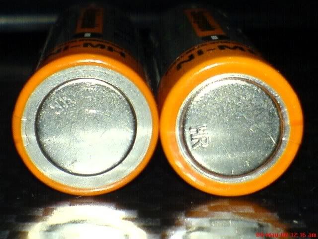

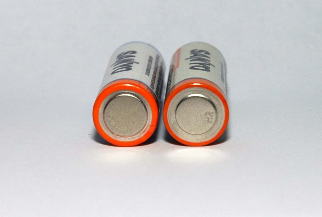

4. don't be fooled by the HR stamp on the bottom of the battery. left side is original sanyo and right side is fake sanyo. the font for HR is different on fake and original. fake one will have bigger font size and original will have smaller font size. and you can see the bottom of the battery,the diameter is different. orignal will have bigger diameter and fake one have smaller diameter
5. another clear pic

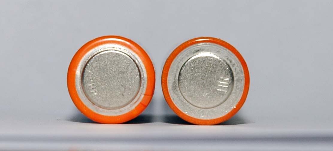

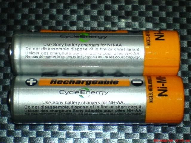

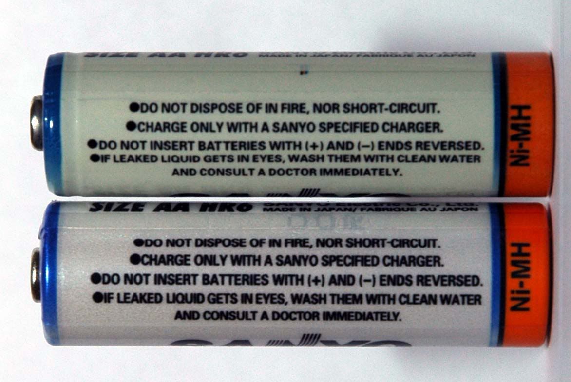

and original sanyo will have emborsed manufactured date. refer picture number 3. you will see a dark cop on it

for picture 2 and 3...left indicates bottom. and right indicates the top 1

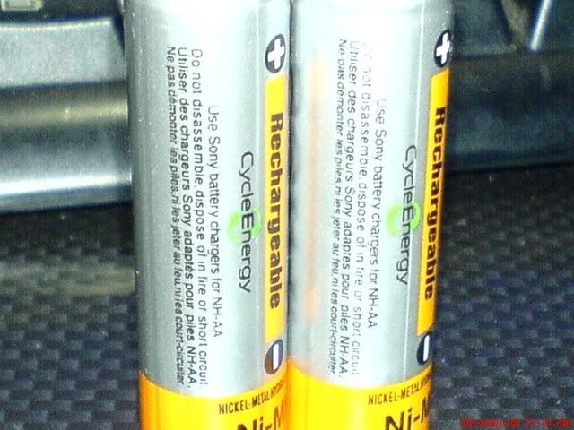

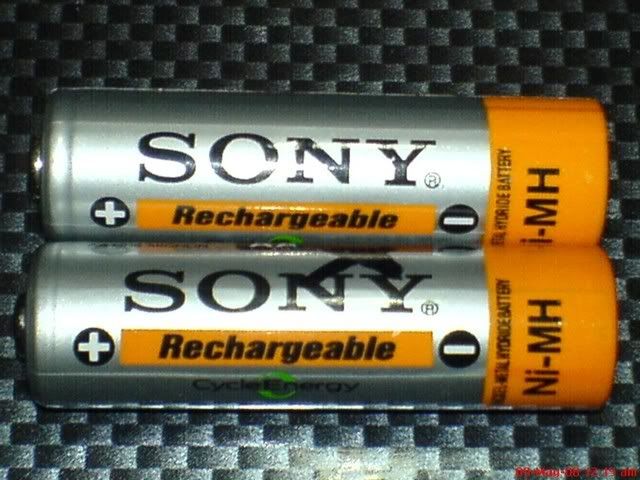

In this picture, the word [minimum] on the fake one look a bit weird, and the word [R] in the [RECHARGEABLE] is on top of the (+) sign, where as the original one is a bit left hand side over the (+) sign. . .
so be careful when buying batteries at this forum. a lot of fakes !!!
and remember...Sanyo Super Charger: NC-MQHO1N-WEX-SS comes with 4xAA 2500mAh battery and not 2xAA 2500mAh
so don't get cheated by anyone who selling you with 2x2500mAh batteries only.

the original will have pearl white background which looks like metalic paint. you can refer pic 1.
and fake 1 will have dull yellowish background
for fake batteries. 2pcs is worth only RM10 or below

saw somebody else posted in lelong that ori battery will have 'HR' stamped on the bottom of the battery... whistling.gif

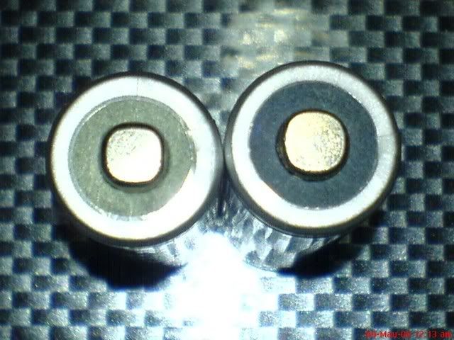

Look at the first picture. The fake Sanyo would have a small groove on the top part of the battery, a part where the diameter is smaller smile.gif

aaaa... i seee.... so the fake one would also hv HR stamped on it... but still.. ori HR font is cuter.... so now i know all my 24 sanyo batt is oreee.... hahahhaha... whistling.gif laugh.gif

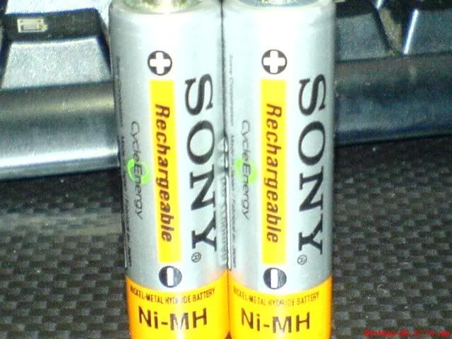

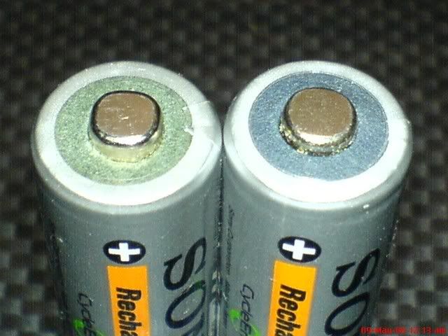

oh well just one word the wordng is bigger only as they scan the battery wording and picture....saem goes to the sony duo pro 1gb
