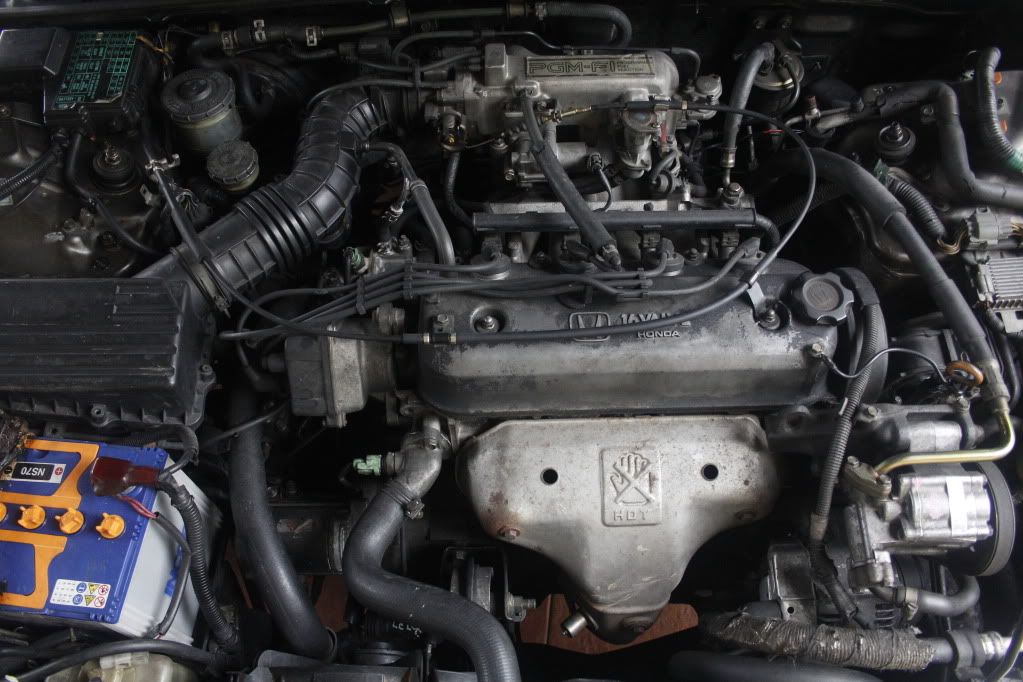

got my sm4(1993) a few weeks ago and the previous owner replaced it with a F20B and how to check wether its DOHC or SOHC?
and are all F20B vtec engine?
paiseh i am new to honda and dont have much knowledge about cars yet

Added on October 27, 2011, 12:15 pmhere's the picture
http://i1115.photobucket.com/albums/k555/J...V1/_MG_2018.jpg

looks like a SOHC
not the F20B from CF4
This post has been edited by driftmeister: Oct 27 2011, 12:37 PM

Looks like a D series?

Not even close to F20B...more like standard PGM-EFi engine to me.
And definitely SOHC.

sadly to say that it is definitely SINGLE OVERHEAD CAM (SOHC)

but isnt it a F20B?
somewhere below the engine says so?

Its an F20B SOHC!
This engine series was used in the CF4, CF5, CF9, CL3 Honda Accord.
150hp/6100rpm
137tq/5000rpm
6400rpm redline
9.5:1 compression ratio
85.0mm bore x 88.0mm stroke

F20B has SOHC n DOHC versions... the one u have is obviously the SOHC version.

it is a F20B. the first version from SM/CB Accords

F20B got many type wor..

ops not the blue top..

i thought the CF4 and cl1 uses f20b dohc. the one with blue top?
and TS, this does not look like a transplant. looks like the basic engine that came with the SM4.
if transplant, most ppl would go for this http://www.mudah.my/F20b+auto+tiptronic-11418502.htm it's cheap!
as i said f20b many variants.. not every one is a blue top..
http://en.wikipedia.org/wiki/Honda_F_engine#F20B
