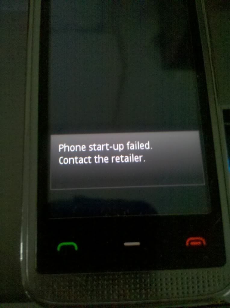

UPDATE
This is what i see some time i turn on the phone...
kae7
post Jan 13 2012, 12:35 PM
10k VIP Club
10,950 posts
Joined: Jan 2009
From: Hatton Cross
QUOTE(boonwuilow @ Jan 13 2012, 12:33 PM)
UPDATE
Startup fail is the firmware problem.. Have u tried the 3 button hard reset????
This post has been edited by kae7: Jan 13 2012, 12:36 PM
TSboonwuilow
post Jan 13 2012, 12:40 PM
Diesel rocks
3,836 posts
Joined: Oct 2009
From: Cheras, Selangor
QUOTE(kae7 @ Jan 13 2012, 12:35 PM)
If not mistaken, last time try already...
what the key combination...i forgot liao ...
kae7
post Jan 13 2012, 01:04 PM
10k VIP Club
10,950 posts
Joined: Jan 2009
From: Hatton Cross
QUOTE(boonwuilow @ Jan 13 2012, 12:40 PM)
With your 5530 turned off,
Press and hold [Green]  + [Red] + [Camera] Keys
Turn phone ON, and keep pressing it until you see the Nokia Shaking Hands Logo.
Dont release any button, just hold it until the screen respond
The green/red button is your call/end call button...
It should be worked, since your phone still can turn on..
And.. Make sure the battery is full or at least, 3bar
TSboonwuilow

kae7
post Jan 13 2012, 04:26 PM
10k VIP Club
10,950 posts
Joined: Jan 2009
From: Hatton Cross
You have flash it , so it cant be hard reset to original firmware....
Might be because of you aren't properly flashed it, thats why the firmware seems incomplete
At least it still can hard reset to the firmware that you flashed into,,,
Need to flash it back to the original firmware, and make sure it is succesful , if it still not successful... Like what you have done in first post, i dont knoe how to help you anymore... Nokia care center is always welcoming you,, lol

hmm...
at NCC u got tell them u flash the phone before?
Going to try the NSU 1st...
just now when i turn on my phone, sometime it will turn on, but some time i turn on just vibrate once, ntg on the screen, press power again, vibrate once again...
i'm not tell them...
but they know it, after they check my phone....
